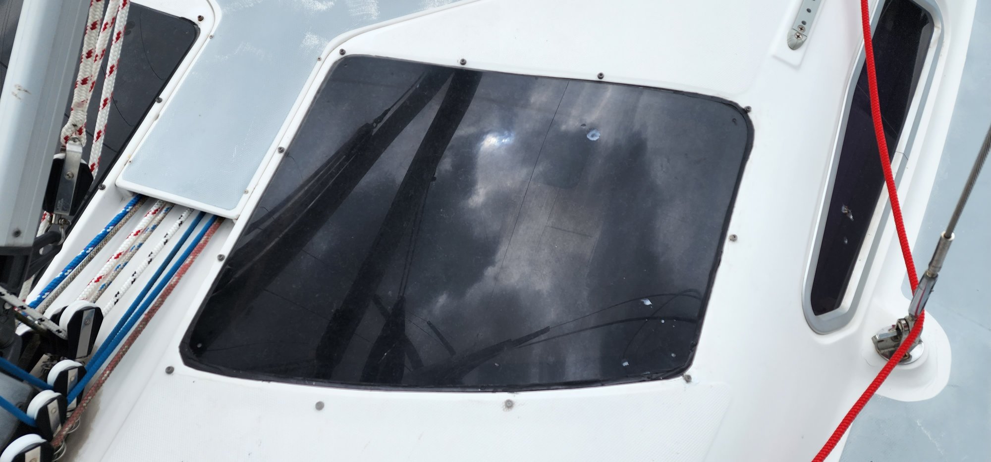

I am chasing a leak in the corner of this deck window. What sealant should I use to rebed this window?
So dar the 3 different ones I have used all failed.

Rebed it with Dow 795, black and use masking tape. Excess sealant will squish out and you want it on the masking tape rather than every adjacent surface.
14,300
Which ones have you used? Maybe your'e doing something wrong. 3M 5200 is the sealant of choice for marine use but you have to apply it correctly
This is bad information. 5200 has limited uses on a boat. It is a polyurethane adhesive with minimal sealing qualities. It is a permanent adhesive for applications that require high bonding strength and modest flexibility. There is a reason it is often referred to as the Devil's Glue. While the 3m literature suggests 5200 is suitable for installing ports, they are referring to more traditional framed ports not the unframed kind the OP has.
Dow 795 and GE Silpruf caulks are much better choices for installing acrylic panels. These caulks are glazing sealants used to secure plate glass windows in high rises. While both are silicone, they are not the same chemistry is the typical marine or household silicon.
Another alternative is to use 3m VHB tape followed by Dow 795 to seal the edges.
In the end however, the cause of this leak and separation is not the sealant, it is inherent in the design of the port. In order to get the acrylic to bend to the boat's curves, it needs to be heat set and baked in an oven to the correct shape. There is some flexibility in the acrylic after it is heat set, however, it the heat setting is off a little, it will put tension on the lens which will pull the lens away from the cabin top. It was an aesthetically pleasing and stylish solution to providing more light to the cabin, but it has limitations.

Dow 795 is the choice of manufacturers. Some boat windows temporarily used screws til the window seated itself and then removed withe holes filled in with Dow 795. The screw holes were larger than the screws to keep the window from cracking. 5200 is not to be used at all in this application

You need to pull the window, and then re-seal with either 795 or Sikaflex.
I wrote a comprehensive article (it’s posted) on how to get the window out very easily.
Don’t just lather more externally. It won’t solve your problem reliably .
