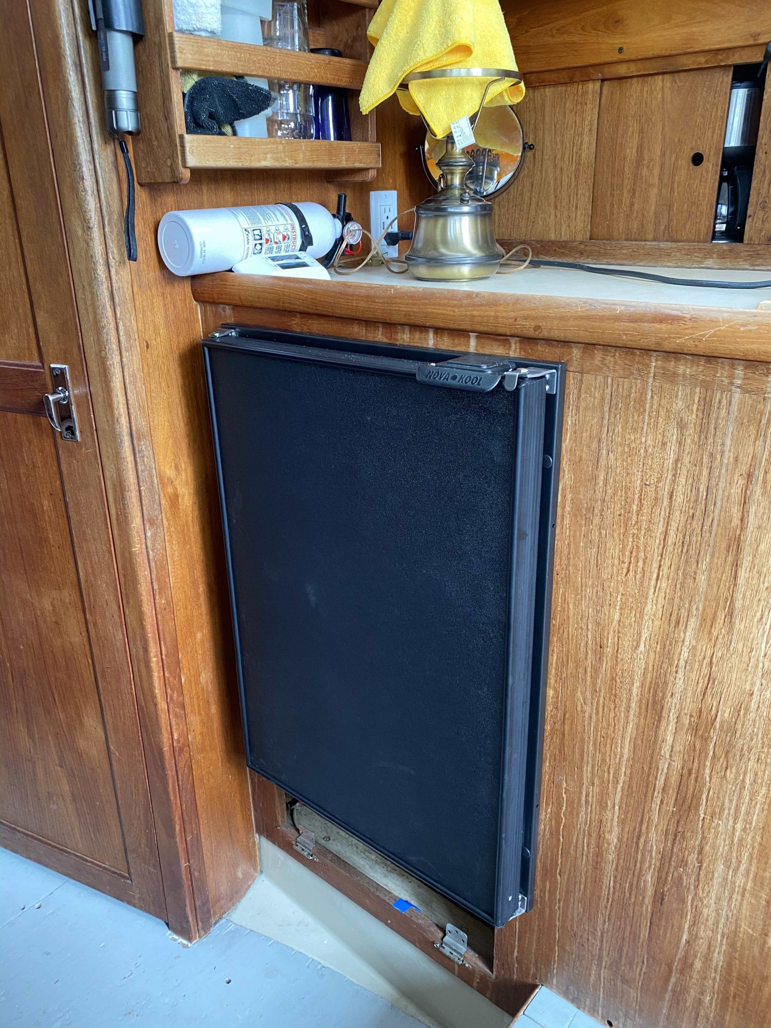

In 86 if there was an installed item like a refrigerator it was likely the dealer not the factory. That said, there is no way of knowing over the past 30 plus years that the same original owner equipment is still on the boat. Your best bet is to do some exploration, Is there a name or label anywhere on the unit. Look at the typical locations for refrigerator labels. (i.e. door panels, freezer, near a reostat used to control temperature. Better yet remove the refrigerator so you can look behind the unit. That is where the action is. That is where you will be looking if the unit stops functioning. There are not too many manufacturers of boat/RV refrigerators. Should be easy to narrow down the usual suspects. Also may discover that the brand is no longer made. So you will be like many of us owners of mature boats. Looking for a good solution to install in a space that does not require to much modification of the boat interior.
Looks almost original OEM like finished install.
