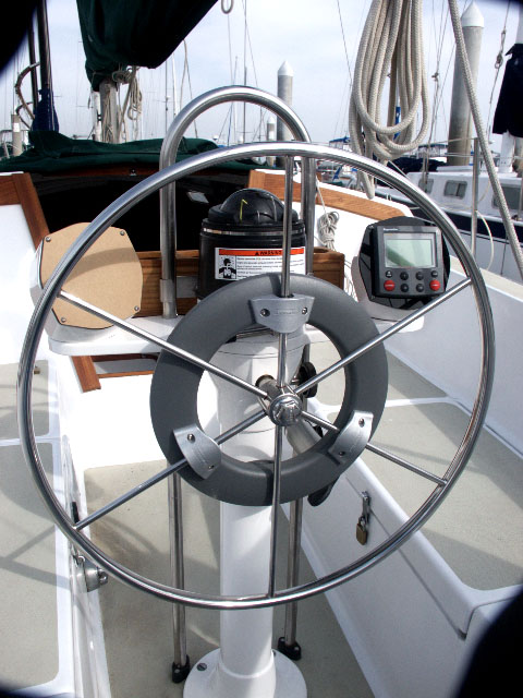

Yes, Philip, that back ring drive unit is the same one I have. I think the Mk II has the bigger spoke saddles and a slightly different engagement lever.. May be gray vs black. I fought with my 4000+ for a couple of years trying to get the response and auto trim and rudder gain to make it work but was unsuccessful. I talked to Raymarine and they said that the rudder sensor would probably help.. I have had it on now for two years and it made a world of difference.
Yes the MKII is gray and does have biggger spoke saddles, I have the ST4000+ MKII, the last line before they upgraded to the SI wheelpilot. The rudder sensor does make a difference and I would not be without it, that is why I bought the older MKII when the new model was just coming out, I got one of the last ST4000+ models in the supply chain and at a discount because it was an older stock model. It would cost me twice what I paid to upgrade to the new models and I believe what I have is superior. I have a light boat though, A MacGregor 26M, about 4000 lbs. I quite like the old ST4000+ MK2 wheel pilot with the rudder sensor. Too bad they no longer make it.

Sorry guys but I am a bit confused now. So, the difference between MKII and the black Raython that I have, is simply the colour (grey) and different spoke saddles? I mean in effect it's the same drive?
Actually I remember some time ago the local Raymarine dealer telling me that if I needed a backup I could simply buy the new wheel drive (just the drive unit I mean) and simply connect it to the existing little plug at the wheel (or connect it anyway and keep the old one as a backup). There's no need to change anything else.
10,254
Philip, I am not an expert on this difference thing but I think that the MK II has upgraded software and the drive unit has some changes in addition to the color. The engagement lever is stronger and has a more positive action. I think the idler/guide wheels inside the housing are more robust. I believe that the motor and planetary gearbox itself is the same..Yes, the new drive unit will work with the old control head.

The MKII is a "significant" upgrade to your old coal driven st4000+. It has a bigger and better motor that uses the same plug by the way so no problems there. It has a hole on the back of it where you can actually stick a hose in it to rinse it out. It also does not use the same belt concept... more gear driven. Going a bit off memory because I put it in about 4 years ago and have forgot about it. It just works.
All in all, probably a very cost effective upgrade that will talk just fine to your st4000+.
