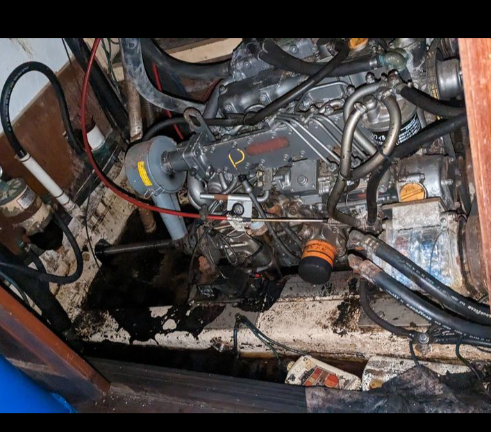

what make engine?
Jan 7, 2011
5,858
Oday 322 East Chicago, IN
4 cylinder Yanmar is my guess, but not sure of the model.
I don’t see a turbo.
Any idea if it is original or has it been repowered?
There should be a badge plate on the engine.

I don’t see a 4 cylinder engine available in the 70’s
Here is a nice list of Yanmar engine history…
I think it must have been repowered at some point…

Thanks you guys. Yes after doing some research it looks to be a yanmar 4jh2e. Its been sitting on the hard for 3 years. The motor ran before it sat. Just trying to look around at what needs to be done to get it running
13,441

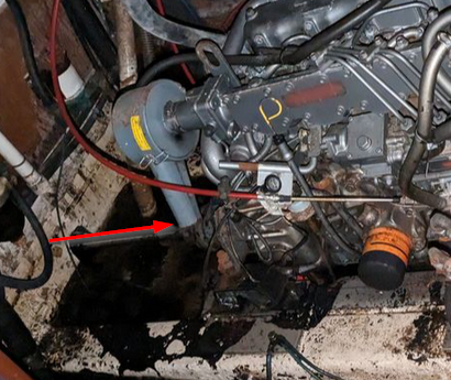

Check the oil and change the fuel filters. Also check the impeller, they can develop a set in the vanes when left for long periods of time. I have a 3JH2e which is the 3 cylinder version of the JH series. It looks like there is an engine driven compressor, make sure the compressor hasn't seized. I might take the belt off of it the first time the engine is started.

Awesome, thank you. Yeah ive read these diesel's can sometimes fire right up after sitting. Are you saying to take the belt off the engine?
13,441
Hey this one has a vacuum attachment! More engines should come with this! :facepalm:;)
One design flaw in this engine is the crankcase ventilation. The hose attaches to the air filter and in theory the oil is sucked into the engine and burned. In reality, it just doesn't suck quite enough so some oil mist come out of the air filter and lubricates the engine room. The engineers almost got it right, it is just an invisible mist that lightly coats everything leaving you to wonder where the oil leak is.
