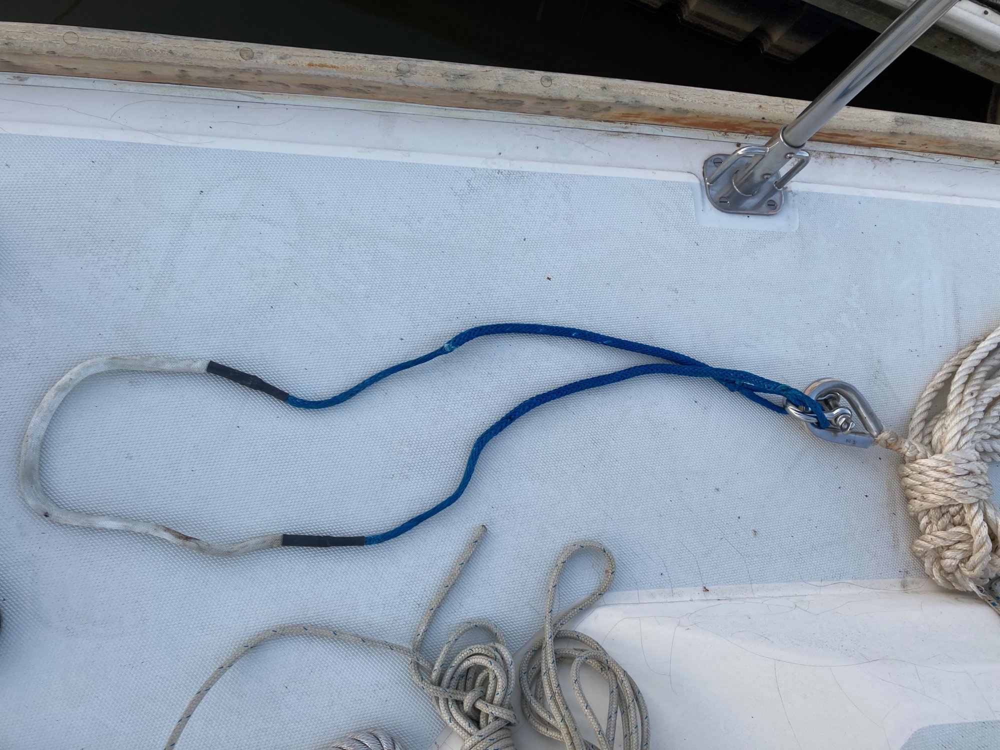

We have 5/16" chain. The snubber is ½" nylon attached to the chain with a copy of the Mantus Snubber Pendant. I used ¼" dyneema for the pendant. The one change I am considering is using some kind of spring shackle or carabiner instead of the D shackle, that will make it slightly easier to use.

I used ¼" with a dyneema cover that is held in place with heat shrink. It is basically a line with 2 eyes. I've only used it on chain not rope. It works well on chain.
The only challenge to a DIY pendant is getting the line lengths correct. It took me two tries to get it right. The first one was too short, longer is better than shorter.
The area with the splice bury is very stiff. If you were to make your own, make it longer so there is more dyneema that does not have a splice bury in it. ¼" Dyneema should be small enough and supple enough to tie a prussik on ⅝" line.
