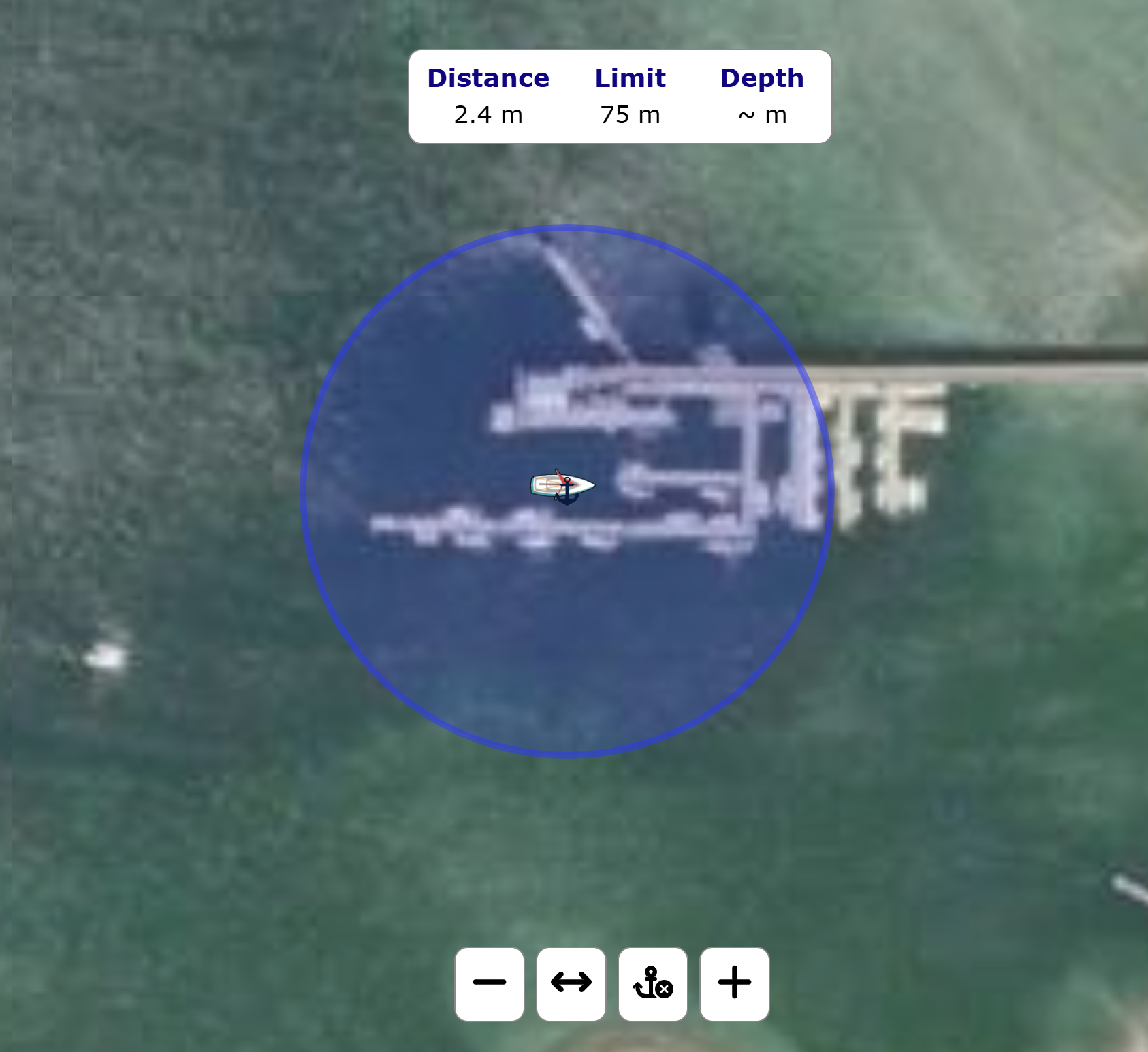

I use the anchor alarm app that comes packaged with SignalK. SignalK runs on the Victron Cerbo, which has a USB GPS puck.... so a super low power method of feeding position and being alerted in case of drift. (I haven't dragged in 20 years ! :) )

Here's an example of the signal-k add-in:
I usually set it from the helm, as Signalk web ui is accessible directly from the Chartplotter(B&G), but you can also reposition the anchor location after the fact.
