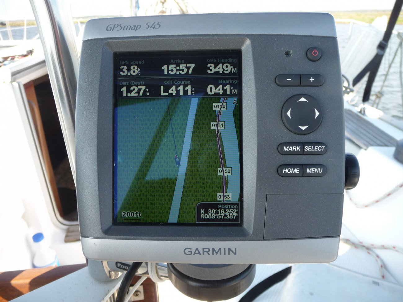

The little dears can have "brain fartz" occasionally as in this trip.. I was certainly in the bayou at the right of the screen and the icon shows me many yards to the left.. you can see from the old track that it had known almost where I was on a previous trip.. These are the times when ya think ya have good info and then, squoosh, ya in the mud !

More than likely the cartography was wrong but the GPS position was right. (Many charts are based on ~100 year-old cartography.)

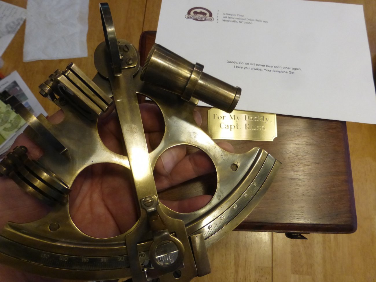

A recent present from my daughter:
Yes... I know this reproduction is not suitable when lost at sea, but I still love it. :)

yes;this is an example where the convenient chart overlay the manufacturer gives you is not worth a can of cold beans. Good news, you have a previous plot of a tracked course. Turn that into a ‘route’ and follow it back with 9ft accuracy. Got to know the technology features. Good reason to use your own gear, not borrowed.

Yes, this has always been the elephant in the room with GPS. Since its introduction, it has always been much more accurate than the charts made before its inception.
Those who travel the AICW know this to be true, as much of their voyaging is overland, according to the GPS. Of course, in the AICW it is pretty easy to see this and make the appropriate adjustments.
When I sailed the Caribbean in the '70s and '80s, there was a notation on the charts that Antigua was mischarted by something like 1.25 miles, if memory serves. That is pretty significant if one is relying on a navigation system that is much more accurate than the charting software, especially if one is making a night landfall.
I imagine much of the charting commonly used by commercial vessels has been updated, but certainly, many of the charts we use on small craft may never be upgraded as we are just too small a market for the investment.
Mastering the old LORAN system required a bit of interpolation and I believe that is still quite true with GPS today. The only foolproof navigation system is your eyes, ears and common sense.
