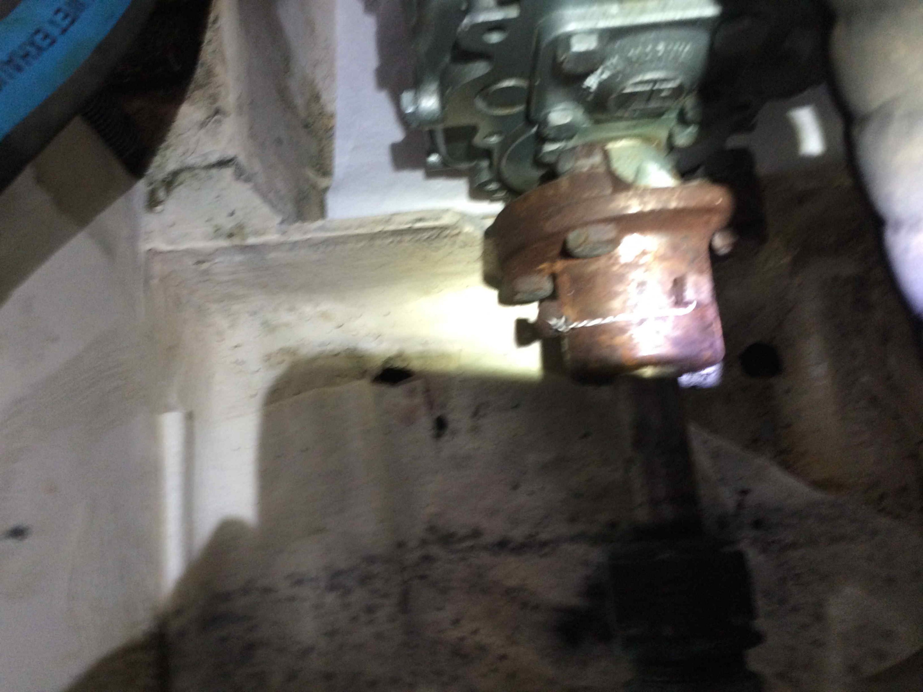

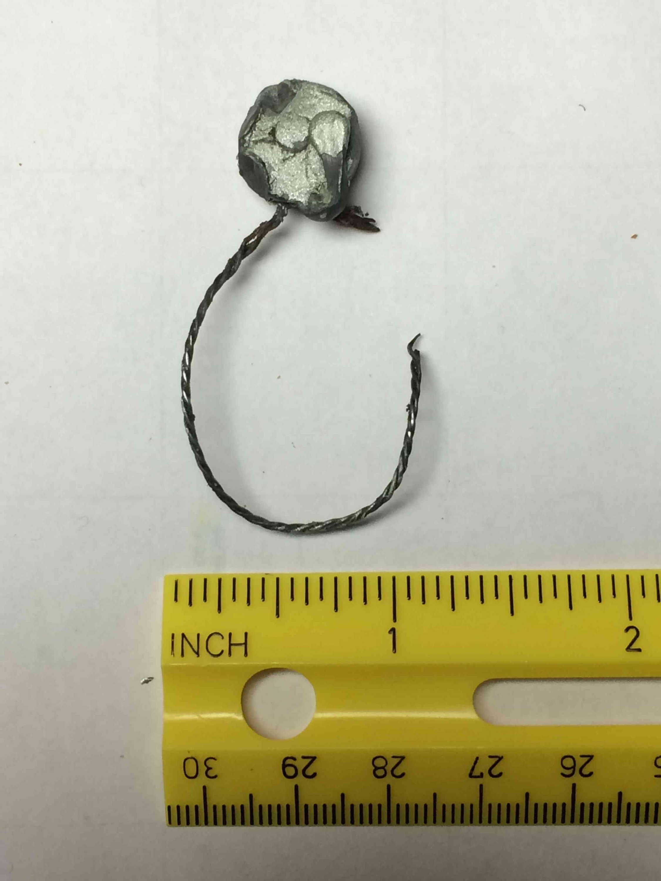

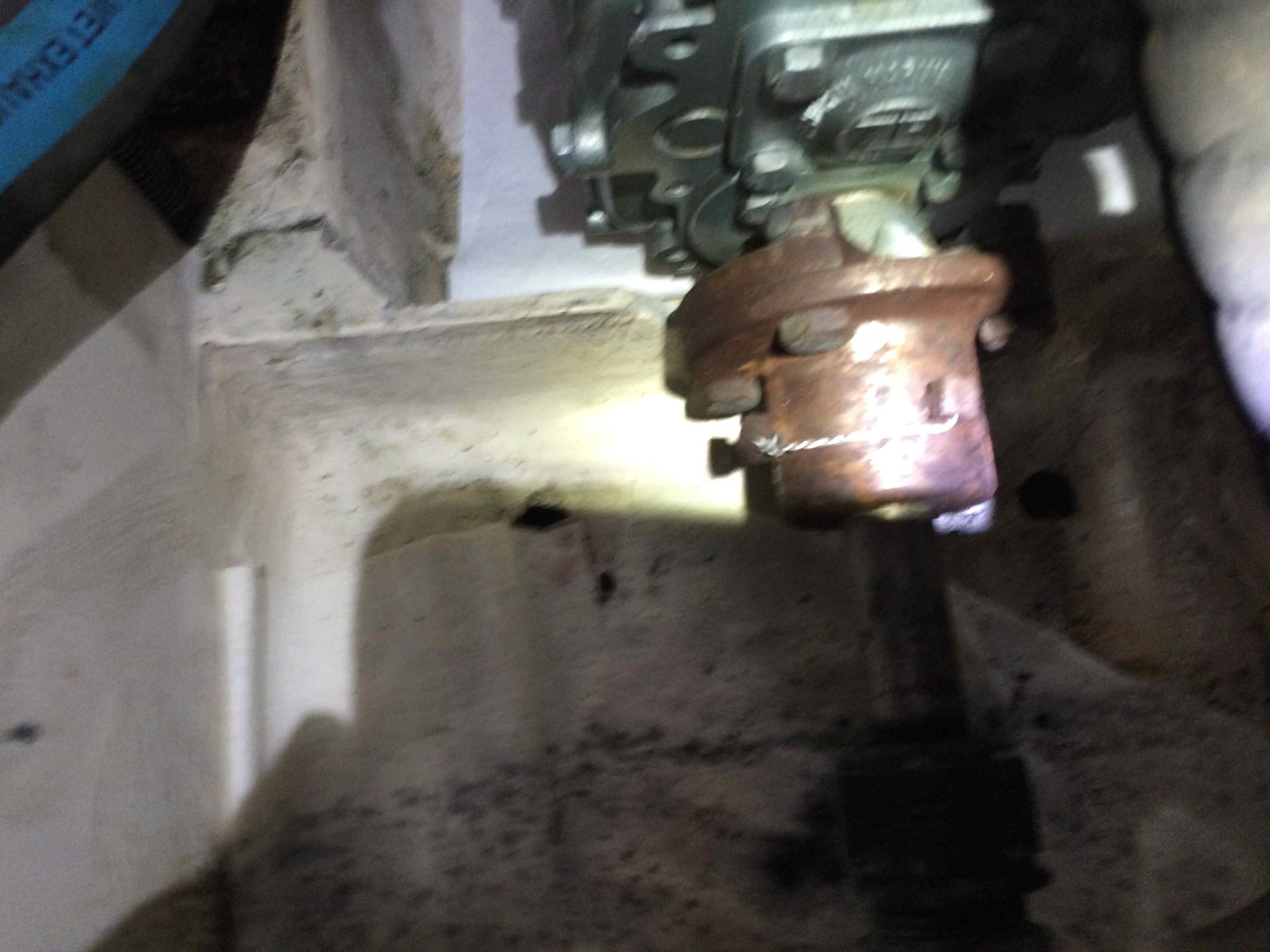

I was doing monthly maintenance today and under the engine, in the vicinity of the engine/transmission join, I found a bit of wire that was crimped in led. The wire is clearly broken and has fallen off of something. Is it the ground between the Universal M25 and Hurth transmission? I've looked about, but cannot determine where it came from. Of course, it is next to impossible to look at the port side of the engine, even with the mechanics mirror I used.
