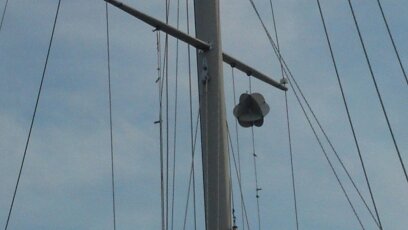

I may get laughed at but I am clueless as to what this is?!!?
I found a home-made version on my boat when I bought it, and saw this one on another in the marina....would like to know what it is used for and put it to use...

It's a radar reflector. Basically make you boat a better target so you are easier to see on ships radar.

I was really scratching my head on that one....but a radar deflector makes perfect sense!

Several years ago, Practical Sailor did a review of those multi-faced radar reflectors, and found that they were much less effective than we had all been lead to believe. I have a vague recollection that PS rated an inexpensive burgee-type flag with metallic threads as a more effective radar reflector than the type pictured.
............... where are these burgees are available, a brand name, anything at all ?
This sounds much better that the ball type arrangements with all its mounting drawbacks.
I also remember the PS article (can't find it now) and was more than a little ticked when I read it. However, can't remember the mention of the burgees.
I don't remember the specifics, and I tossed all of my back issues of PS a couple of years ago; they were so old at that point, I didn't think they were worth keeping. Sorry for the tantalizing tidbit!

I have one of those ball type radar reflectors on my boat right now that I probably used about three times,-- 22 years ago. A burgee with metallic threads would work better for my boat, where I have a flag halyard that goes to the top of my mast and flag staff that could wave it above my mast.
I think I'm going to take that thing off my boat tomorrow and keep my eyes open for a burgee with the metallic threads.

And, in addition, it is actually installed in the correct orientation.
i.e. "catch rain"
(Many are not....)
