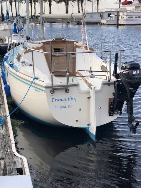

There's a through hull (pic attached) on the port side of my transom above the water line that has a hose on the inside but isn't connected to anything. The manual bilge pump in the cockpit doesn't have any hoses on it, so my guess is that it's the output for the manual bilge pump.
Also, it doesn't appear have a seacock on it, but I'll need to climb down in the cockpit locker later to verify.
Hoping someone else has this on their boat and may provide some insight. Thanks!

Definitely a drain. If you have an electric bilge with float, you could use the same drain by adding a Y-connector and two check valves. The same drain could then be used for either pump.

On my 89 Cat 25, that is indeed the location of the output of the manual bilge pump.
I'd recommend against this. Never do anything to a bilge pump line but run it straight over the side. No tees no checks no valves. Straight runs of smooth hose.

Good evening! I own and sail an '84 Cat 25, and I agree with everyone's saying that the through-hull is indeed a bilge pump. On my boat, the pump is a compression bladder that is pumped manually with an insertable handle. The pump actually was protected by a hard plastic cover, so it took me a few hours to discover it when I initially bought the boat and did a run-through (the owner was not very experienced and had only sailed the boat a handful of times since he bought her in 1984). I'm not sure if he installed that cover himself, or if it came as an option from Catalina. Who knows; the fact of the matter is, these bladder pumps are FAMOUS for developing tiny, millimeter-sized tears that leak water, rendering the compression system useless. You may want to check the condition of your pump bladder, as your boat is just a year older than mine, and I'd hate for you to experience the pain I'm dealing with. Fair winds!
