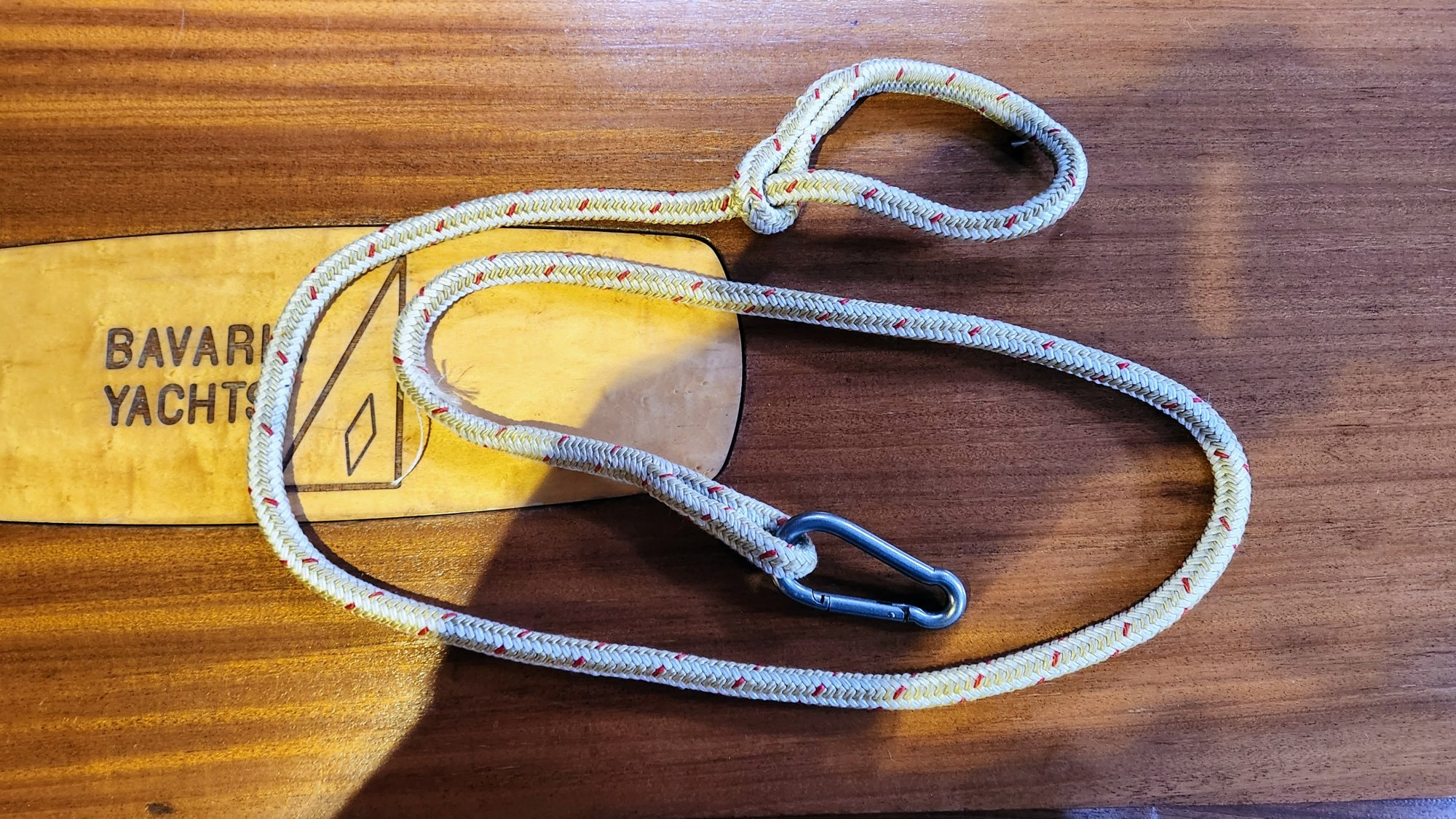

I've had this nicely made mystery line from the previous owner aboard and can't fathom what it's for. 5 foot length. 10 mm - approx 3/8 inch. Any ideas? We're a 35' sloop with roller furling.

It is a really bad idea that was once employed as a tether for a harness. The bad idea was there was no way to easily release the tether from the harness if you were being dragged along side the boat. Also, the carabiner could snag on the pad eye and inadvertently open rendering the tether useless.
Modern tethers have a quick release shackle at the harness end and a double action clip at the pad eye/jack line end.

Not useable for a tether.
  • Non-locking clip.
  • Clip with high snag potential on rope or webbing (that style has teeth in the gate latch).
  • No release at the other end. This can be acceptable for fixed point tethers (binnacle, mast, winch station, or foredeck). Some people prefer work station tethers to jacklines, and there is a case to made for it (sailors don't fall off when moving carefully between stations, they fall off when working on something).
  • Strength and stretch not known.
  • Probably considerably older than it looks.
Dog leash.

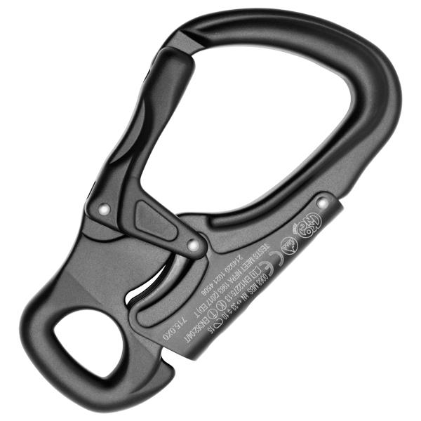

It may have been used as a tether, but it was not safe.
@thinwater illustrates a proper tether clip.

I suspect the line will be strong enough. You need a solid clip to attach it to the dog's harness. The Kong Clip may be over engineered for this purpose. I'd use one of the new-styled body harnesses.
