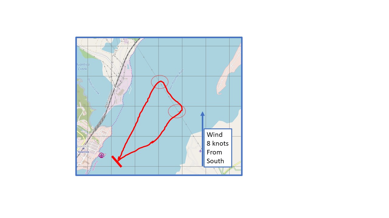

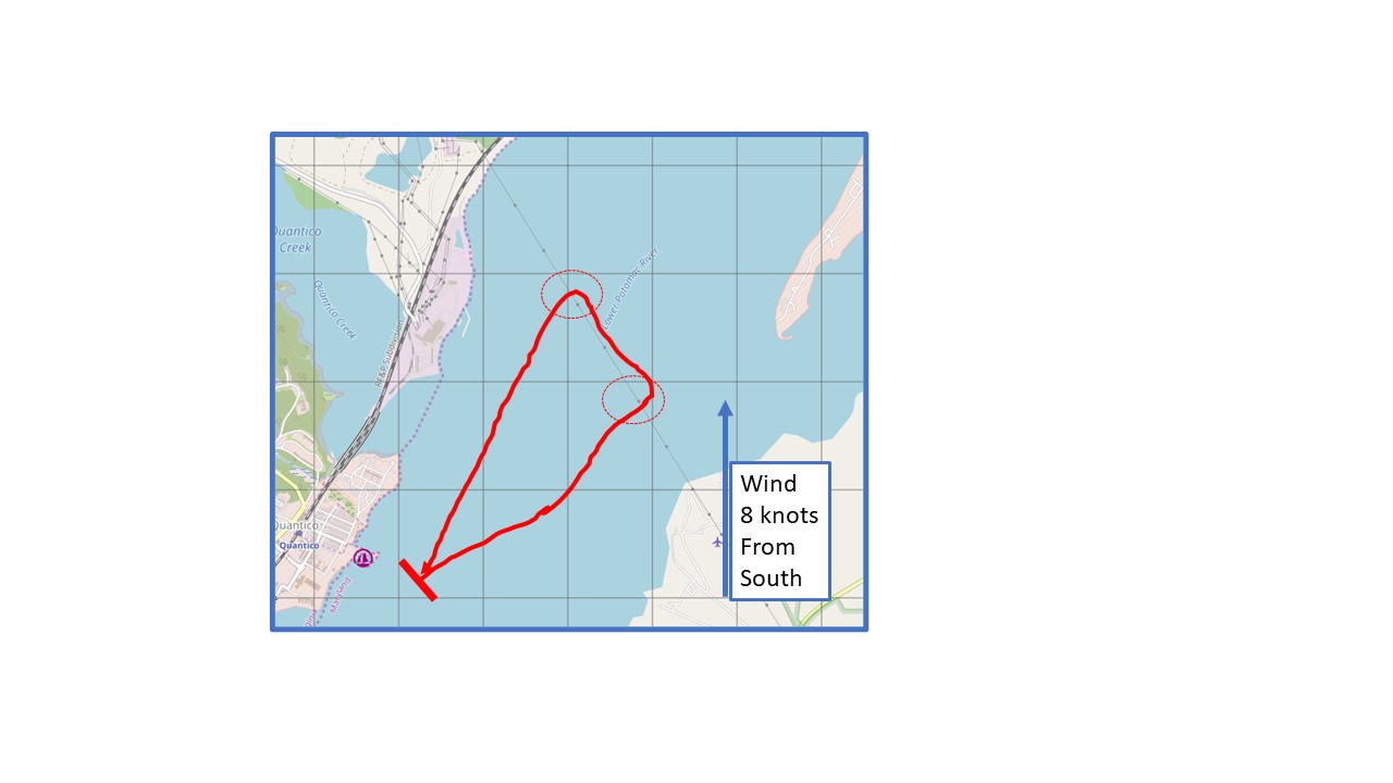

Was in a race recently and received a complaint and thought I would post it here. Other boat felt I needed to move out of their way as I was the windward boat. My response is I gave them room and sailed my proper course and did not inhibit them. Situation was we had a nice wind of 8 knots from the South-SouthEast. The course was a triangle with the start just off the marina to the South with the two other ends of the triangle being power pole B and D which we had to pass to port. I reached power pole B first and rounded it and the other boat came behind and was leeward of me. I sailed a direct course to power pole D and then turned upwind and ran as far as I could before tacking. To me it was fun as the other boat was the faster boat, but every time they tried to pass me they hit my wind shadow, lost speed and fell back. I did not attempt to do anything but sail the most direct course to the next mark. The other boat, not the captain, started complaining that since they were the windward boat I was supposed to give them room. The attached graphic shows our course.
My interpretation of the rules are below with the actual rules below that.
11. I kept clear and sailed my proper course.
12. The other boat at times was clear astern, especially after hitting my wind shadow.
14. We had no contact.
18.2.1 They did give me room and I made a super smart turn around the mark and immediately beat hard up into the wind. The other boat did lost some ground and eventually tacked behind me (the oncoming shore also likely made them nervous).
19. The other boat did give me room so no problem there.
Ray,
Let me see if I understand this for starters:
The course was unusual (to most of us) because it was a downwind start, to B, then reaching to D, and only upwind finally from D to the finish line.
Do I get this right?
If so, then if he was behind you from start to B and also from B to D, then unless he overlapped you at some point, his claim is foolish.
From D to the finish you were going upwind, so both of you were tacking, right? Or maybe just being able to sail on one tack, perhaps?
What I didn't understand was this: "...the other boat was the faster boat, but every time they tried to pass me they hit my wind shadow..."
If they were behind you from start to B, how could THEY be in YOUR wind shadow? The wind was behind you.
If they were behind you from B to D on the reaching leg (which looked like a beam to broad reach depending on boat sped vs. wind speed) then how could THEY be in YOUR wind shadow?
If they were behind you on the tacking (or singler tack) final leg, tough noogies on them. :banghead::)
Please help me out if I misunderstood.
If I didn't, they were full of hogwash, simply because they physically couldn't be in a position to do so.

OK, Let me help out as I did not explain everything. I am a 31' boat, the other is a 36' boat and slightly faster boat for boat. I beat then to the mark by about 50 yards and settled on beam reach directly for the next mark about 200 yards away. We were both on a beam reach at that point. I could not go any further up to port as there were big power poles (actually big square concrete structures with power poles on top) to my port. I actually cleared them both with about 25' to my port. The leeward bigger boat did catch me, but every time they tried to pass me they hit my wind shadow and dropped back. The skippers daughter (31f) yelled I needed to maneuver to let them through and I stated I would hold my course and not come up or down. I had no intention of leaving any of my fiberglass and gelcoat on a 50'x50' concrete structure. There was no protest, just some complaining that I did not move out of their way so they could pass. I feel good about my position and the other skipper seems OK with it. I just want to make sure I can understand it and explain it (this is a great article for our YC newsletter). I would also note the following, with the last sentence. When they attempted to pass me to leeward I held my course as they were to my starboard and the big power poles were to my port.

Hey Stu, They are a bit faster than me on a beam reach, but upwind I have a bit of an advantage since after we cleared the 3 power pole and headed upwind I actually increased the distance and held it for far longer (they tacked as they were heading a little more directly to the power plant piers than I was ;-) ) You are correct it was a downwind start, but at the beginning we had 4 knots that guickly built to 8-12 knots by the time we got to the power poles. At points B through D we were both on a beam reach and they were a bit faster until they hit my wind shadow.
As always this is a learning curve for folks. The daughter is super sweet (in a perfect world I would have a son her age I could marry her off to) but definitely does not understand all of the nuances of racing. In a race last year they went up to Alexandria (where they are super serious about racing) and got caught out of position away from the start line and complained that boats (in their pre-race sequence) did not motor out of their way.

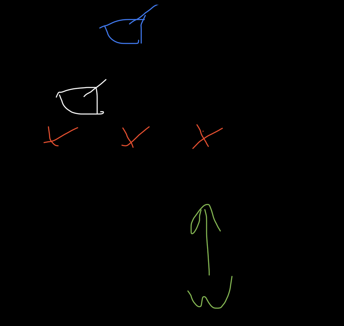

So to confirm, do we have a situation that looks like thiswith you as the white boat and Leeward as blue?
If so the power poles in red introduce another rule, 19.2(b) -When boats are overlapped, the outside boat shall give the inside boat room between her and the obstruction, unless she has been unable to do so from the time the overlap began.
So, Leeward overtaking from astern is entitled to sail as high as she wants and you must give room, with the following caveats:
1) Leeward cannot ask for room to sail above her proper course
2) Leeward must not sail so high that she runs you into the obstruction (power poles).

Davidasailor26, Correct on both. I was boxed in by both power poles and the other boat. I would not the blue boat (leeward boat) was at times 5-6' off of my beam.

@Davidasailor26 GREAT DIAGRAM!
I read this as the other boat simply couldn't push up the OP, they just put themselves in poor position. Stop reading the rules when the appropriate rule meets the situation:
10: Port/Stbd: n/a
11: Same Tack/Overlapped: at times. Windward boat kept clear? YEP.
12: Same Tack/Not Overlapped: at times. Astern keep clear? YEP
so it is DONE THERE....any protest would end there. furthermore for fun, since we might assume the other boat would state they were forced to alter course in accordance to rule 14......
13: While Tacking: n/a
14: No matter right of way, avoid a collision. worth always repeating, but n/a
15: Acquiring right of way: she shal initially give the other boat room to keep clear. YEP
16: Changing course: 16.1 room to keep clear, 16.2 turning down on a beat N/a to both.
17!!!!: if a boat clear astern becomes overlapped within 2-3 of her hull lengths (the 36ft vessel in this case) to leeward of a boat on same tack, she shall not sail above her proper course while they remain on the same tack and overlapped within that distance, unless in doing so she promptly sails astern of the other boat. This rule does not apply if the overlap begins while the windward boat is required by rule 13 to keep clear.
so a boat overtaking can't come from behind, then push up the other boat. The leeward boat can bail out of the position, passing astern when tacking. The N/A for rule 13 is while tacking...so should the OP have tacked while overlapped to a windward position, 17 does not apply.

I was with you until that point, but there’s a subtlety there. The leeward boat can come from behind and push up the other boat, but only as high as leeward’s proper course. That proper course could be higher than windward had been sailing and potentially higher than a straight line to the mark in some cases.
But here leeward has the additional restriction that she can’t run windward into the obstruction, even if her proper course would be that high.
