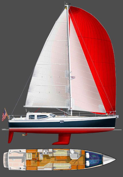

Now my buddy Bob Perry would be sad if I didn't give a shout-out to a production boat he signed to be shipped anywhere in the world via a container. This means less than forty feet LOA, and less than 8 feet of beam.
Bob does his magic, and ta-da, the Far Harbor 39. 39LOA x 8 foot beam. Ocean ready boat. Trailerable too, without permits. At 14k lbs big pickups can pull it.
http://www.containeryachts.com/

On the other hand, limiting the beam to 8.5 once you get to say 26 feet of LOA starts to effect the design in negative ways, and for sure effects the potential volume inside the boat. For a 34 footer, my money says the designer made the right choice with that beam.
That beam width cuts both ways. That's why we think our 8 feet, at 27 feet LOA, is the “sweet spot” Street legal without a permit in all 50 states. And fits in a shipping container.

I hear what you are saying about length. Pick what works. But what you cannot get around is LWL = boatspeed. Something like that Far Harbor 39s average boatspeed while passagemaking will be 50% higher than a 27 footer, that saves days on passages and is much safer.
I agree faster (Far LWL 38 - Calculated speed 8.26 Knots, Nor'Sea LWL 25 - Calculated speed 6.70 Knots).
I do not agree safer. :)

Greg,
Your boat is a tough critter for sure, no Question. When I say safer I don't mean in all ways, but safer for two reason that I mentioned, that are a direct function of length.
Stability - A measure of a boat resistance to capsize. By far the largest factor is LENGTH. The Stability Index will be much higher/better.
Speed. That 39 will spend most of the time at 7 knots. Your 27 at 4. That is a HUGE difference. During a 48 hour span on a passage, the bigger boat will be over 140 miles farther along, and that equals the ability to get away from weather.
Of course none of that matters if you're coastal cruising, and most of these boats will be!

Greg,
Clay
I sure agree that "none of that matters if you're coastal cruising, and most of these boats will be!"
I always thought the resistance to capsize was tied more to keel weight/depth in relation to beam and sail area carried.
When I go to the US Sailing site (http://www.sailingcourse.com/keelboat/cal__capsize.htm) I see that the Far is 1.26 and 1.56 for the Nor'Sea - UNLOADED. So they both look good.
I also see a LOT of talk very often about outrunning weather. In close to shore this is a subject that should be considered. But once "out there" it's more of deal with what ya got, and PLANNING is more important. From my old days in the sky, often we could not outrun the storm in an aircraft. ;) So talking about outrunning it in ANY sailing craft is sort of just talk. At least in my mind. Jill and I have been caught in a couple of storms :eek:, but it was more my planning than anything to do with speed.
