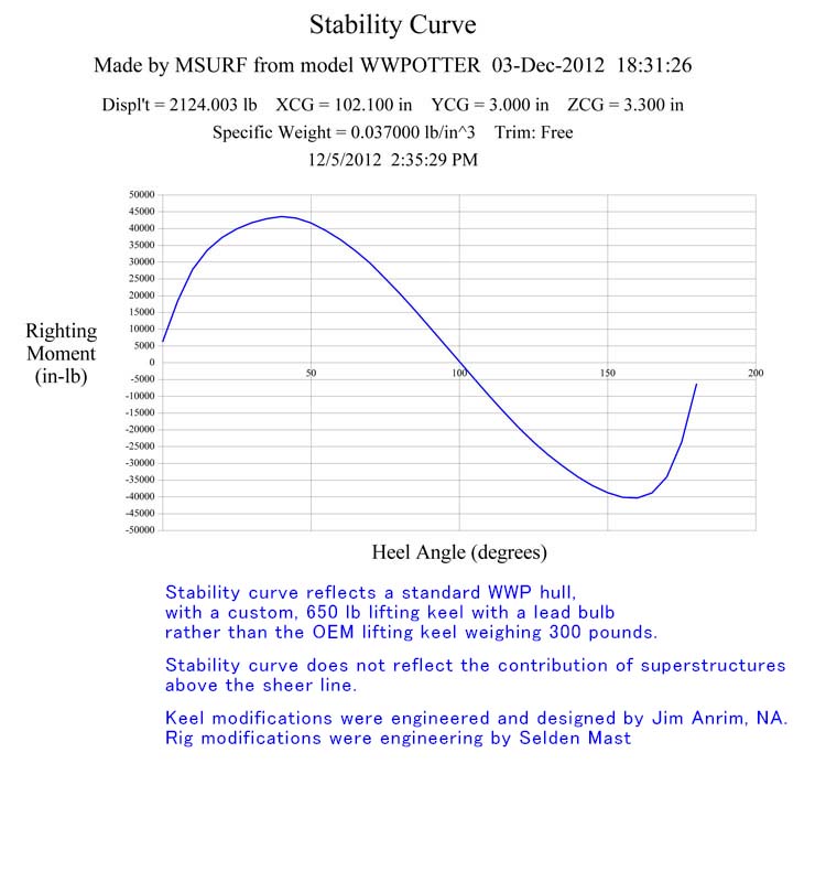

The capsize screening formula ignores a bunch of important boat characteristics, and furthermore more it doesn’t work worth a damn on small boats (with short LOAs) which are very beamy compared to their displacement. For small boats, it’s almost meaningless. You really need to look at the stability curve.
For example I have a custom built 19 footer with a Potter 19 hull, but with a custom rig and a retractable bulb keel. The capsize screening number is around 2.5, but the AVS is 103 degrees.
And the area under the curve when capsized mathematically represents the amount of work needed to right the boat. We did the modeling using a flat deck without any superstructure. In reality, the super structure contributes to righting, but we didn’t include it in the modeling software.
