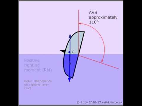

There is also a difference in types of stability. Ballast vs form. For example, take the image posted above. The hull form is sort of like a log cut in half down its length. For a shape like that, with no additional ballast, upside-down would be its natural stable position. A plank floats on the face, never on the edge and if you round one face, it will always turn over until the flat face is down. Boats are designed just the opposite. More recent designs with flatter bottoms and wider beams are better. But, stick a keel on that form and the whole thing can change. Take that same flat board and put a keel on it. If the keel is on a flat face, it will be very stable, but still stable upside down, as well. Put the keel on the edge, it will only ever settle keel down. A skinny boat rolls less because there is less outboard flotation to be lifted by a wave. It will stand upright no matter how the water is tilting, a Weeble. A wide boat, on the other hand, tilts with the water. A wave rolls by and picks up first one side, then the other. Form stability tends to roll where ballast stability stays upright.

Second, you misunderstood my comments re a full capsize. What I said was simply outlining how the righting-arm (GZ) curve on boats work. Repeating, at a certain angle of heel (90-130) the boat will tend to want to capsize as the arm is 'inverted'. Once upside down in the water, the boat's form stability will want it to stay that way, unless rocked by a (much smaller) wave. In storms this almost always happens. Some boats, like Class 40s, have so much form stability that they don't want to turn over, and they have by class rule a way out via the transom.
Here is a typical GZ curve. You can see where the example boat wants to go over( 130) and that means will need to heel to 50 degrees while inverted to go back.
This is true for all sailboats, but they still describe them as self-righting. The only TRUE self-righting boats are usually CG rescue boats with superstructures designed to push the boat back past its AVS in flat water.

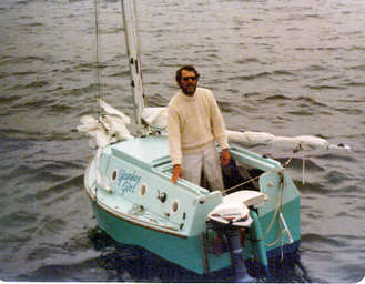

There is a fair amount of truth in that. The big downside is the short LOA makes them much more susceptible to full capsize in a breaking wave. In his 1979 Atlantic crossing in his 10 foot Yankee Girl, rolling in a breaking wave was one of Gerry Spiess's biggest fears.
Not fully around, but he did cross both the Atlantic AND Pacific in that boat.
