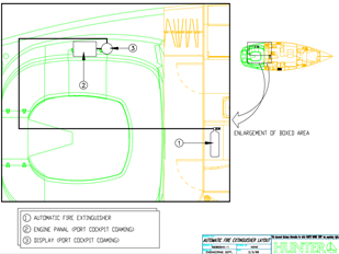

One added note regarding our particular boat, it's equipped with two 5# bottles and one 2.5# bottle. We also have the factory halon system in the engine compartment, and do keep it certified every X number of seasons. This system comes with a warning light to show if it has discharged, so you would know not to open the engine hatch and introduce fresh air.
