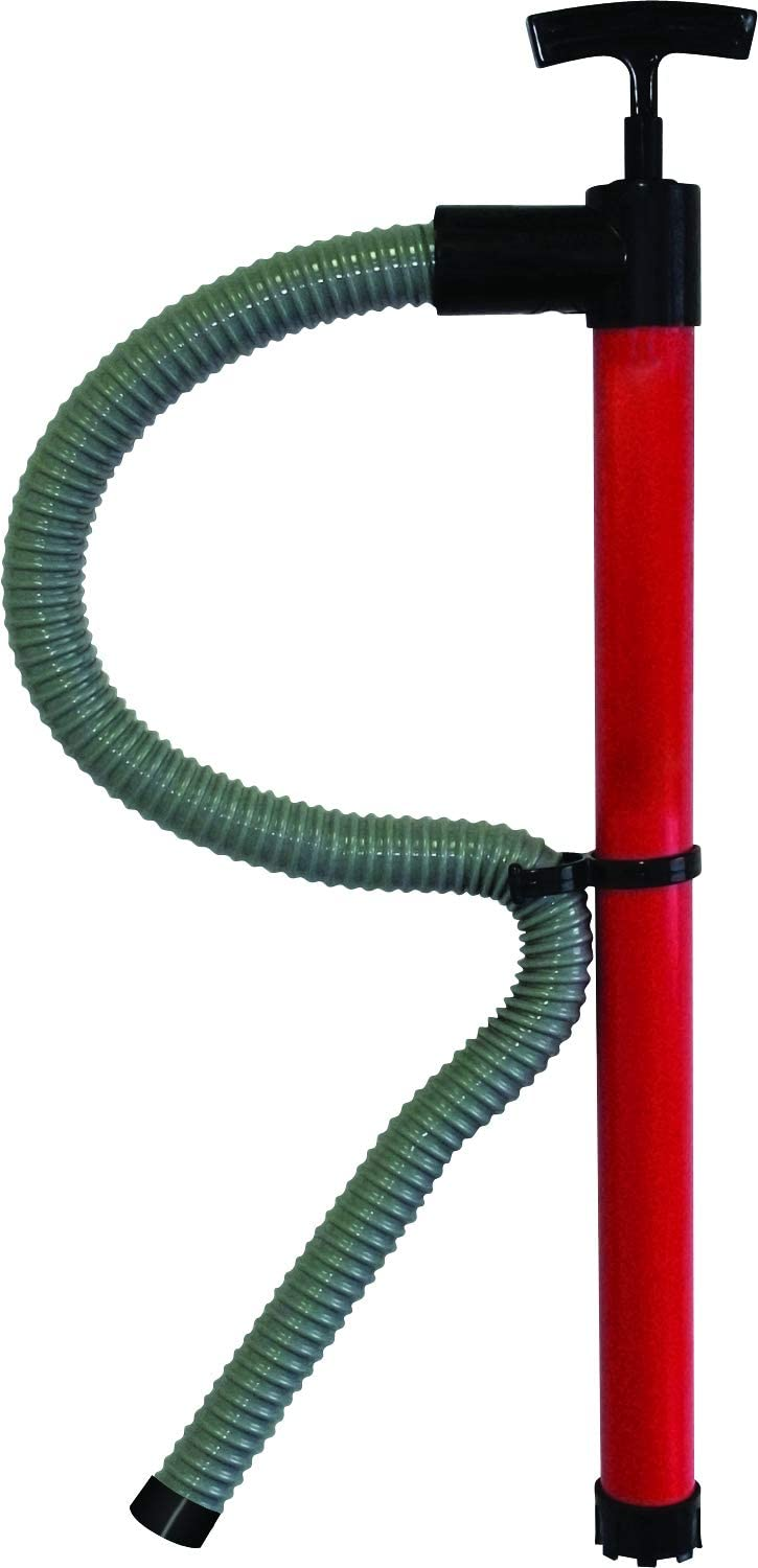

If you have an inspection port this might work. I've used a shop vac that was on it's last legs for urine but this might be better for your application. The guzzler 500 series hand pumps can be used for molasses according to their website so I'm guessing those may also be upto the task. Still, the one in the pic below is relatively inexpensive so it's not the end of the world if it doesnt work out.
My yard has a couple of contraptions for dealing with heads. One is a professionally build one that's built into a trailer and the other they made with a pump and 55 gallon drum. The marinas around here also work with a company called HoneyJug that pumps out boats for a fee
That's a good idea and in line with what others have recommended. One question: what do you do with the waste you are pumping out? I suppose there must be an easy answer as folks are using those mobile toilets. I think for now I am just going to suck it up and spend a couple days to get out to a place where I can discharge with my macerator. I don't really want to even run the risk of spilling c**p all over my precious, new-to-me boat again. Who knows, the trip will probably even end up being fun!
Pump it into a 5 gallon bucket and either get rid of it at a pump out station, portapotty or if you're really careful, a toilet. Im guessing any portapotty company can also help you out for a small fee
