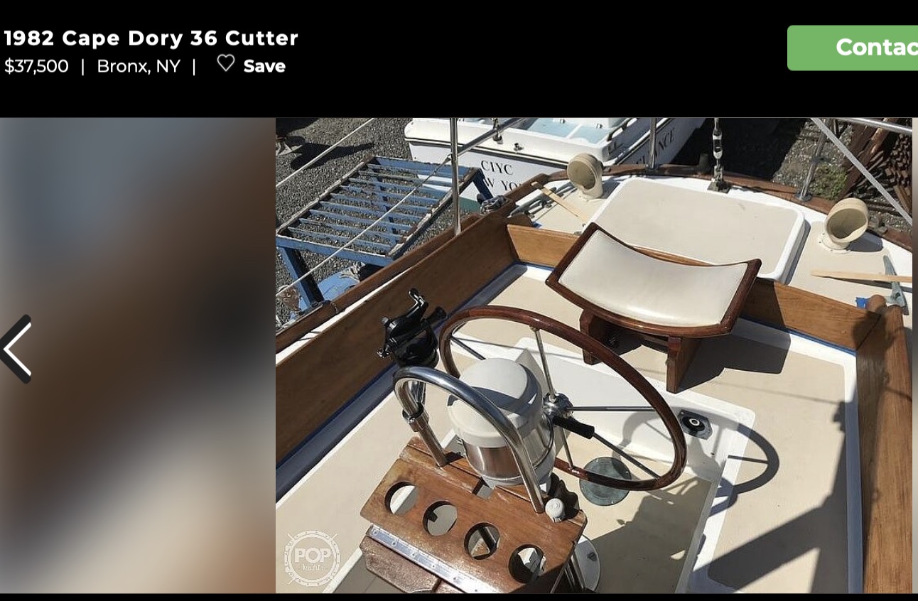

Just look at this 1982 Cape Dory for sale.
The cockpit in color not black and white....
No teak maintenance here... LOL
