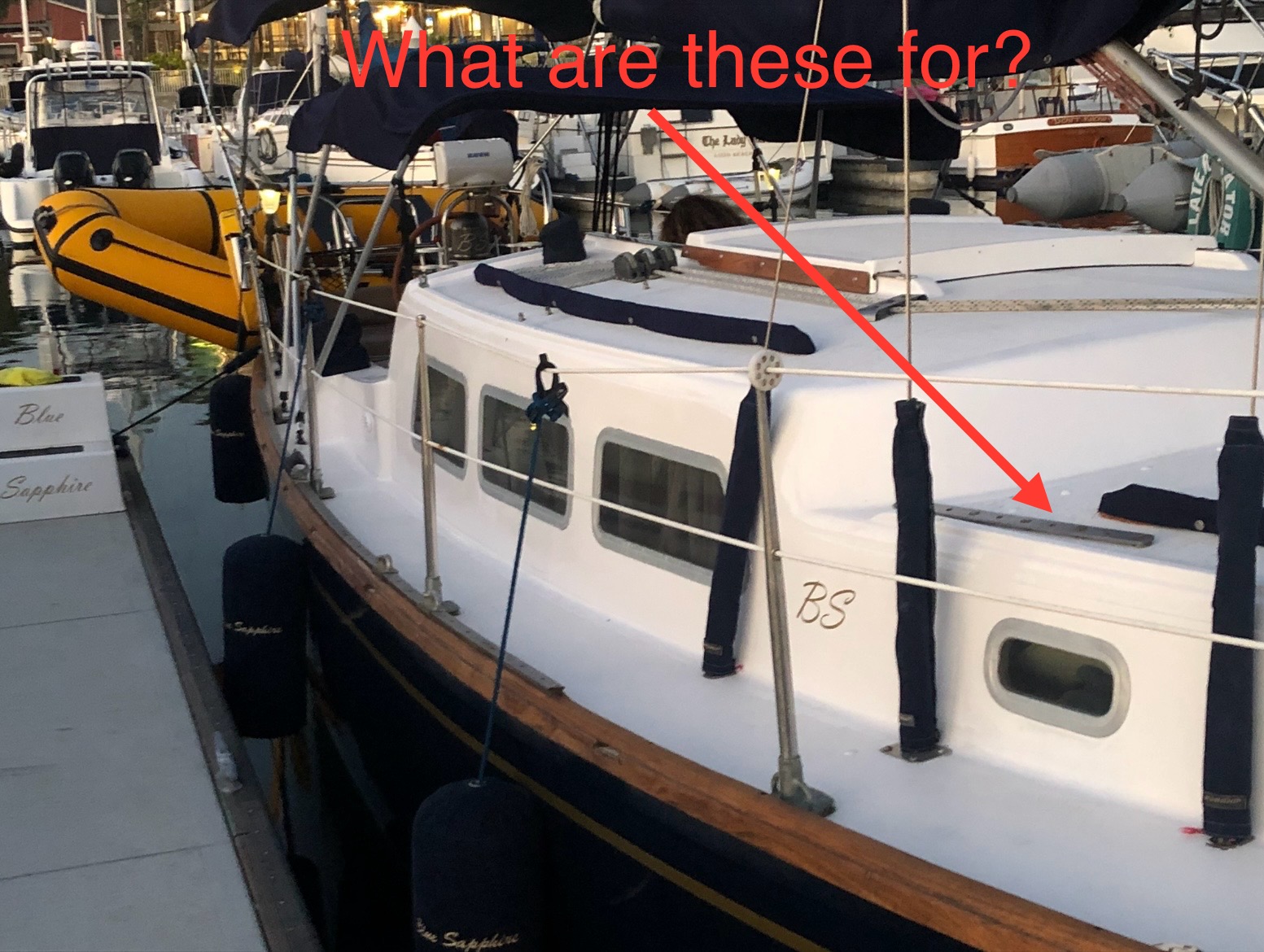

What are these tracks used for?

On my boat there is a little "car' with a block that slides along the track in order to tune the angle of the jib sheets. The car has a pin that allows you to choose the appropriate location for trimming the jib.

Jib tracks for a very small headsail, such as a 90% jib or a storm jib. They would be rarely used.

They appear, from the tight photo angle, to be in a very bad location for a headsail sheet. Where would the tail run to? Is it meant to chafe against the cabin top, are not the shrouds in the way for any tack off the wind?
I don't know why a track would be desirable, but perhapse it is for a preventer or a barber hauler or a twing.

Tracks for a smaller jib that you don't have. If the sheet leads through the a block on the rail-mounted track first it would not chafe. Also possibly a blade jib. The location inside the shrouds would allow for a tight sheeting angle.

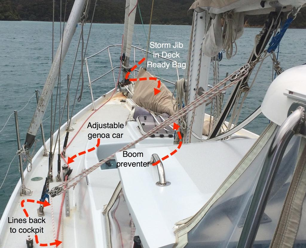

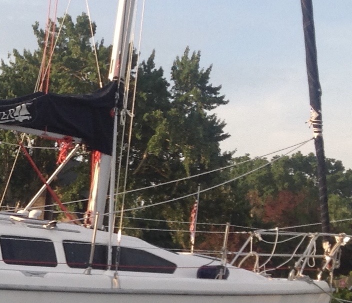

They are for the “pulley car” for the jib sheets. This is the best photo I had of those tracks on my boat. I had to crop it a bit to highlight the track for you to see.
The car has a spring loaded pin that allows you to move it along the track for the best fit for your use.

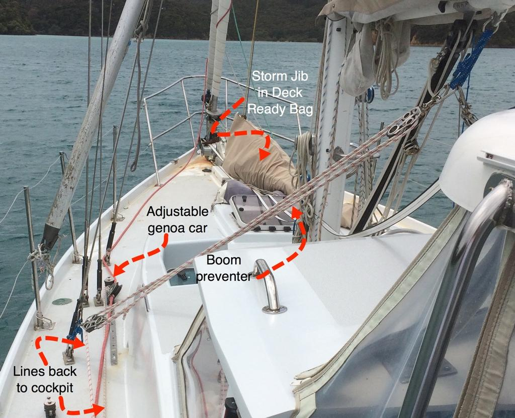

Is the "adjustable genoa car" not a pulley car?
