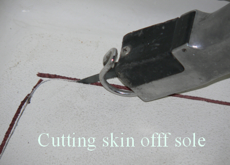

Normally the deck are cut out with a skill saw in large pieces. Only cut deep enough to cut through the fiberglass. If you do this in an area where the fiberglass is smooth, it is much easier to repair.

I had to remove the deck under my mast, as well as my pulpit and my chainplates. I drilled and suctioned and used acetone and heat lamps, in addition to the hot georgia sun. I could not get the deck to dry. Furthermore, all the holes i drilled made the out layer of fiberglass "skin" unusable for repair. The problem is two fold with the hole drilling to dry the core method.
1. It doesn't work very well.
2. It is not easy to get a good cosmetic result with all those little holes. If you haven't used epoxy to fill holes then you may not know, but the stuff is not like drywall putty or wood filler at all, it is very STICKY, and when you try to fill those wholes you cannot get a neat littlle patch, it smears eveywhere. so you have to fill the holes on the final pass with very thick epoxy higher that the hole, and then when it dries sand the area down. If it is on non-skid you end up with a smooth area which you have to match or ignore, then you gotta paint, or use gelcoat, and alot of other stuff. And all that work for a half-a...d repair.
It ended up being way easier to cut out the skin, and repair the core using appropriate technique.

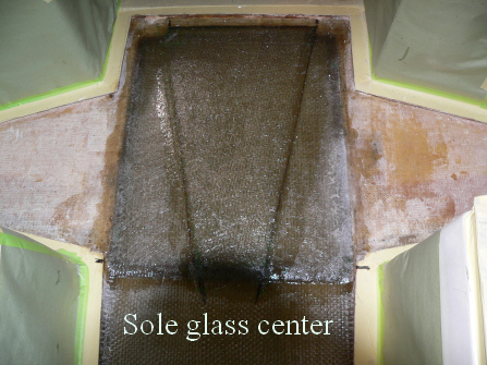

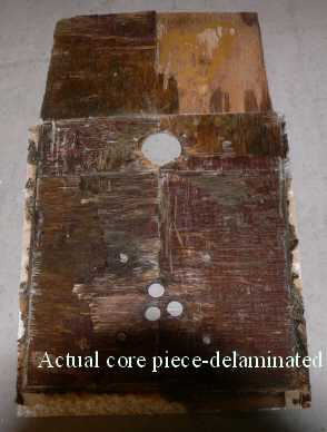

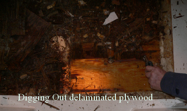

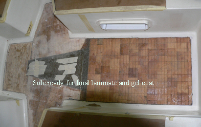

Here is the progress on my cockpit core replace. Final layers of glass and gelcoat this week. Core is now plywood, balsa, and solid glass in penetration areas. Glass in center is 1" thick. My steering pedestal won't being going anywhere soon. Interestingly, it is a Cinkel unit, and the chain drive is double the size of a comparable Edson unit.
I doubt that the plywood core would have ever dried out. The balsa was only slightly wet in spots. The underlying layers of glass and the deck skin were actually sufficient to support the pedestal and flex slightly. Surprisingly there were no gelcoat cracks. Thankfully, I had a good surveyor.
