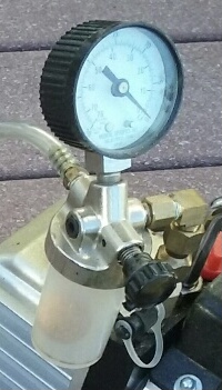

How did you keep epoxy from getting sucked into the pump?

The suction tube was always ran through a water seperator so any epoxy what was sucked that far would end up in the jar and not in the pump. In actual practice, I began as far away from the pump and I could and worked back toward it with several ports and at the end, when I saw epoxy in the suction tube I stopped sucking.

It is possible that a high-vac pump could help to find the leak. The pump is quiet and tiny leaks whistle.

Actually, if the balsa is mostly mush it would make it easier to pull the water vapor out. The risk would be if the core was so soft that the vacuum pulled the two faces together and cracked the skin. If the skin starts getting depressions, you would need to have some supports spaced out to keep the skins flat. That could be done by drilling holes in a grid pattern of 6"-12" depending on skin thickness and injecting thickened epoxy into the hole to make small columns of epoxy to hold the gap. After it is dry the resulting void would be filled with the infusion epoxy which would make it heavier than a foam fill but if the area is small it would not have a significant affect on the weight of the boat.
