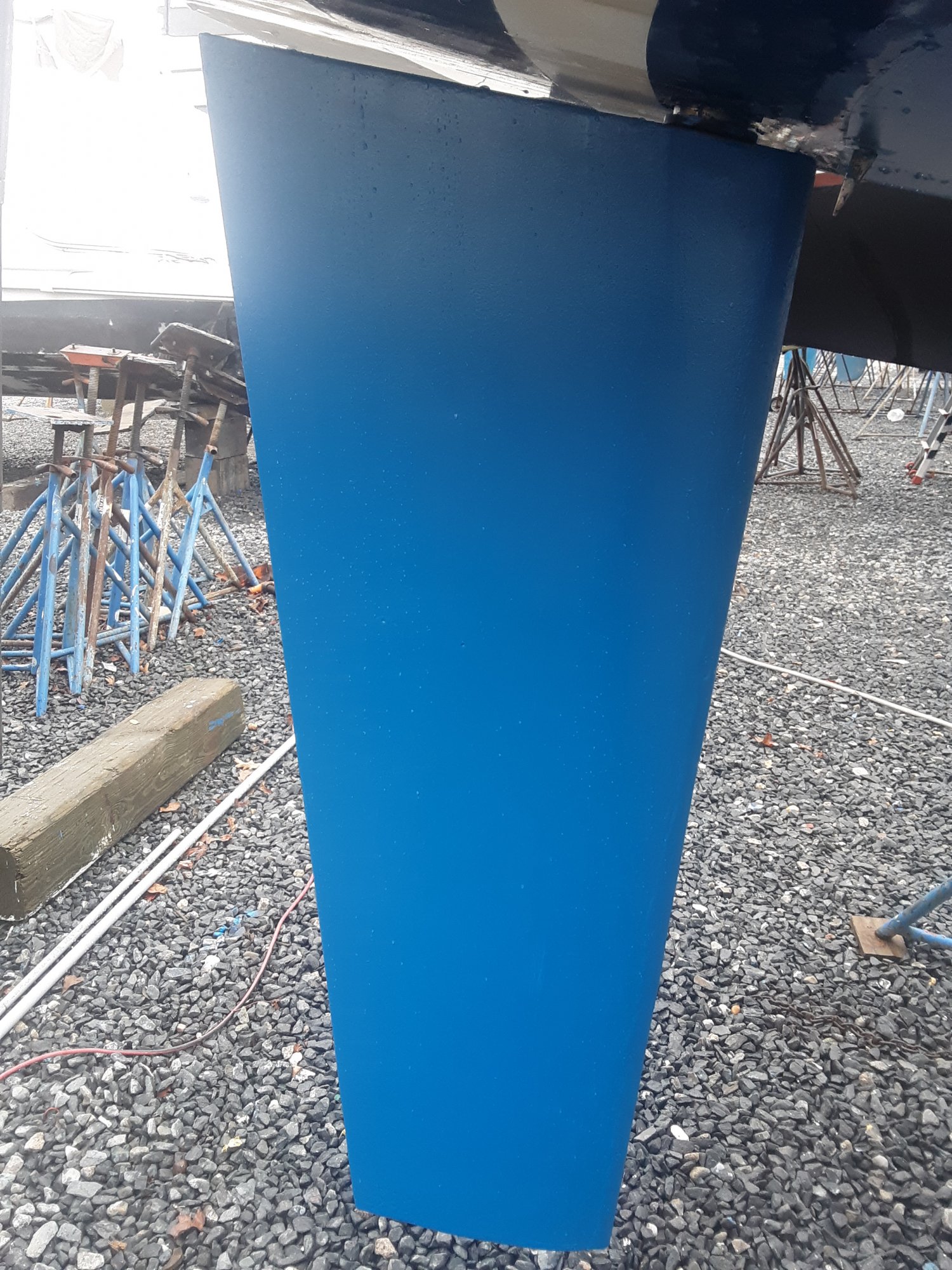

I use same described method for rudders .
Without the vacuum in epoxy just drill a hole on bottom let water run out heat with heat gun to see how much more water I can get out then put on vacuum pump while sanding down to gel coat and then roll on epoxy paint to seal all while vacuuming to pull epoxy paint into any voids or pin holes for first 4 coats then seal bottom hole and 2 more coats epoxy e2000 heavy on bottom patch

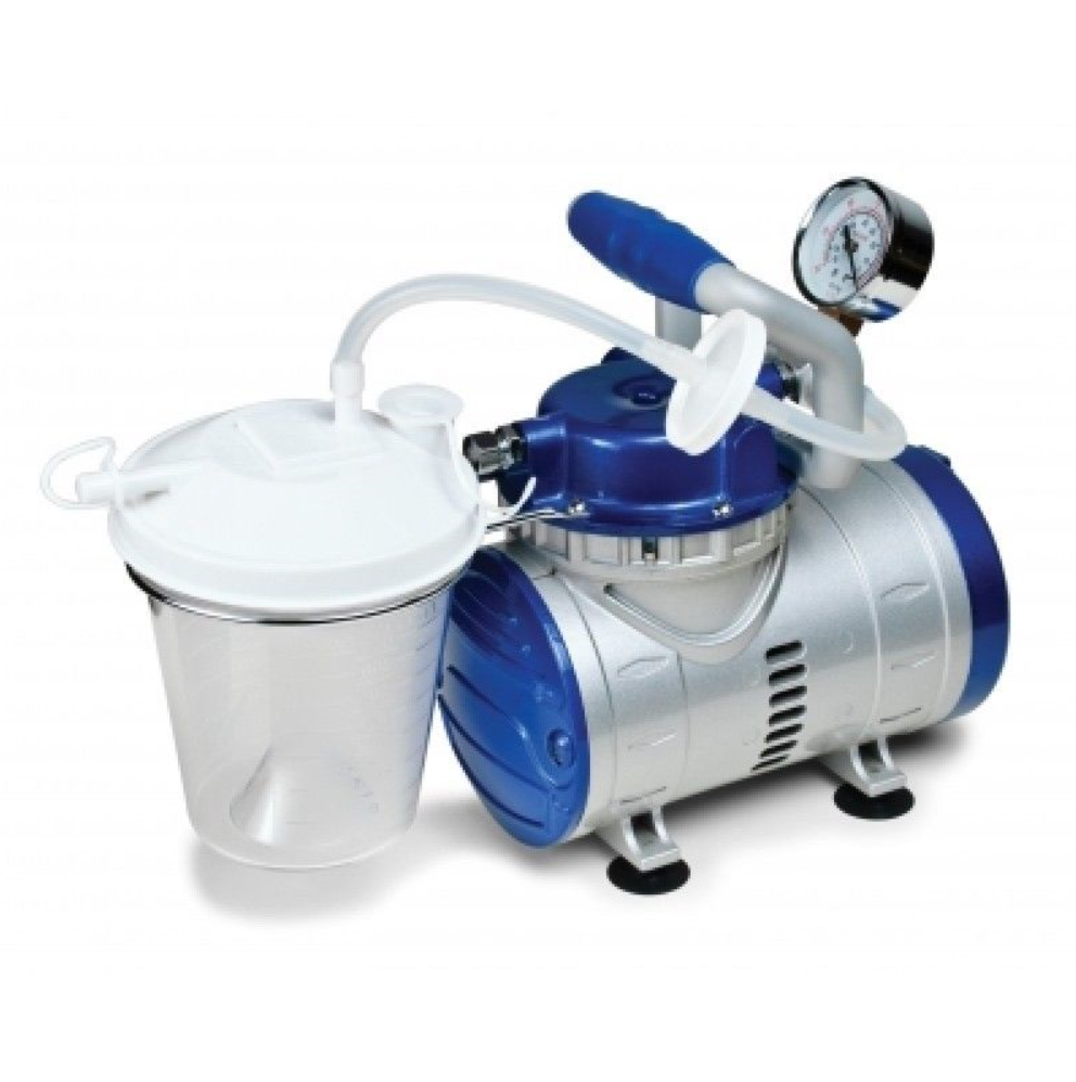

Hayden Watson, I have been reviewing this brilliant thread. It is very helpful. I am gathering materials to do a similar repair on my boat deck. I assume the mason jar was able to take full vacuum without imploding? Do you have any product information on the air /water separator you referenced in the picture as an alternate to the mason jar? Also the source for your vacuum gauge, air / water / separator / regulator that was shown on the picture of the vacuum pump and tubing? Thanks for your help.
Apr 5, 2009
1,517
Note that I said Mason jar (old fashioned thick walled "canning" jar) and not glass jar (pickles, mayonnaise, etc.) The canning jars are made for vacuum. to seal them, you heat them to boiling in a pressure cooker and then tighten the lid to seal them and as they cool, the create a vacuum.
You could probably also use a air/water separator for removing the water from compressor air but I have never tried that.
The first thing to remember when thinking about useing this system is that the area to be dried MUST BE ABLE TO BE SEALS WITH NO VACUUM LEAKS!!!
Fortunately, vacuum leaks are reactively easy to seal if you have access to the point of the leak. Small pin-holes are sealed with a blob of butyl tape (or better yet, use butyl and plastic sheeting to make that leak into another vacuum port).
Remember that a perfect vacuum is less than 15-psi and anything is pulled towards the solid base.
