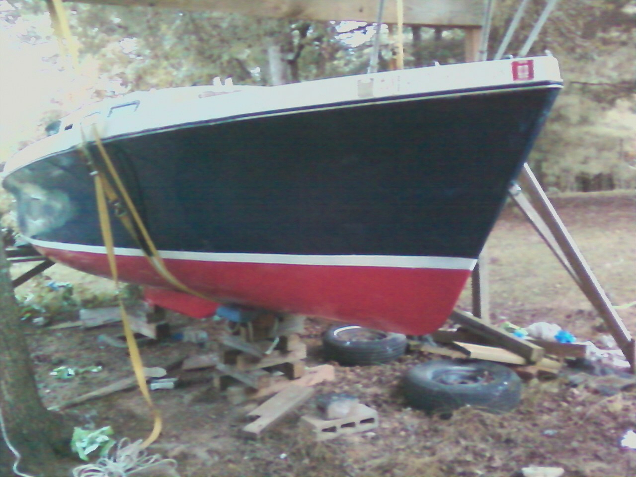

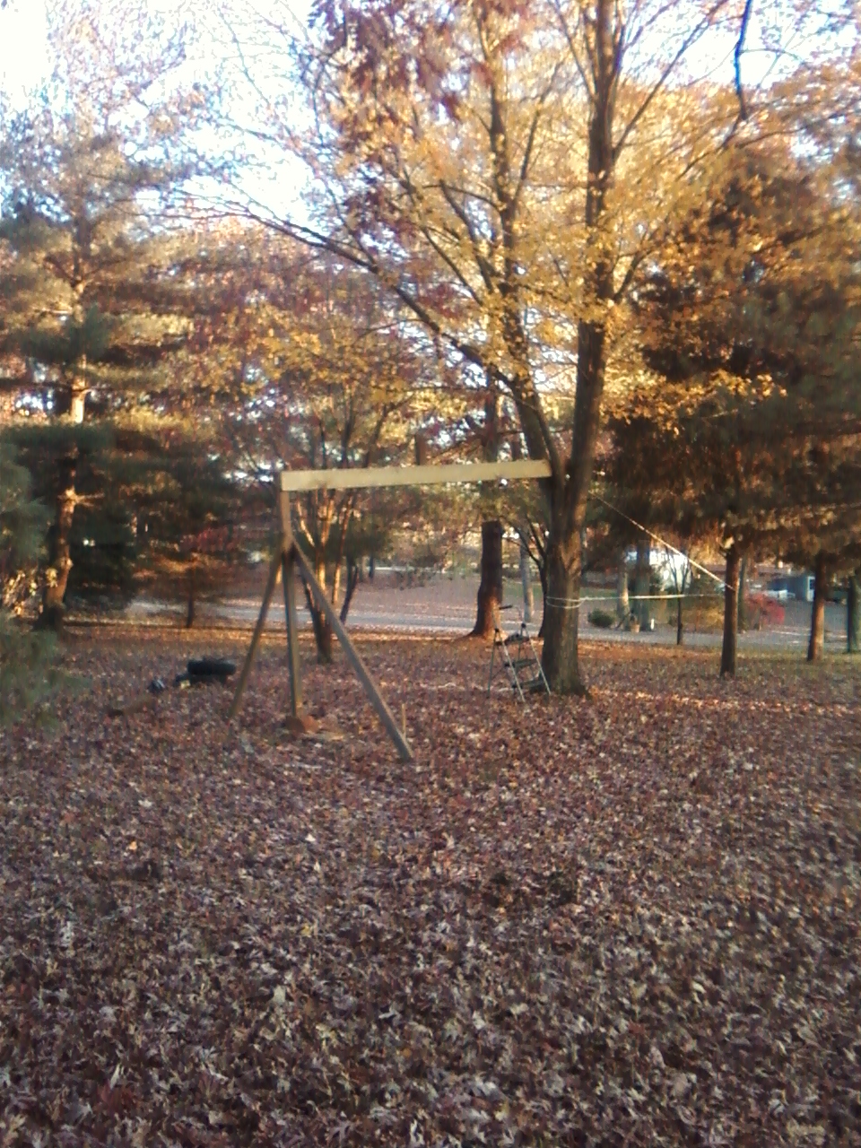

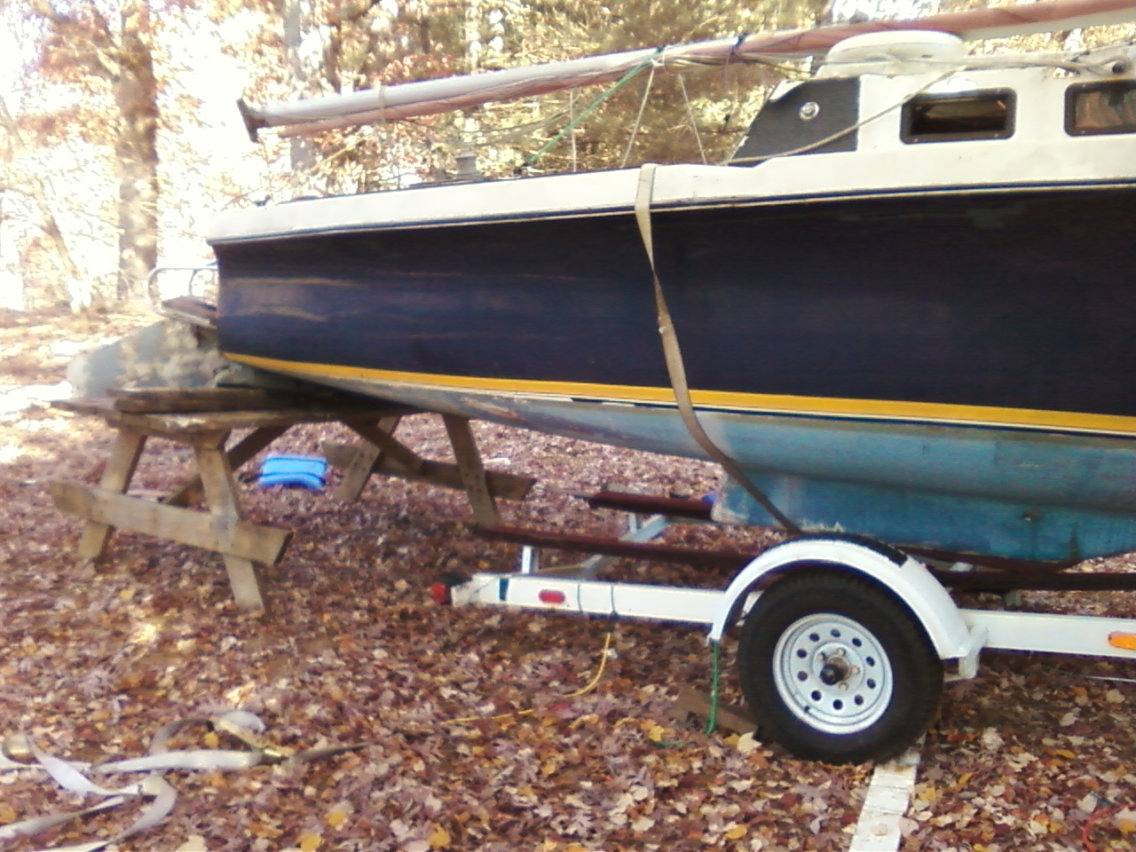

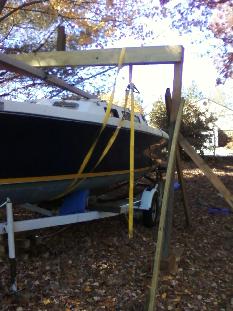

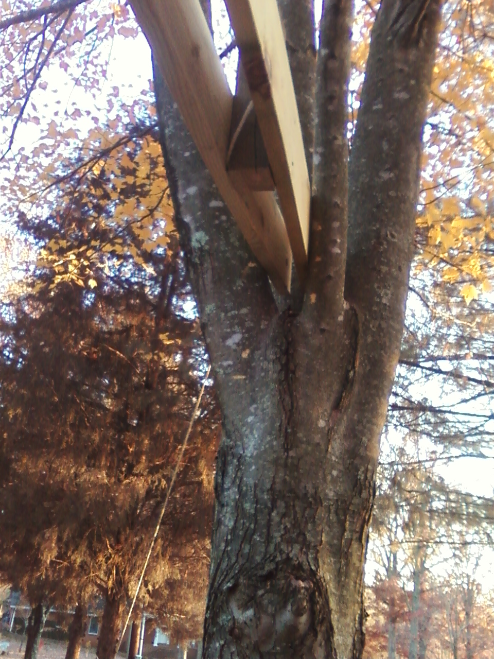

I've hoisted a boat off a trailer using an oak tree branch and tow straps once (don't have pics) and here is how I got my Rhodes 22 off of the trailer...
