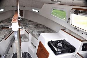

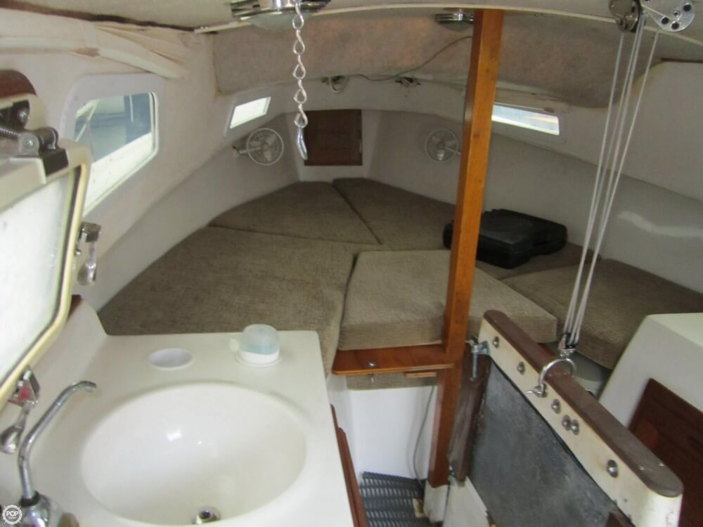

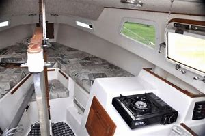

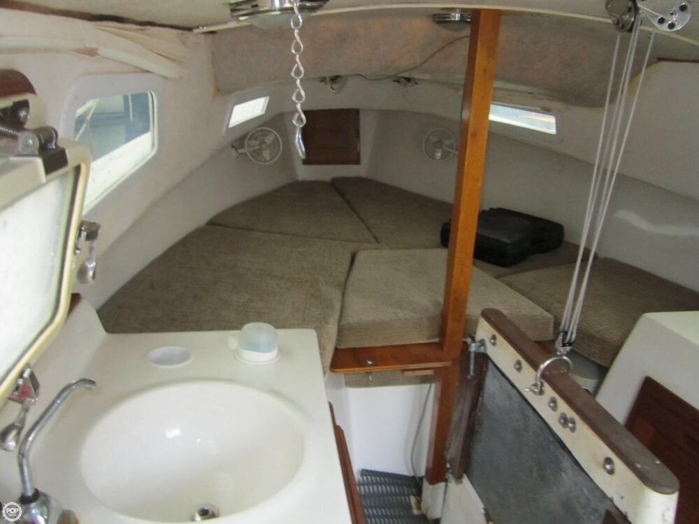

Hi David.
Photographs will assist everyone.
I found this one of the interior.
Is this what you have?
If so, I would be trying to jack it up from below.
Gary
Likes: rgranger

Yes Gary, that‘s the same set up. We tried to jack it up with a bottle jack twice but it didn’t work. The whole boat started lifting up off the trailer. Since I’ve tried several different fluids to loosen I’m going to try to jack it again.
