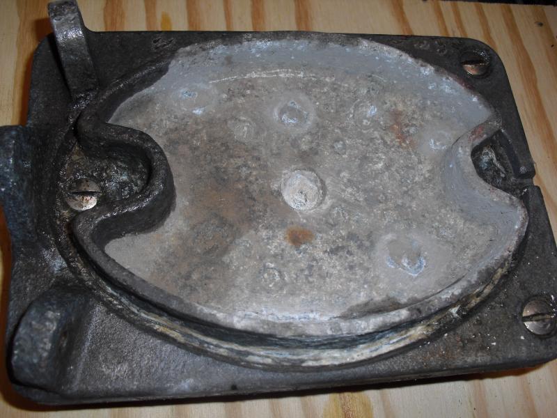

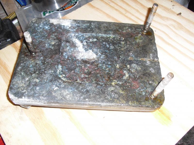

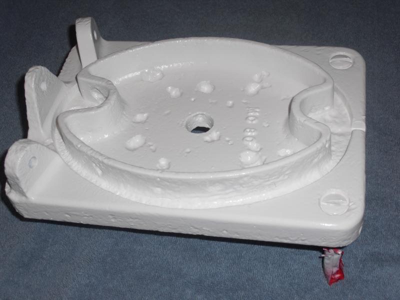

I had the same problem with my mast a few years ago Red. I took my mast to a marine welder on the other side of my city who was also a marine surveyor and he heliark welded it.

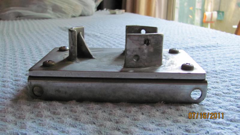

While I was there he told me that the bottom of my mast was corroding due to a stainless steel mast plug. I had a Kenyon stainless steel hinged tabernacle by Rig-Rite in Warwick RI back in the 1990s and they made a special mast plug out of stainless steel and installed it. Just last year the bottom of my mast got so corroded that it was ready to blow out. The holes for the screws going through the side of the mast that held the plug in place were corroded and enlarged and it was all caused by electrolysis.

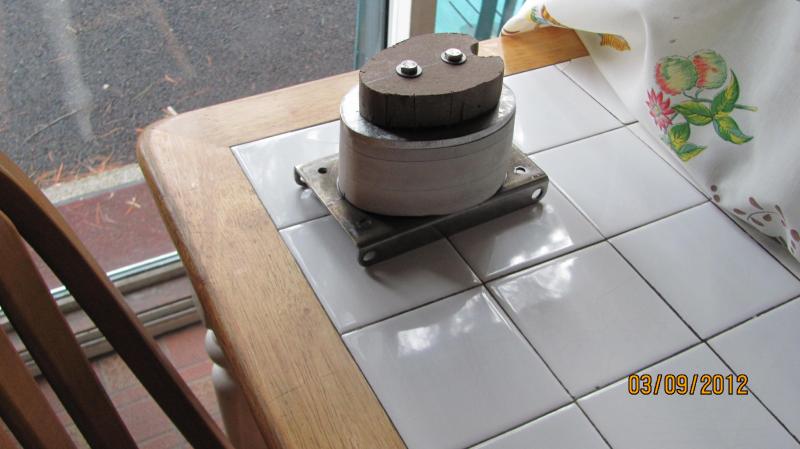

Last year I had to cut 2" off the bottom of my mast and I Mickey Moused the old mast plug with a couple of pieces of 1" Trex to get me through the rest of the sailing season. It was heavy and ugly but it got me through the season.

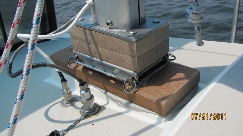

Last month I replaced all of that with a combination of Trex, PVC Foam Board, and a piece of 1/4" Aluminum plate.
Hopefully I'll never have that problem again.
Jan 24, 2005
4,881
Oday 222 Dighton, Ma.

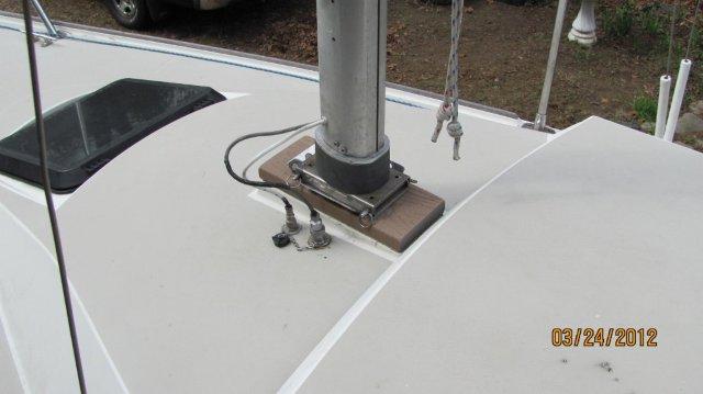

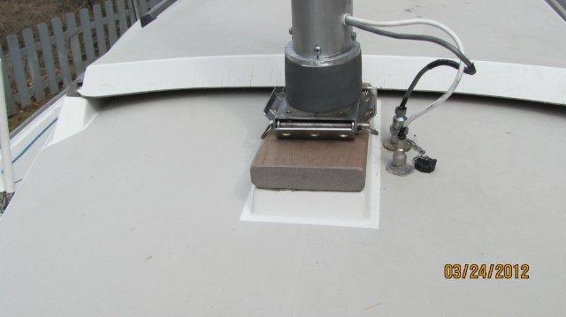

It looks good and it should work for you. I used two stainless steel bolts to hold my mast plug to the hinge plate and where the bolts came in contact with the 1/4" Aluminum plate, I coated them with Never-Seize. This should prevent electrolysis.
I think that entrapped water in the mast can escalate electrolysis faster when two dissimilar metals come together for any length of time. I made a provision in my mast plug to drain that water out of the mast.
My Z-Spar mast came with a cheap cast Aluminum tabernacle extrusion made in France and installed in America. It had a single sheave for the Jib Halyard built into it and I hated it with a passion. Changing it over to a stainless steel hinge plate was probably the smartest move I made after I got my new mast made up. I only wish that the rigger had made up something else other than a stainless steel mast plug.
I'm confident that what I made up is going to work and keep my boat sailing for a long time.
