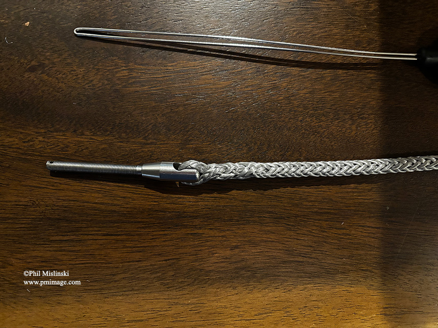

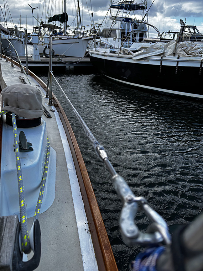

Nothing too exciting here, but I'm nearly finished with fabricating and installing new Dyneema lifelines on Kolibri. 3 of 4 lifelines are done and I will do the 4th late this afternoon. I managed to keep costs low by reusing my old pelican hooks and teaming with a friend to bulk buy a 600' spool of 6mm Dyneema on his WM pro account. I bought the necessary 316SS fittings through C.S. Johnson & Defender Marine at a reasonable price. Here's a pic of the first spice and the first of four gates fully installed. This project has been surprisingly easy thanks to two excellent YouTube videos by Bottom Ups Boats and buying the right tools.

Phil were you able to tie a locking Brummel knot and then bury the tail after first tapering the tail.
dyneema is slippery
dyneema is slippery

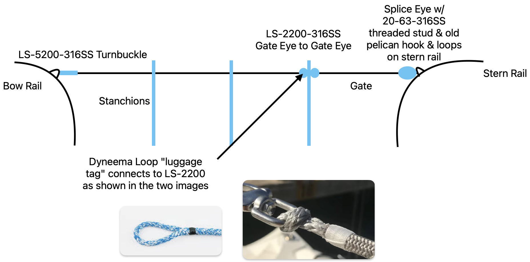

I did not use any knots. I used a locking Brummel splice at every location. Here's a very basic sketch of the setup.
When both ends of were free I used the locking Brummel splice technique shown in the first splice in this video:
When only one end was free I used the locking Brummel splice technique shown in this video:
Tools used were Selma splicing fids, Ronstan splicing needle with puller, and this pretty cool kevlar cutting scissors

I did Impetuous' lifelines several years ago with Dyneema. The ole vinyl covered lines were showing rust through the cracks in the vinyl and I thought I'd really like to keep the Admiral in the boat. She likes to lean against the lifelines while steering.

Nice Phil. I’ve used the same method on my bot for locking Brummel knots in dyneema. Is becomes a challenge when you only have on free end.
Be sure to watch the second video I posted. I was really surprised at how easy it was to do the locking Brummel splice with one end fixed. The video is shot so it's easy to see what the guy is doing and he provides many great tips throughout the process. I also had my iPad sitting on the boat with me as I did those splices so I could follow along while doing my splices while hitting "pause / play / rewind" as necessary.

Yes that is what I call a Brummell knot. Locking splice is also used. Pretty cool technique.

Yes. His presentation is a good one of the locking Brummel from a single end.
