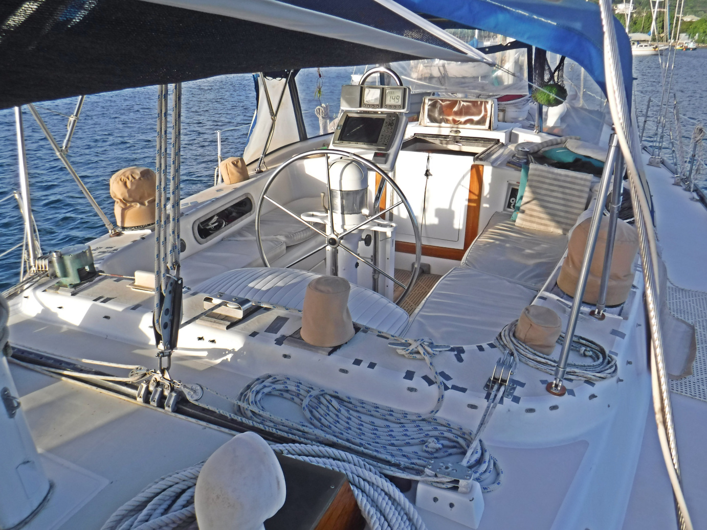

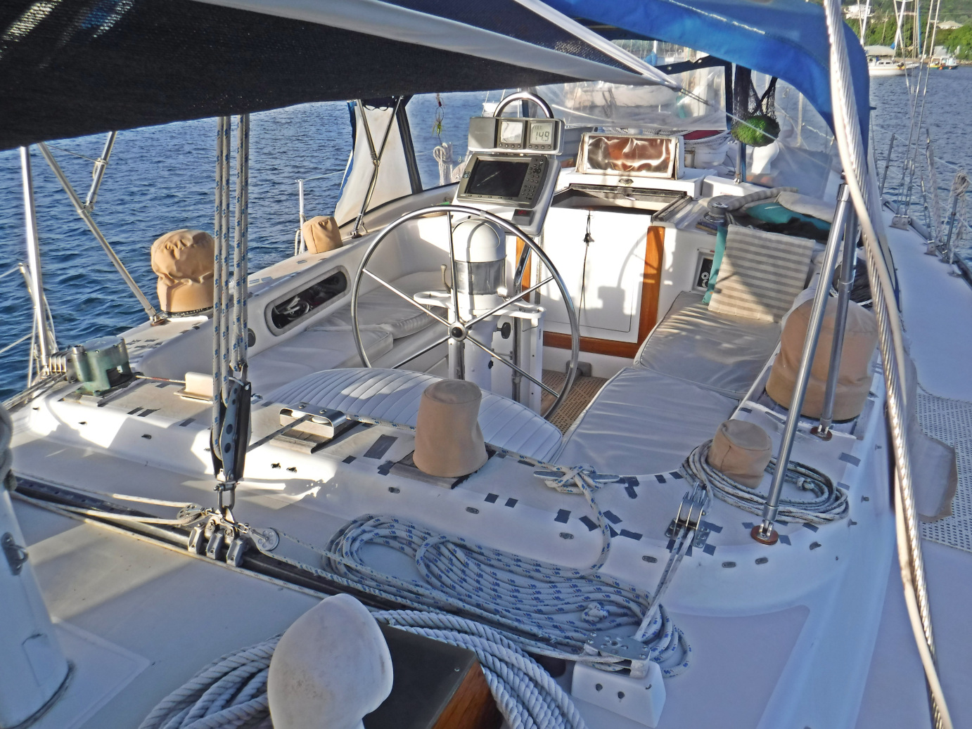

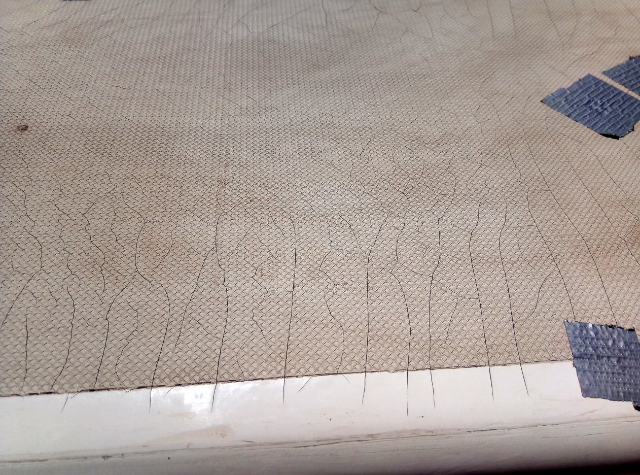

An update. Here's a pic of the coaming. Square tape are holes for screws or bolts that won't be going back on. Absolutely no cracks around the winches, which is why, if patched properly the ones from under the teak shouldn't reappear, I hope.
As you can see, non-skid is pointless.
As you can see, non-skid is pointless.View attachment 187412
Wow that’s a lot of holes! :) You might want to consider filling the holes before you sand it all off.
The picture confused me for second, bow direction was obvious, then I noticed the mast? Took me a second to remember you have a little bit bigger “yacht” then mine ;)

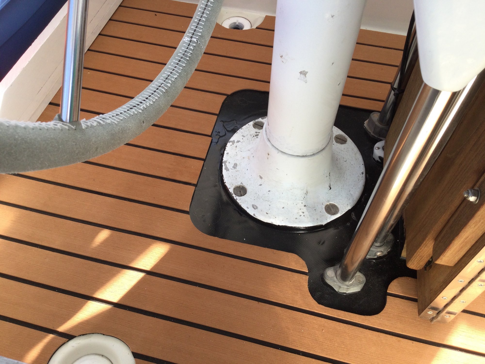

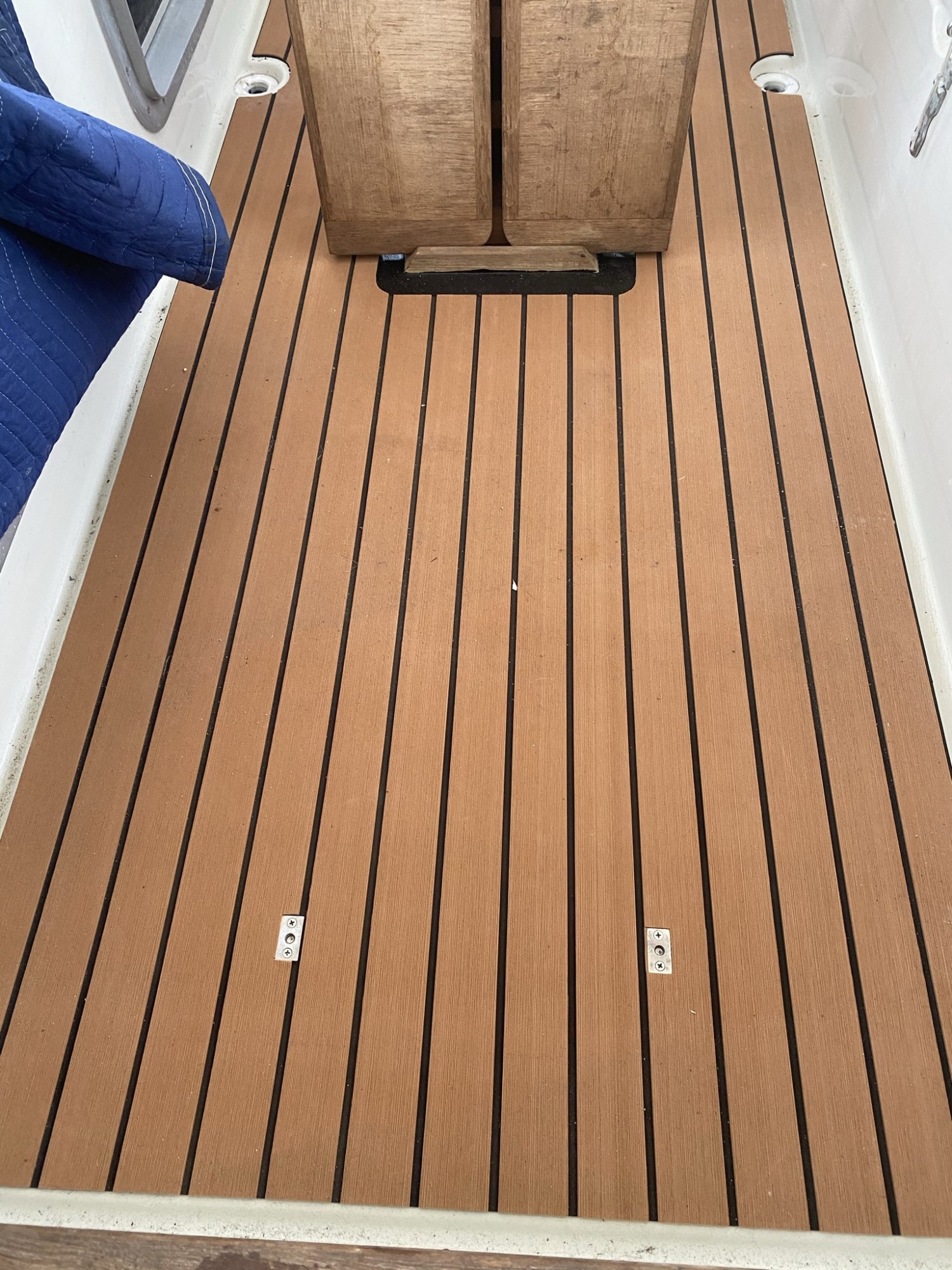

We got a new generator and had to cut a hole in the cockpit floor for the replacement. They added faux teak over the glassed in hole. We’re considering this around our coaming. HD carries this.

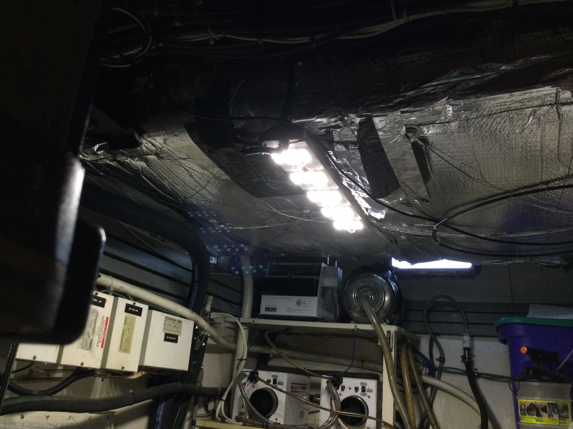

Got rid of the 12v light in the engine room and added LED’s.
Amazon has it, EVA Faux teak.
U-tube shows how to install.
That is the plan. yeah, two masts. lol
