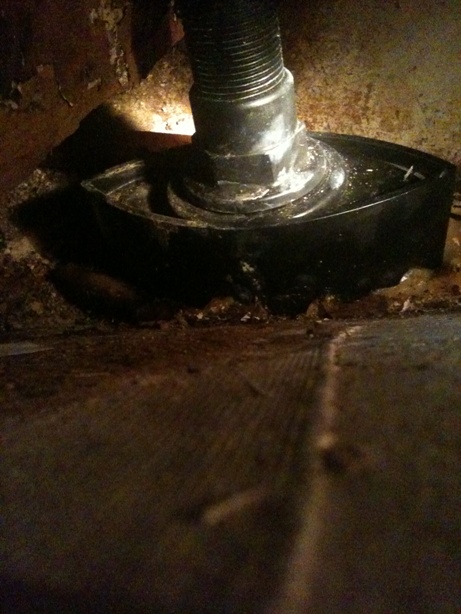

Not much to see but a pic of mine is below.
Because of the location under my vee I had to install my transducer by touch. I checked the area with a mirror, then with the transducer in a bag of water after wetting the spot.
Clean the area as good as possible the take a piece of the wax and mash it down good to make sure there are no air bubbles, repeat until you have a big enough glob.
Mine's been there for 4 or 5 years with no problems.
