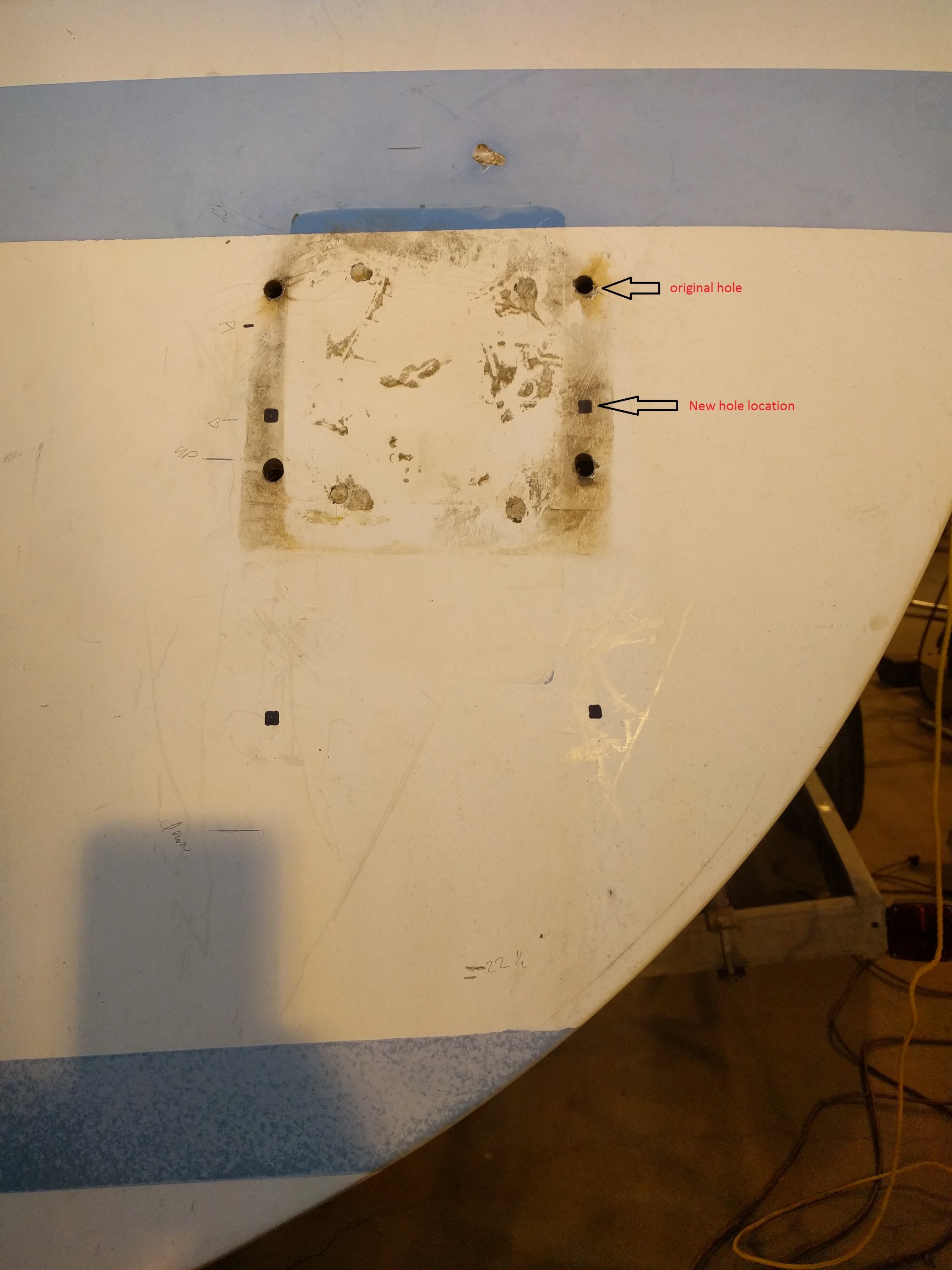

Hi All,
I have removed the "Garelick" Outboard motor Bracket because the previous installation was incorrect in every respect. The mount was incorrectly assembled and required a stack of wedge shaped plywood pieces to get the mount to sit plumb on the transom and plain steel bolts were used which are now heavily rusted and the wood is rotten. My plan is to repair the previous drillings and secure a 12" square piece of G-10 fiberglass board to the inside of the Transom. My actual question is where is the waterline on my 1977 O'Day 22 ? The Honda 4 stroke manual I have states that the anti cavitation plate needs to be 4" below the waters surface and the Garelick has what I measured as a 8" range of motion up and down. Before I place the new bolts for the motor mount I want to be confident I'm at the right height. There is a Blue stripe painted on the Hull down low that is a couple of inches wide. Is this the actual waterline? Should I do something else to determine the height of my engine?

It was suggested to me to drill the bolt hole locations with a 1 1/2" holesaw and fill in the resulting cavities with fiberglass and let it set up solid. Then fiberglass a 12" square piece of G-10 inside the transom as a backer then drill the actual mount holes. Making the holes oversize and refilling removes any wood or foam core and replaces it with solid reinforced resin. Does this procedure sound reasonable?
That is about what I did when I mounted my boarding ladder but first I drilled a hole to see if any wood came out. None did so I looked carefully at the inside of the transom. I could see where the wood was sandwiched on the other side and where the rudder was mounted. It was obvious that there was no wood on the side I was putting the ladder so I skipped the oversize holes as there was no wood to protect.
You might want to think about another layer of G10 on the outside to sandwich the transom fiberglass for a little more stiffness. If not G10 some board that is easily painted or comes white.

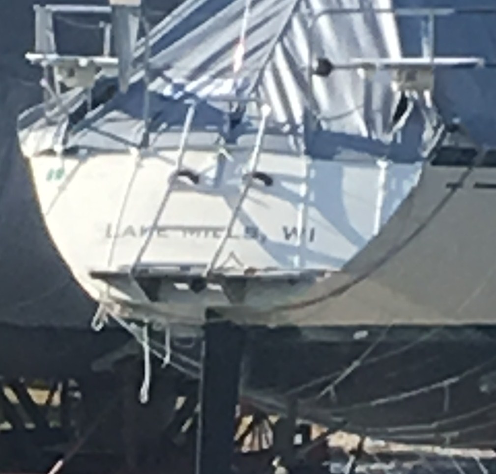

I think you are missing a major consideration. As your boat speeds up and approaches hull speed the will literally sit in a hole. It's this hole a planing boat powers it's way out of. The boat below has a swim platform that is at the waterline when the boat is at or near hull speed. Note that the waterline below the dark green boot stripe. The swim platform is over 18 inches above the line.
You will want to put this all into consideration. I feel your pain in trying to figure out what the PO had in mind. I had two POs one did good work the other made a mess of things.

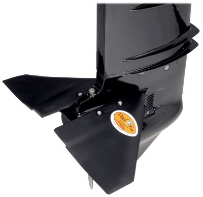

Nope. I meant anti-ventilation plate. From what I know, cavitation is the condition where the pressure drops across a propeller blade so low that water boils on the surface of the prop. With really bad cavitation, the collapsing bubbles of the boiling water can erode and damage the surface of the prop. From submarines, I learned that low speeds of the prop reduce the chances of cavitation, but higher speeds are very noisy because of cavitation. Now, ventilation is the condition where the prop sucks air in below the surface, and loses bite on the water. So, how can a plate above the prop, outside the turning radius of the prop, affect low pressure gradients across the surface of a prop blade? As far as I'm concerned, the plate on the lower unit is intended to reduce ventilation, particularly when turning. When I was a 20-something idiot, my friend and I water skied a lot. His boat would ventilate all the time when turning hard to go back to get a skier. He installed a Doel-fin on his motor, which were wings extending out to the sides of the anti-ventilation plate. At the time, there was much to-do about these kinds of fins, in that they would aid hole shot, and get the boat up on plane faster. We found that they allowed the boat to turn much more quickly without ventilating and spinning the prop with high RPMs. (The boat turned so quickly and sharply, it would sometimes hook the spray rail and turn violently sharper. Don't worry, he still feels guilty about the time this caused the boat to run me over. But that's a story for a different time.) It probably didn't do much for top-end speed, as it introduced more drag, but on the other hand, we're talking about a 16' late 60's/early 70's aluminum Crestliner with rounded chines, so there was no inherent speed performance in that hull :D
Anyway, I'm calling the dang thing an anti-ventilation plate, and I'm sticking to it. :D:D:D If we find a marine hydrodynamic engineer who explains to me why the industry calls it differently, and why I should too, I'll consider it. ('Cos I'm pedantic like that.)
Here's what an installed Doel-fin looks like:
