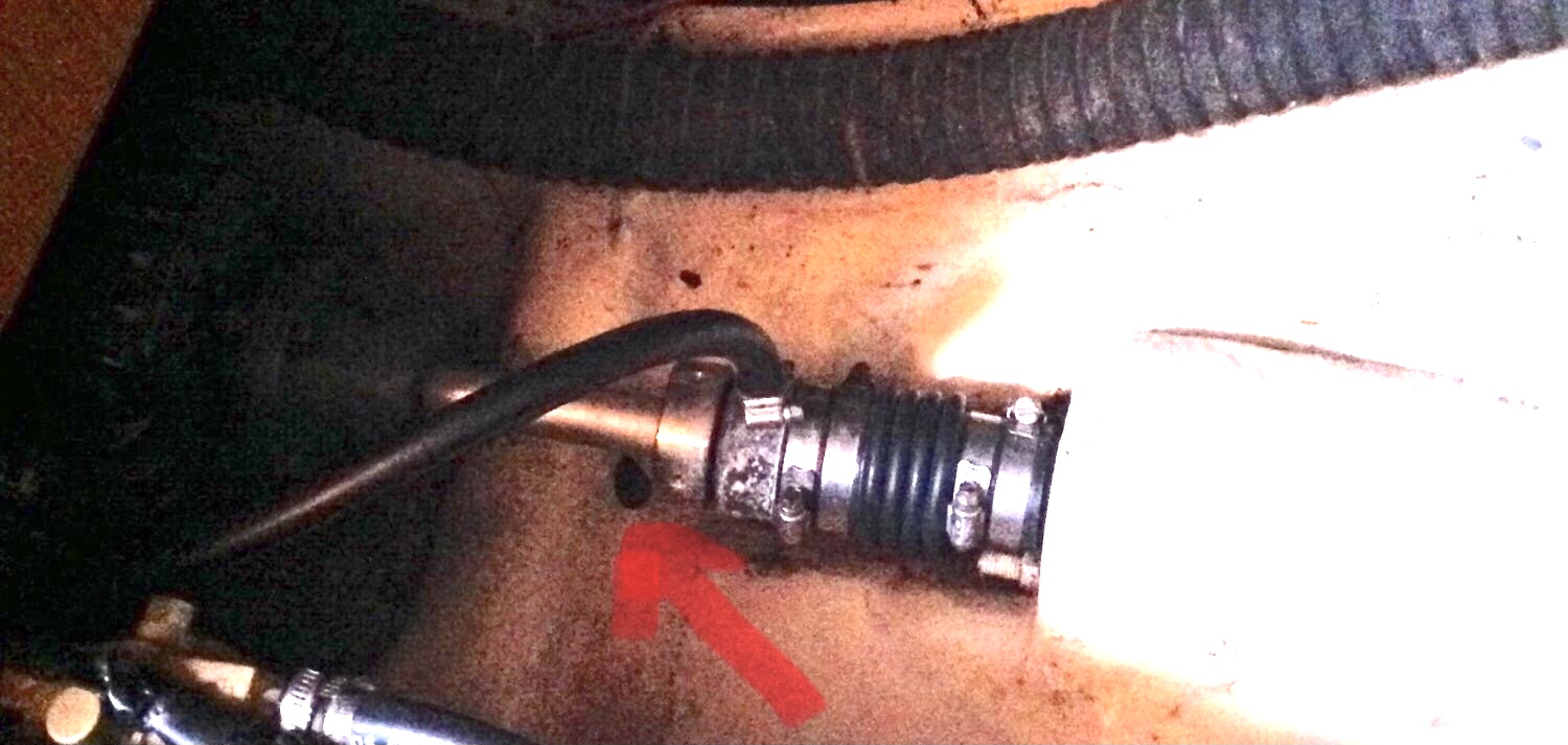

Water under engine while motoring — shaft seal leak? [Photos attached]

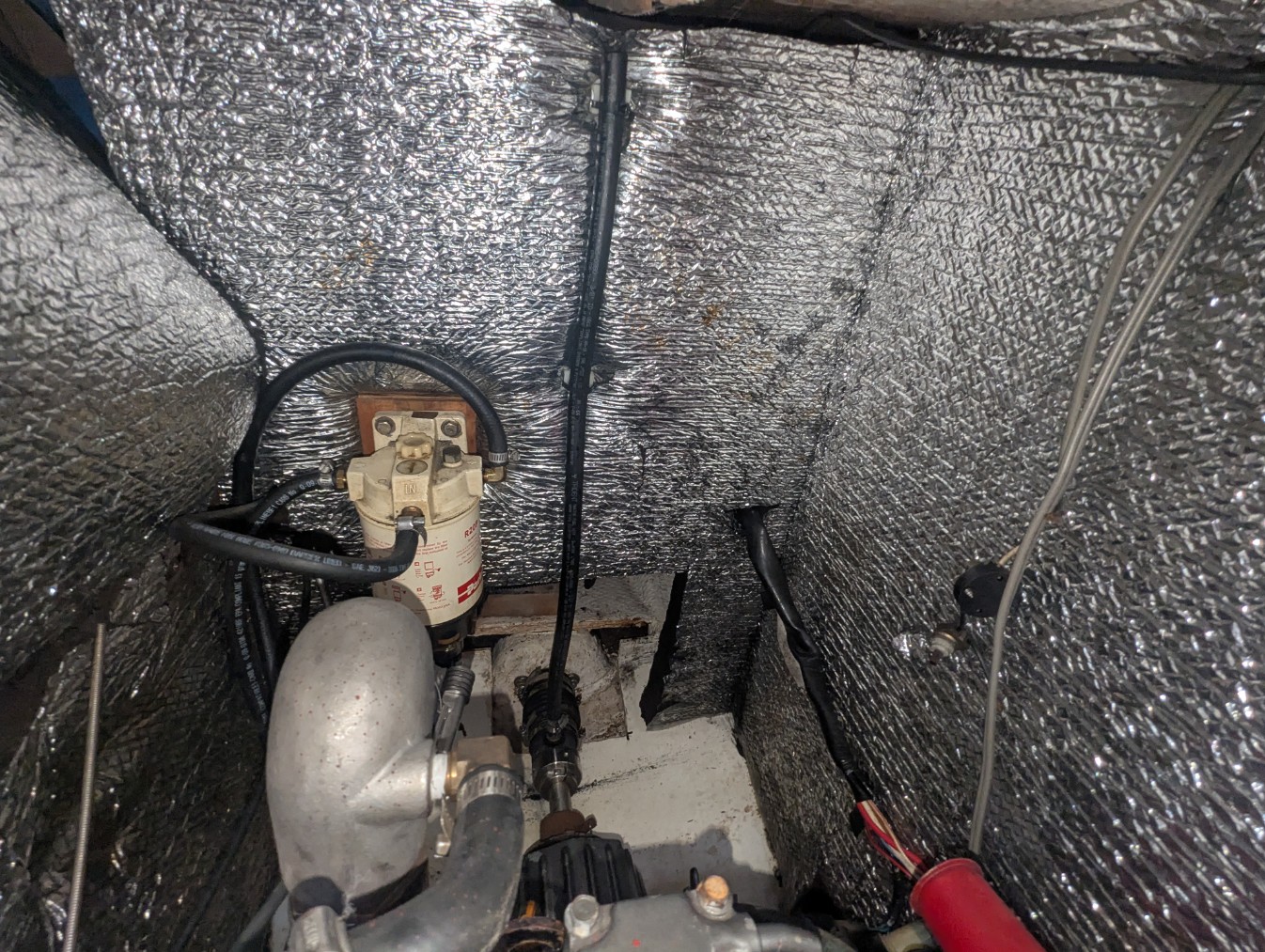

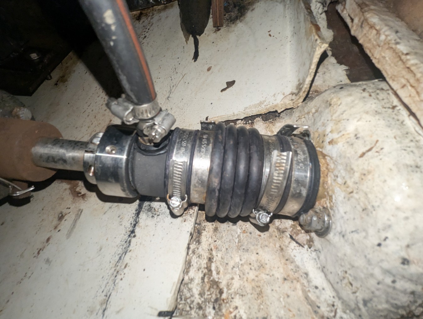

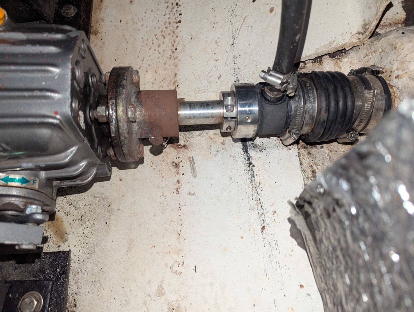

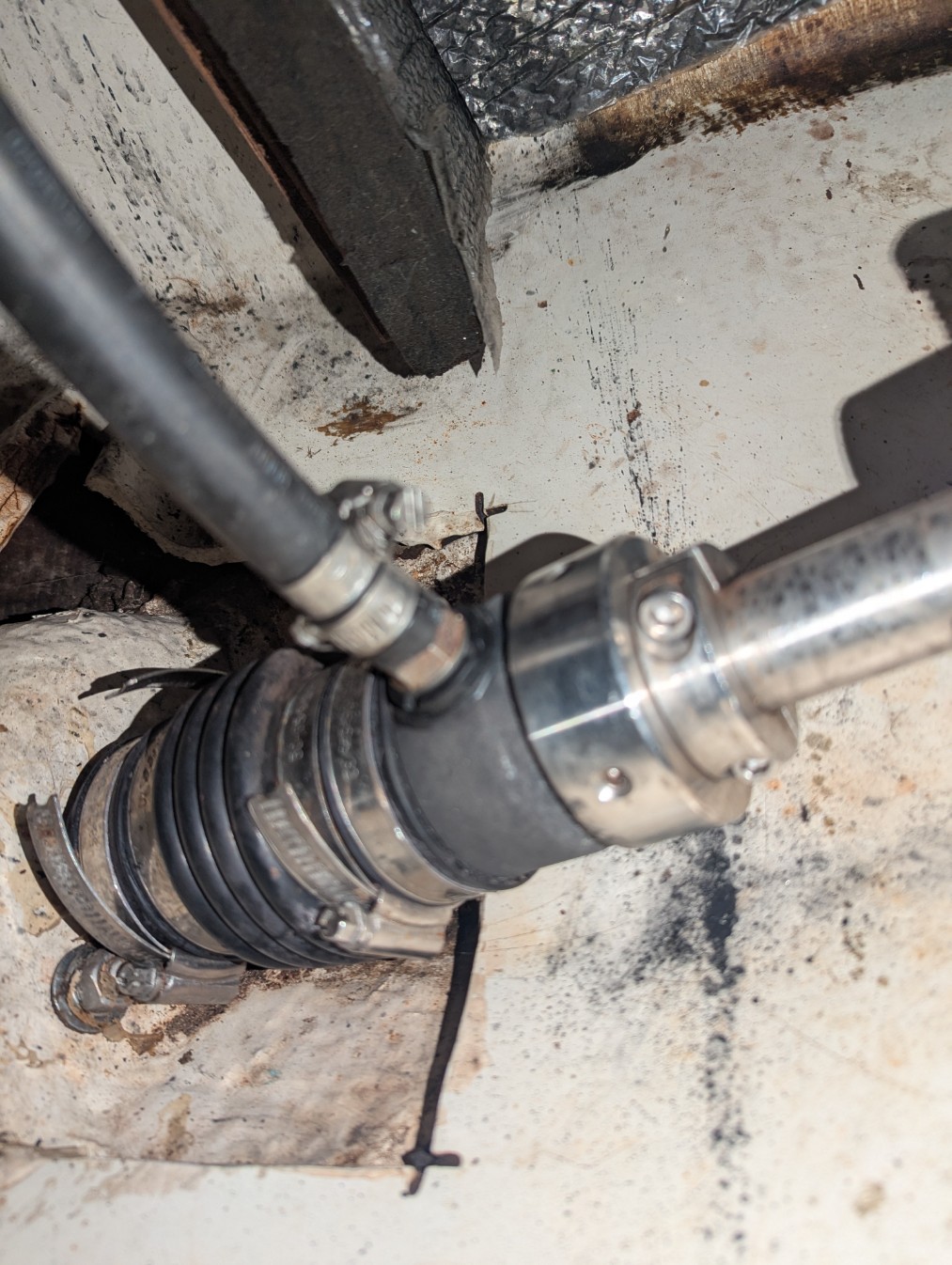

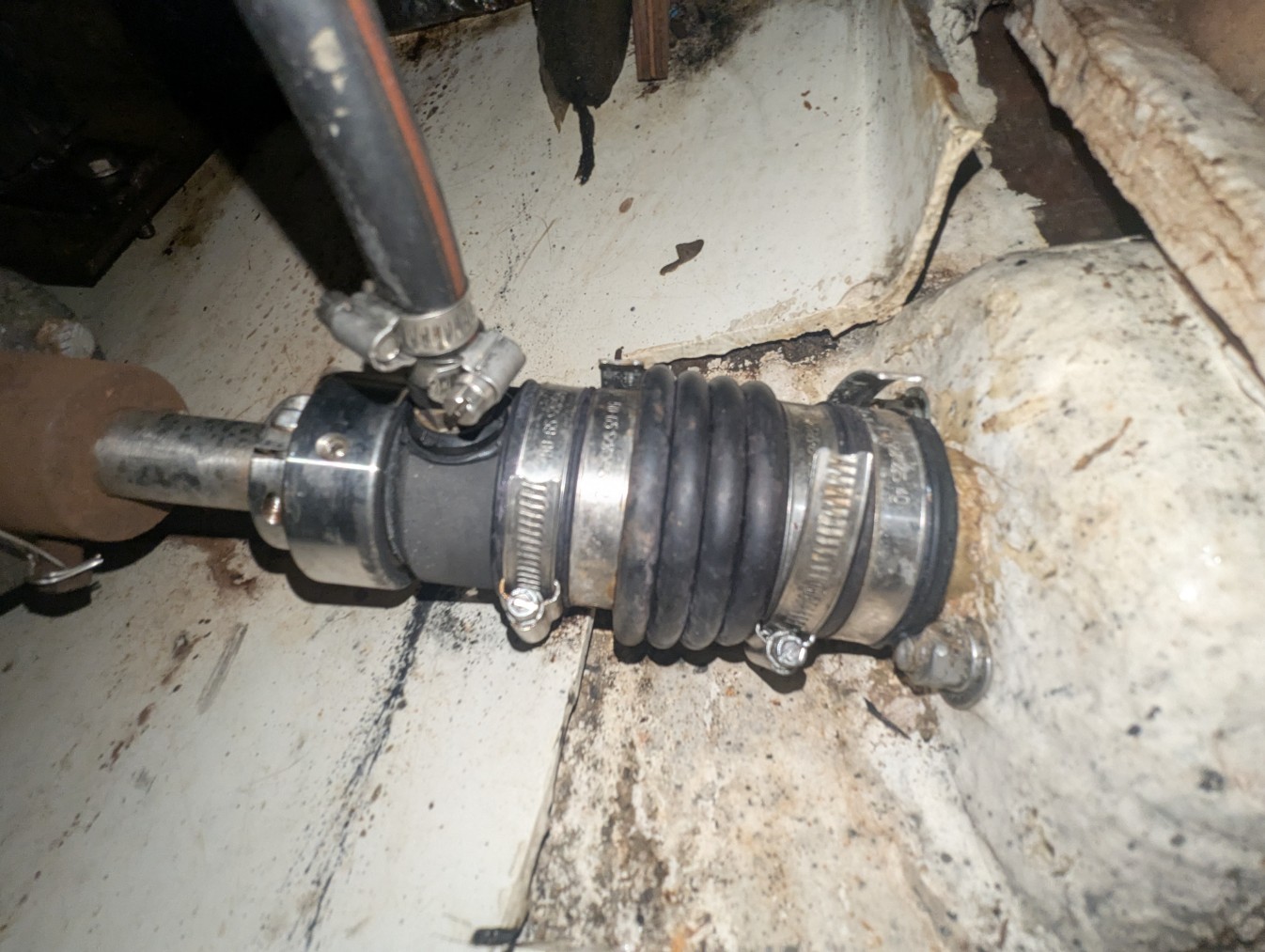

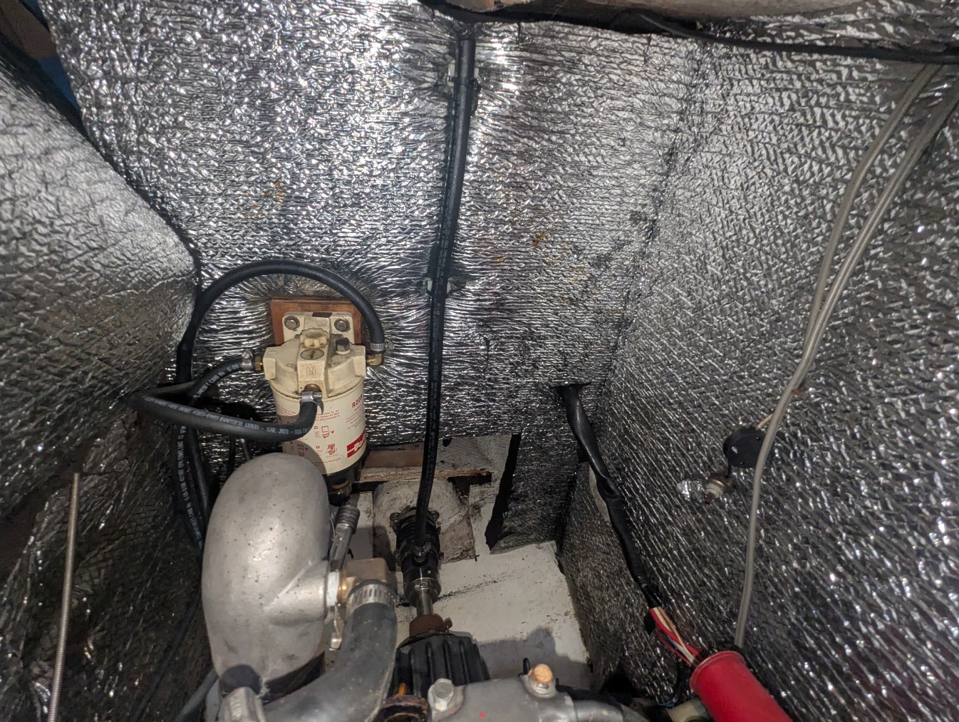

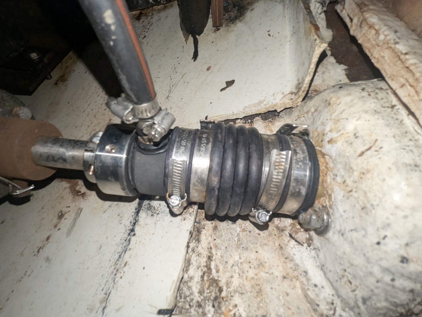

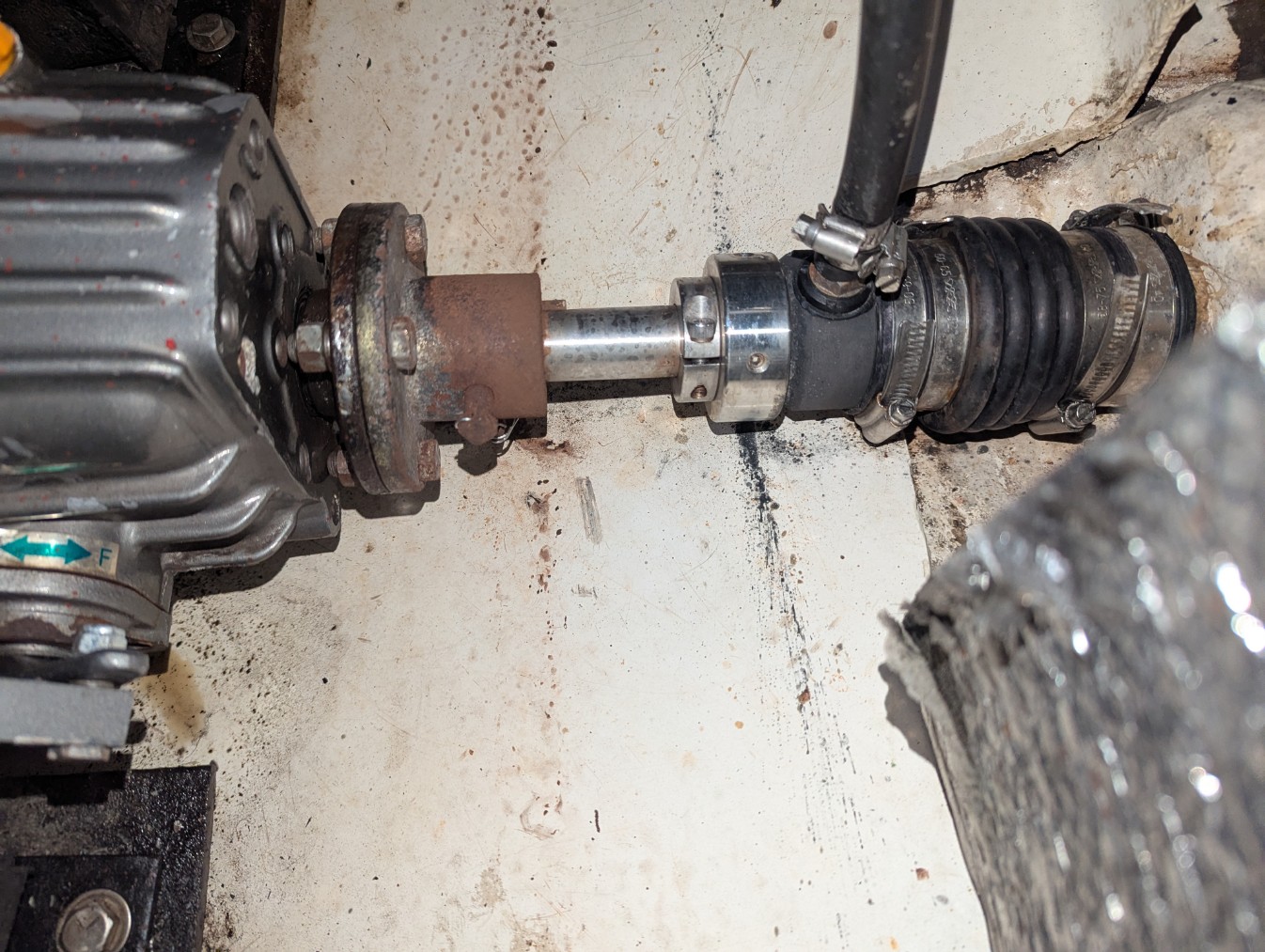

Hey everyone,
Did an oil change today on my boat. The old oil came out black with a milky layer on top. After changing it, the new oil looks good so far — no milky film anymore. I’ll check it again later to be sure.
While I was at the dock, I ran the engine for about 15 minutes in neutral, then put it in gear (both forward and reverse). I saw the prop shaft spinning fine. No obvious water ingress or leaks during this short test (maybe around 10 minutes total).

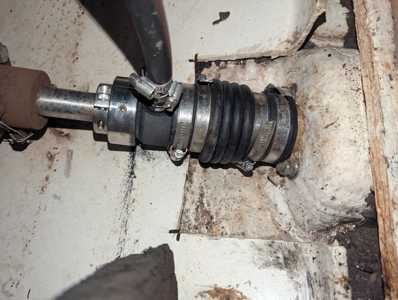

I’ve attached photos showing what I found.
Any thoughts on what might have caused the milky layer initially? Or anything else I should check next?

There should not be a "milky" layer on top. That is emulsified oil (water in the oil mixes with the oil and get kind of "frothy".) Was it just a few mm of milky layer or much more? When you changed the oil, had you just run the engine to heat up the oil (that is what I do). Did you happen to take a picture?

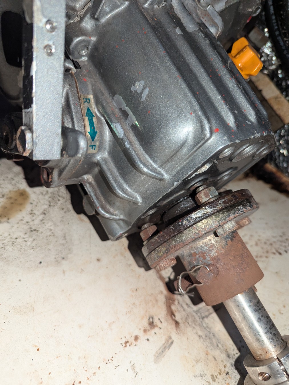

I don't really think the water under the engine is coming directly from the PSS seal. A video of the shaft turning would be useful to see if there is an alignment issue. Also a picture of all four engine mounts, as best you can, showing the rubber portion would be helpful. Even if it is not associated with the leak you should inspect these periodically. Since this is a "new boat" to you, knowing as much as you can about condition of critical components and equipment is important.
A sea story follows: I once had a mooring mate that was confused by the "milky stuff" in his bilge and thought it might be "sediment we call pluff mud here" and I told him that is not likely as the water is 20 deep where his mooring sits. He said if feels "slick" and I knew immediately it was emulsified oil. He said "Oh" that makes since because he had a major oil leak that emptied his engine oil on a short 2 mile trip from his mooring to a dock :yikes: We then went out to his boat for a "look around" and he did not know where all his through-hulls were located, how many there were, and if they were closed or open :facepalm:. Some doors where they might be were "stuck" or screwed shut and could not be opened without tools. I am not saying that you are in that state of knowledge but you need to crawl all over you boat and into every cranny and crack where you can stick your head and see what is there. You'd be surprised. I found a good 3 bladed prop stuck in a cranny that the PO had put there when he installed a MaxProp. Sold it to someone on the site here and he was pleased as punch.

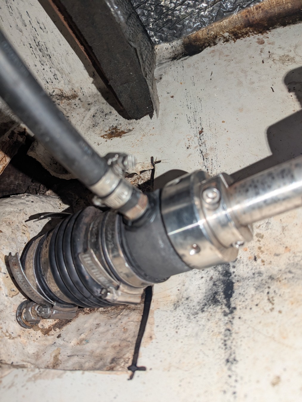

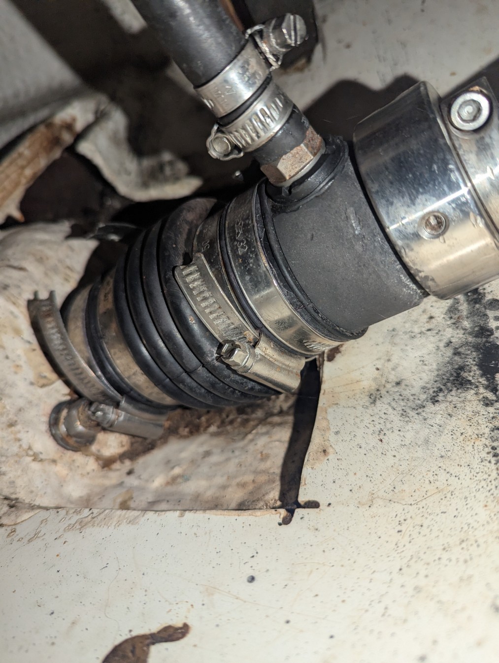

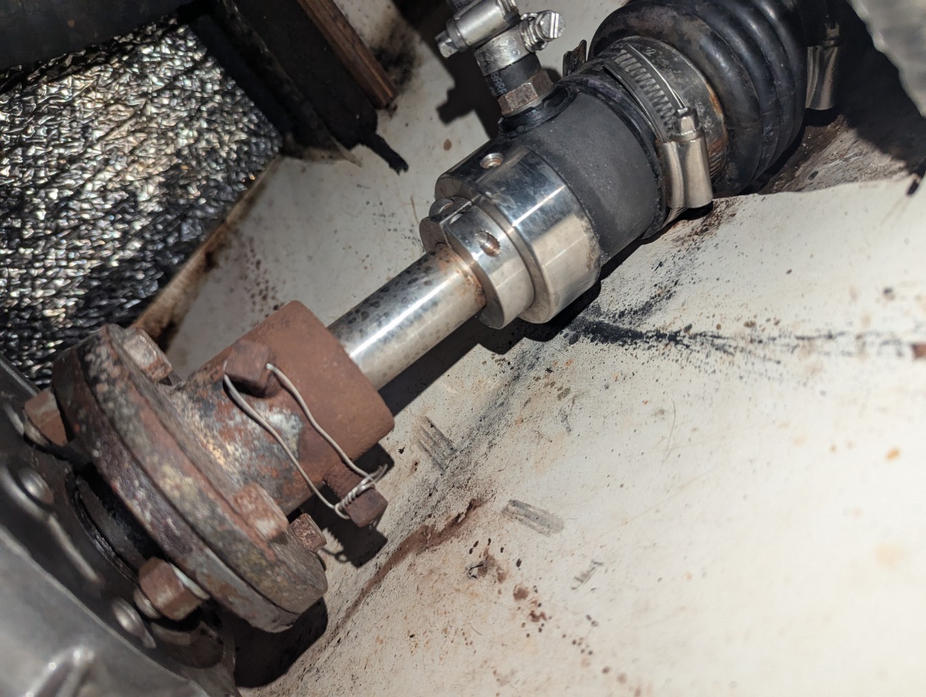

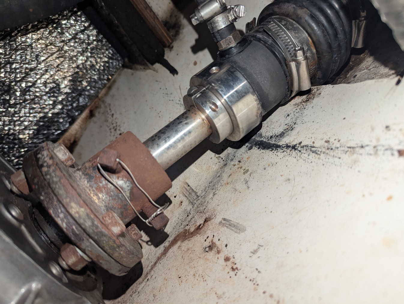

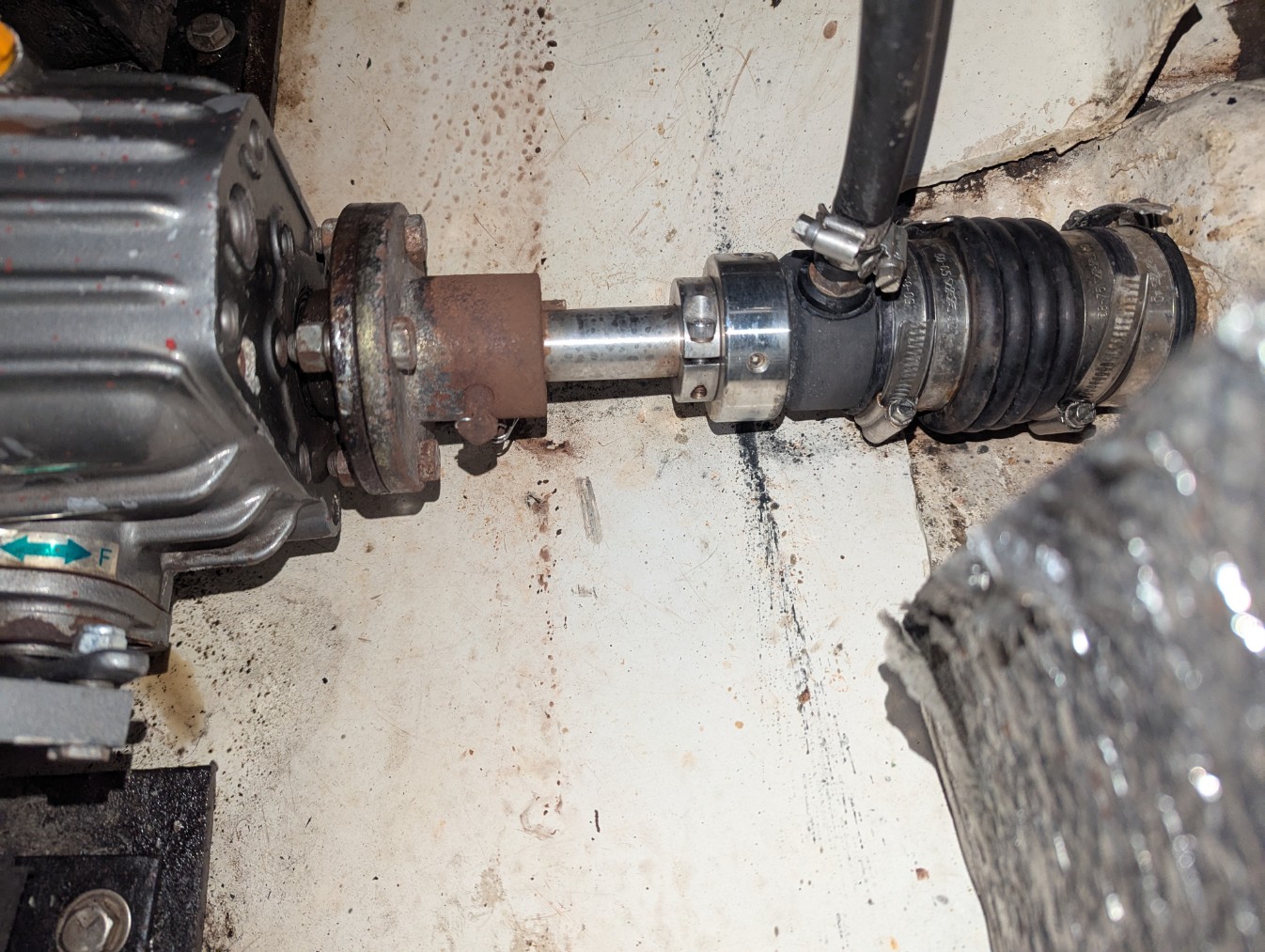

The black streak under the shaft seal is probably carbon coming off of the seal as the graphite collar and the SS collar mated. Some water would have sprayed out as this happened, but that would have occurred right after the new seal was installed.

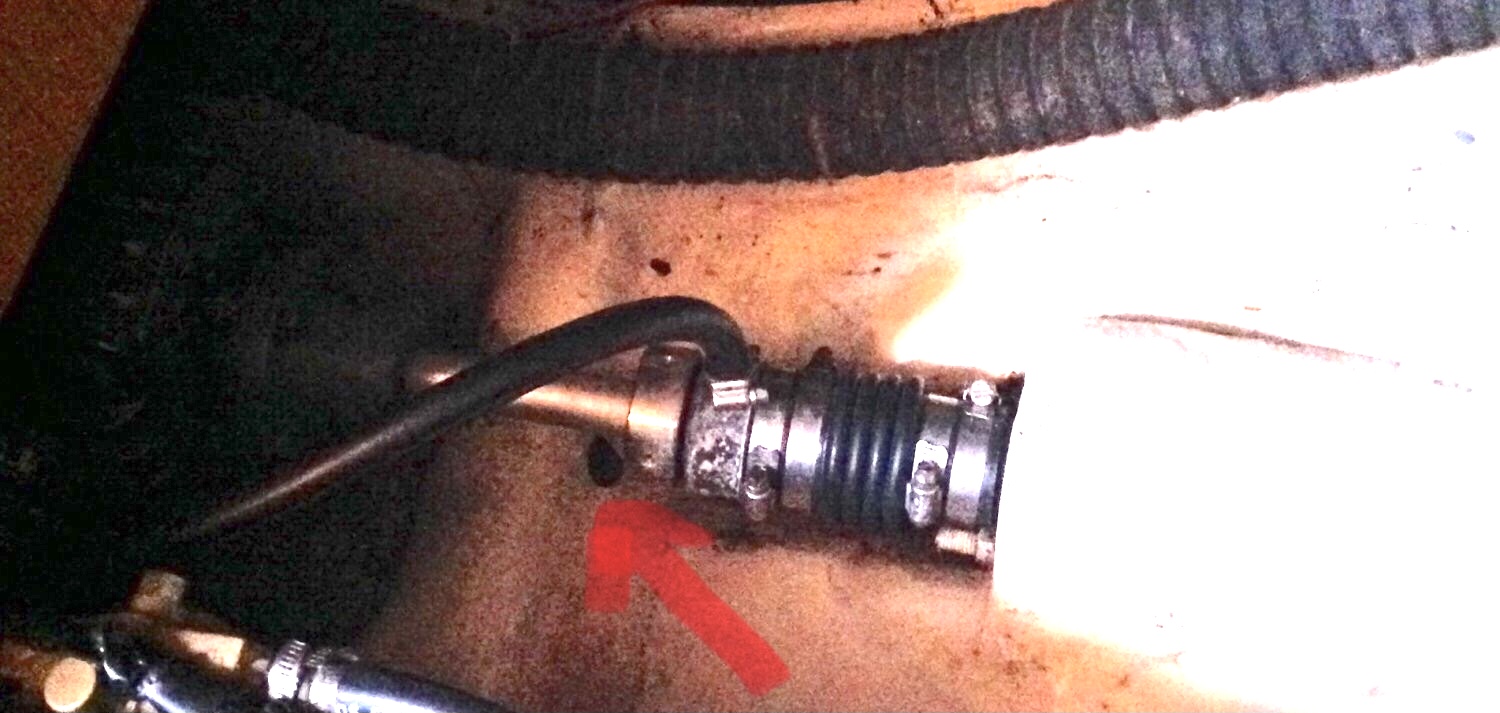

On my 340 there is a weep hole in the stringer that is just behind the engine compartment.
This is 1 1/2” high and isolates the pan under the engine, keeping any liquids that may leak or spill contained, under the engine.
Any water that may spray from the PSS or leak from the engine thru hull will find its way into the bilge.
This is what lead me to believe it was the hose you have attached, as I do, to the PSS, that may be the cause of the water you show “under” the engine.
If you have ruled that out and If you do not have this weep hole in your boat, or its covered over or plugged, then does any water that may appear in that area, stay under the engine compartment, until you manually pump it out?

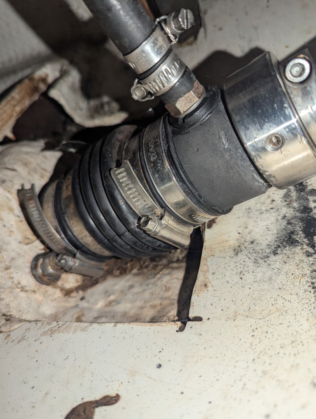

Hey everyone,
First off, it’s great learning this engine build with all of you. I really appreciate the advice and read every post carefully.

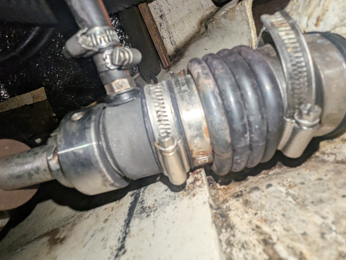

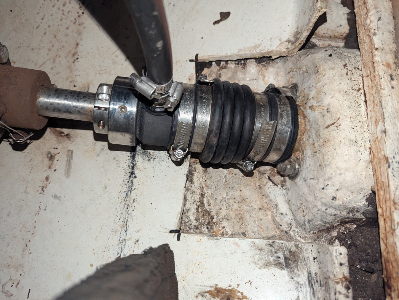

Quick update: I’ve checked all my pictures around the prop shaft and don’t see any weep hole. Access isn’t great, but nothing obvious so far.
I also noticed a cutaway in the fiberglass right below the bellows of the PSS shaft seal. Water doesn't seem to fall into that cutaway. It falls somewhere and pools forward because the compartment slopes down (not into the bildge). I’ve never seen water directly under the seal itself. Not sure if that’s normal or a clue.
Another detail: there’s a hose attached to the top of the carbon graphite rotor on the PSS seal. It runs straight up above the engine compartment and I assume it’s an air vent. My hull speed is about 6.8 knots.
I’ll get more pictures, maybe a video of the shaft in gear, and lay paper towels next time to trace any drips.
Is that cutaway normal? And should I definitely see a weep hole somewhere?
Yes, it is a vent. Without the vent the seal needs to be burped by separating the graphite collar from the SS collar. If it is not burped there is no water in the seal to cool the bearing surfaces.
Normally, water rises up in the hose to the waterline. When moving forward the water level may drop a bit. In reverse water may rise, how far really depends on how fast the prop is spinning in reverse. In reverse water goes up the shaft log to seal and then up hose, run hard enough water can come out of the hose. Some people put a catchment system in to collect the water, others just let it drip out. In salt or brackish water it is probably best to collect the water in a catchment system or use a Hy-Vent (Amazon Link). PSS also sells them for a much higher price.

I use the Hy-Vent. I used to just run the tube up high but when I backed down hard, I noticed water was coming out of the tube so I shifted to a collection bottle that I had to empty ever once in a while. I decided to shift to the Hy-Vent and don't have any water entering when backing down now. I forgot about that detail. Thanks @dlochner for the reminder. I'll bet that is his source of the water.

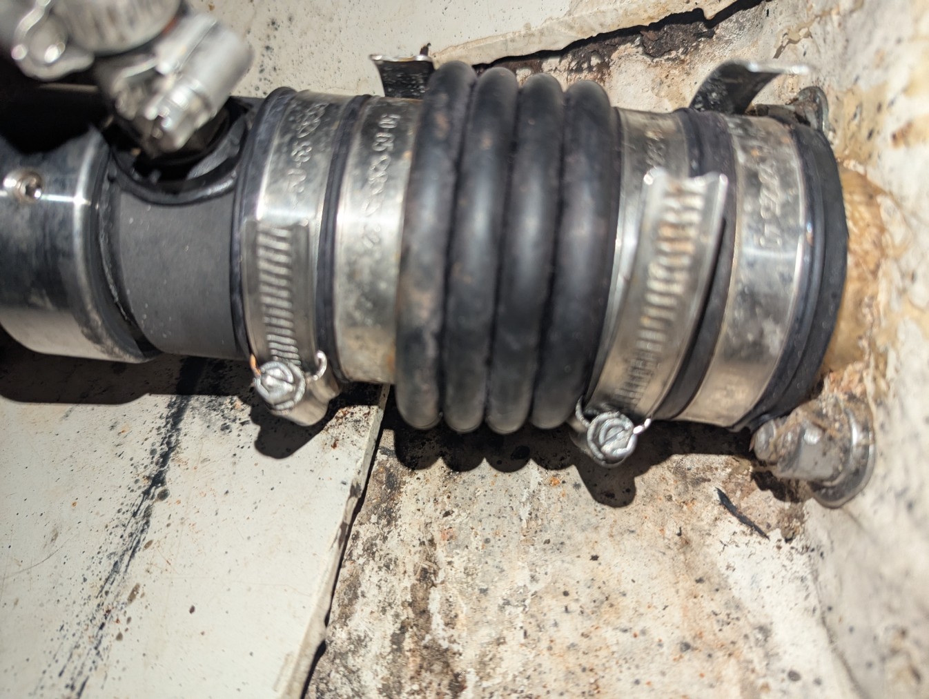

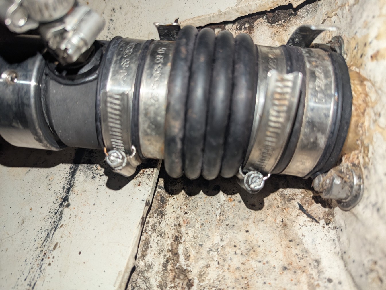

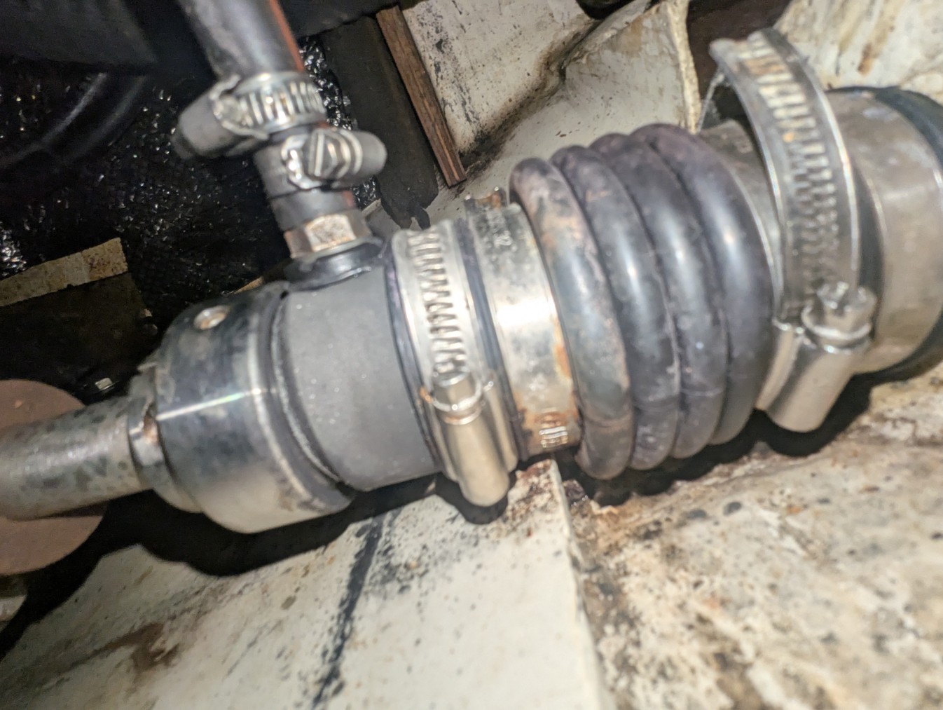

Is it just me? That shaft seal looks WAY too compressed. I have never seen a properly compressed bellows all scrunched up like that. I wonder if the black carbon splashing is from too much pressure between the carbon stator and the stainless collar? It almost looks like the forward clamp nearest the bellows is in danger of wearing into the rubber of the bellows. I know the PSS has a bit of a gap there when normally compressed, but as that bellows ages I would worry it may push/fold forward and start to make contact that forward clamp. Hard to tell from the pics but the bellows are clearly distorted and in one pic it looks like the edge of the clamp is already making contact with the rubber of the bellows.

Is it just me? That shaft seal looks WAY too compressed. I have never seen a properly compressed bellows all scrunched up like that. I wonder if the black carbon splashing is from too much pressure between the carbon stator and the stainless collar? It almost looks like the forward clamp nearest the bellows is in danger of wearing into the rubber of the bellows. I know the PSS has a bit of a gap there when normally compressed, but as that bellows ages I would worry it may push/fold forward and start to make contact with that forward clamp. Hard to tell from the pics but the bellows are clearly distorted and in one pic it looks like the edge of the clamp is already making contact with the rubber of the bellows.
That’s an interesting observation. Some folks were saying earlier that it wasn’t quite compressed enough, so I’d love to hear more opinions about whether my bellows is compressed properly. I’ve uploaded some more detailed images and I’ll try to attach them in this post as well so people can see. So far, when the engine is just spinning at the dock — not at high RPM and not with much water motion — I haven’t noticed any water, which leads me to believe this might be related to the air vent and water running up when I’m in reverse or something like that. But I definitely want this PSS seal to last and stay in great condition, since it’s relatively new and I’m trying to treat my boat carefully.
I think they might have been thinking if its dripping then this is usually the case, that the seal is under compressed, however i think maybe those comments might have been made generally and without considering the pictures first? I'm not sure, maybe someone will confirm. When mine is properly compressed, I can still clearly see all the low channels/folds of the bellows. I would send a photo and email to PSS maybe and ask them their opinion. I have only had two of them so could be perfectly normal the way yours is compressed. I'm looking at pics on google and see other boats look similar so maybe fine. It might be my boat for whatever reason does not require highly compressed seal.
