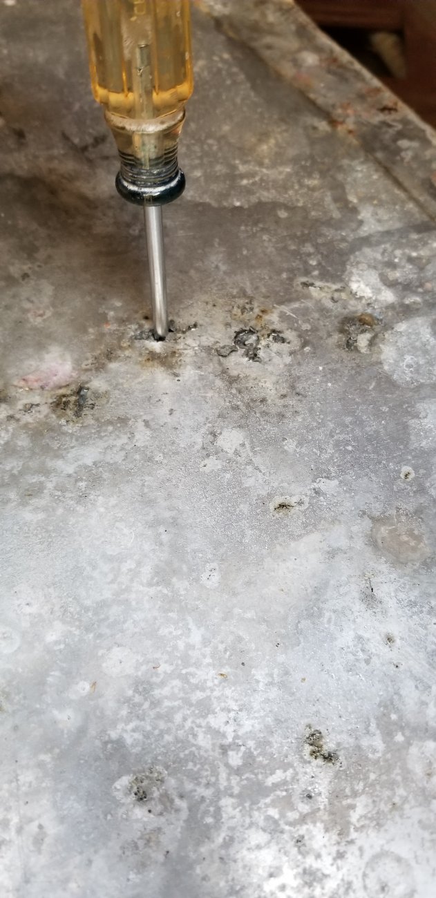

Found a leak in the plastic pipe connecting to the tank. Replaced the pipe and then found a leak under the tank. Had to cut the sleeping platform board to get the tank out. Found a pen size hole. I repaired it but wondering now if I should get rid of this metal tank for a plastic tank. Any advice?

Many thanks for your replies. I still have the tank and will be going there after work to check on my patch job. It its sealed, I will put it back in for use. If the leak persists, I will get rid of it and purchase a new one. Funds are a little tight at this time so I hope the patch worked. I bought 2 bands from HD to secure it back. Have to cut a new board for sleeping and I have to figure a way to brace the sides since I had to cut out the foam to get the tank out.

A quiet update. No leaks. After sanding the entire area of the bottom aluminum tank, I used JB Weld Steel to seal the hole and and other cracks apparent. The trick part was getting the tank back in place, snug and the berth board reinstalled. Many thanks to all of you for helping me through this. Next topic will be my jib sheet. See ya.

You may be able to patch it for a while, but that tanks looks a bit “rotten” around the area you patched.
I would consider replacing it, preferably at your next layup if you park the boat for the winter…that way you can enjoy sailing in the summer :)
