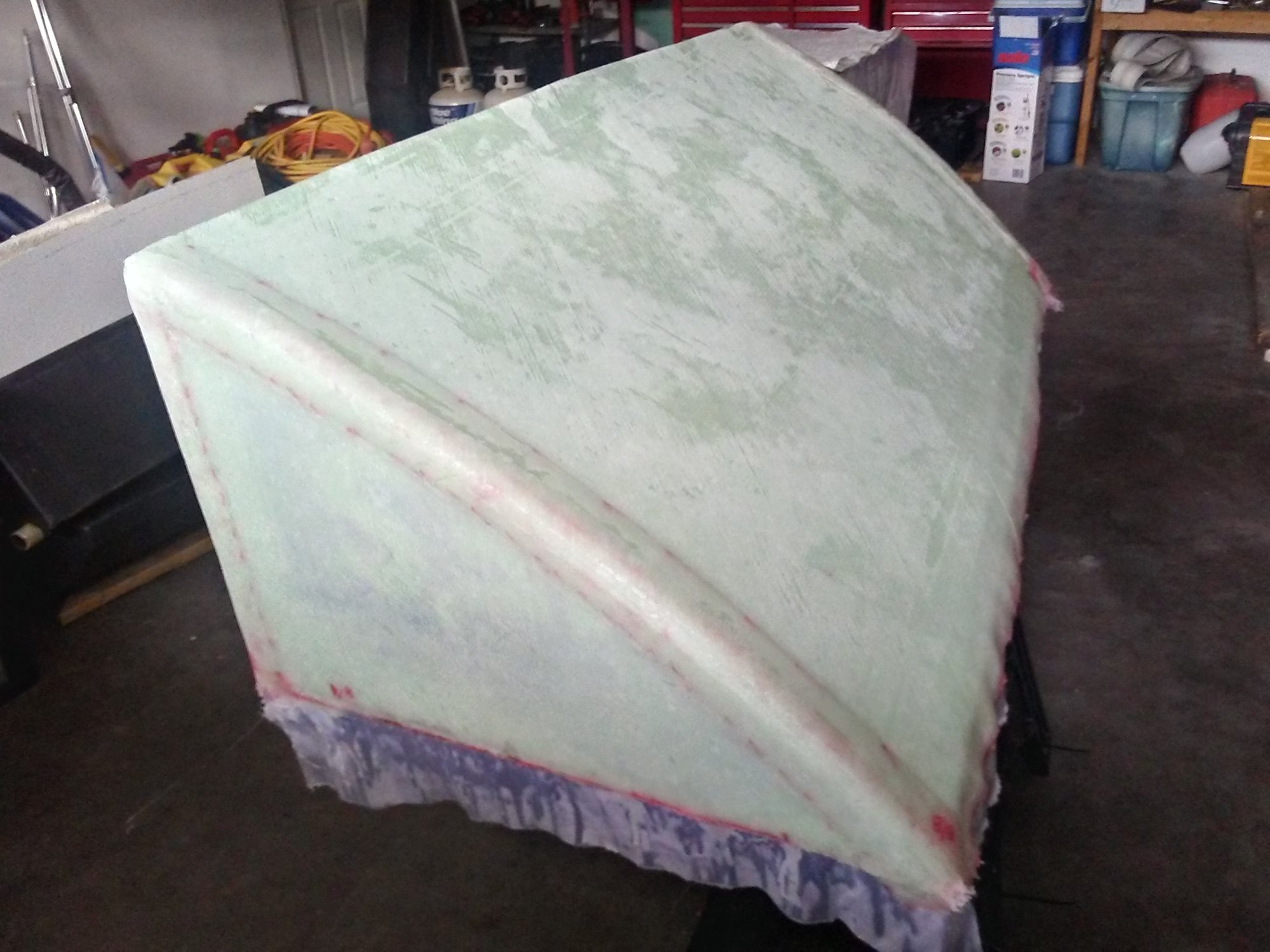

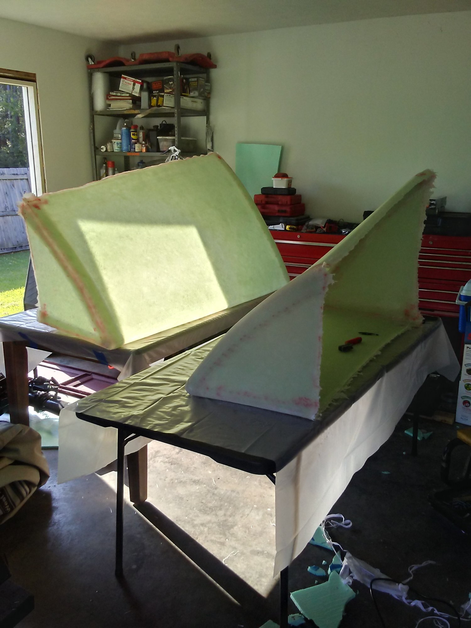

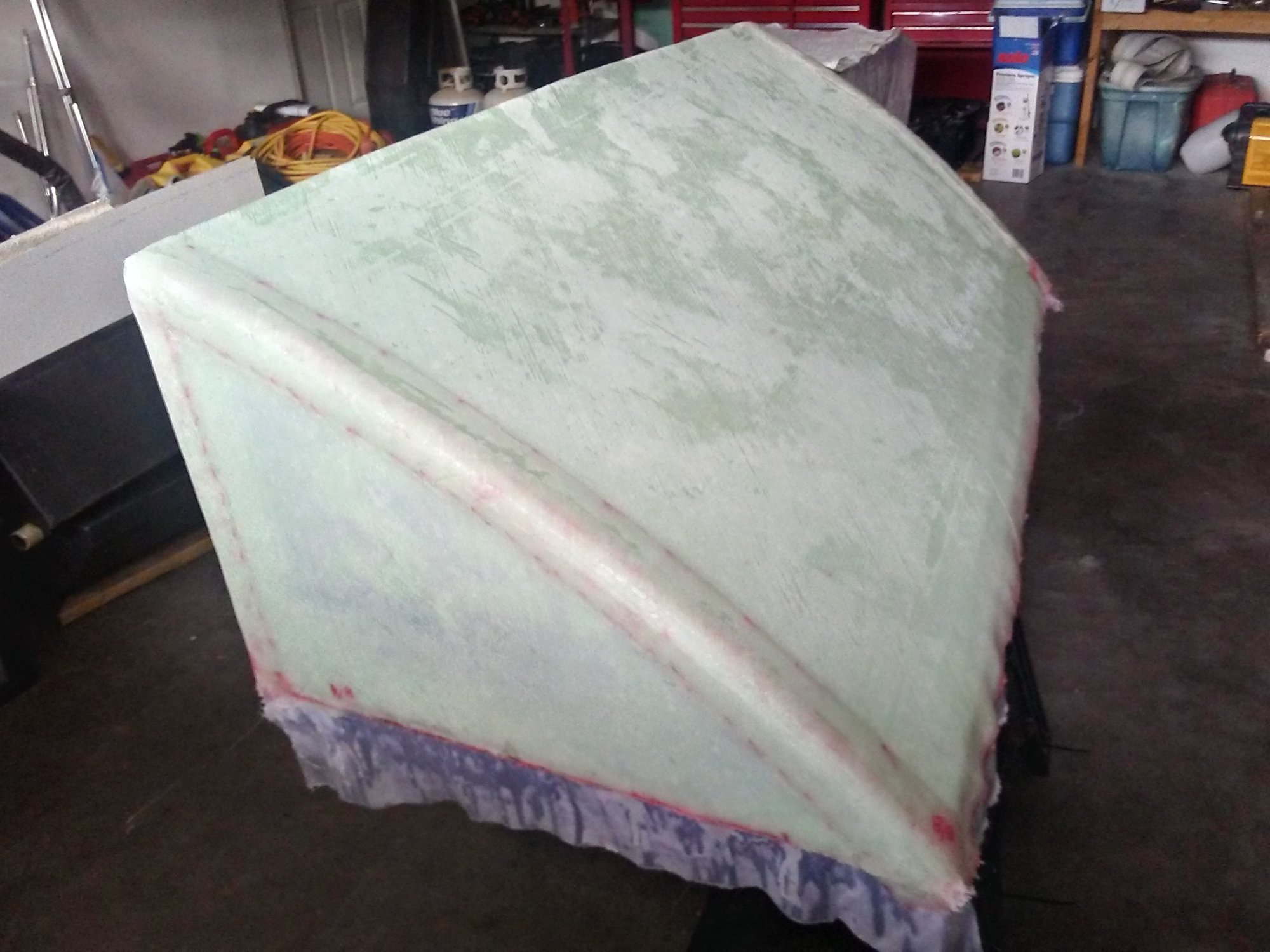

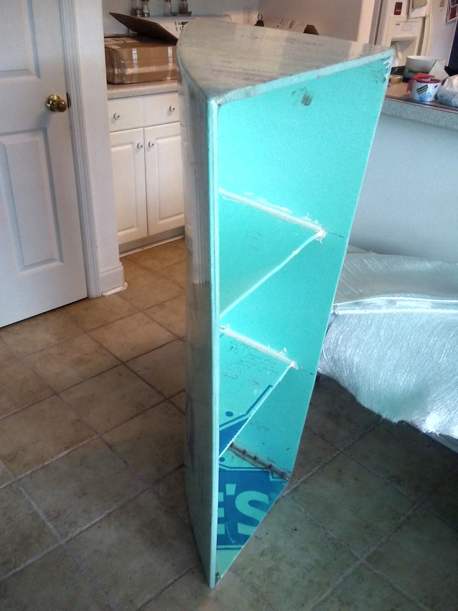

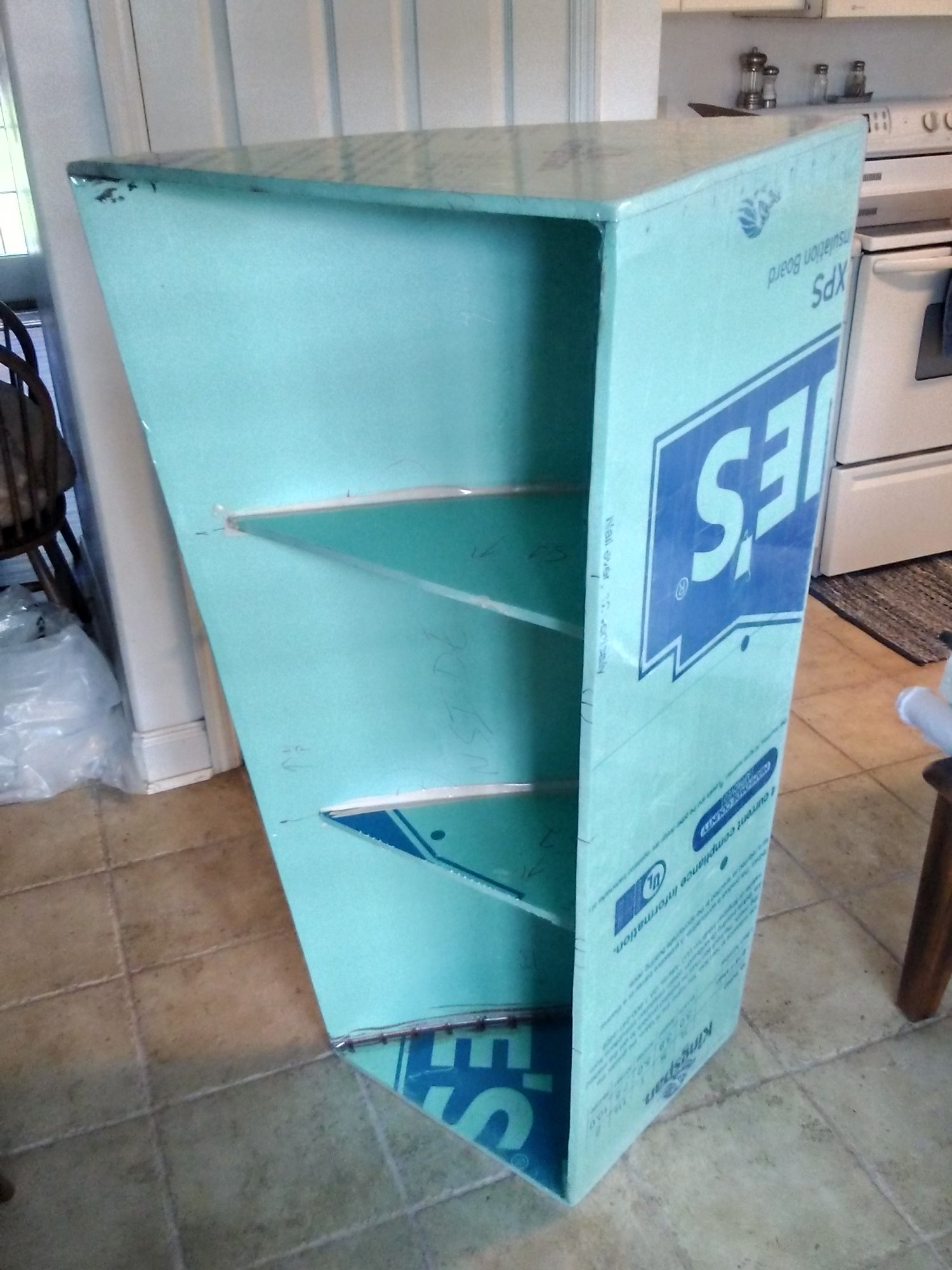

I realize this post was made some time ago now but I thought that I would update with my progress. I decided against making the tanks the exact same size since there seemed to be a reasonable amount of wasted space that could be used. I made templates out of XPS insulation foam from Lowe's to fit under the settees to use up as much of the space as possible. I made the templates using the stitch and glue method. I used those templates as moulds to fiberglass over. If my calculations are correct I am gaining 10 gallons total per tank just by following the curvature of the hull basically. I still need to make the baffles and the tops and also install the fittings before they are ready to be tabbed in. So far I am happy with the way these have turned out. I did get a quote for custom-made poly tanks that was close to $3,000 NOT including the shipping. When it is all said and done I will have less than $2,000 in these tanks and have a finished product that can easily be repaired if need be. They are made with 5 layers of 1708 biaxial cloth using epoxy. I am also coating the inside of them with an NSF 61 approved epoxy coating. NSF-61 is the government's approval rating for potable water.
