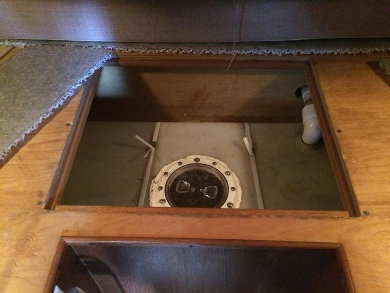

Did you cut your own access panel to the water tank?
Ken, I need to access my water tank gauge sending unit on our 2007 H-31. Did you cut the access in the V berth above the tank yourself? I can find no way into my tank without cutting an access panel like yours.
