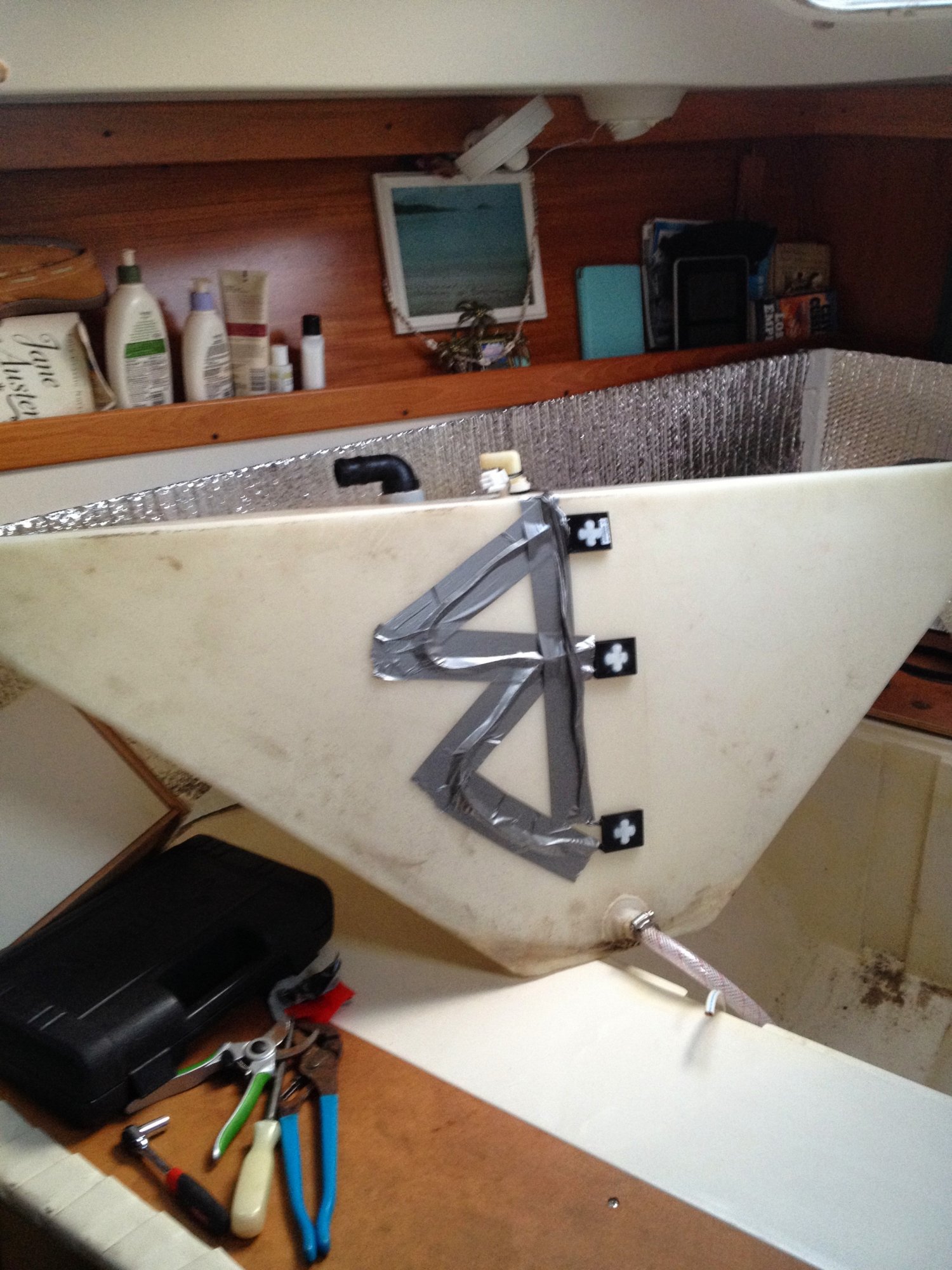

I'm working on installing a tank sensor system for the fresh and black water tanks, using a Level Guard SensaTank Marine 100 (Tank Level Monitor » Trionic Corp.). Access to the waste tank was pretty easy, but the fresh water is not so simple. It looks like I'll need to empty the tank, remove the outlet hose at the bottom, and pull it out of the space it's sitting in to be able to attach the sensors to the outside of the tank. Has anyone done that? Any tips?
I'll also replace that outlet hose at the same time, while I'm there.
The instructions for the sensors say to only use isopropyl alcohol for cleaning the tank before sticking them on. Seems like an odd solvent. Any tips for being sure they don't come loose? Although there may be enough bulge in the tank that they will be pressed tight against the walls.
Here's a picture looking up from behind the drawers.

As others have said, drain and remove the tank. For ease in dealing with the hose, open up the bilge and cut the water hose at an easy to reach point. Then you can just pull out the tank and put it up on the bed platform. At least replace the short , probably 3-4 foot, section of hose from the tank to the cut and the hose clamp. After you put the tank back you can join the two sections with a brass T with a ball valve on the offset side of the T. Now you can drain your tank into the bilge. This is good for winterizing, just drain the tank and never put antifreeze in it. Or for cleaning the tank or the bilge.

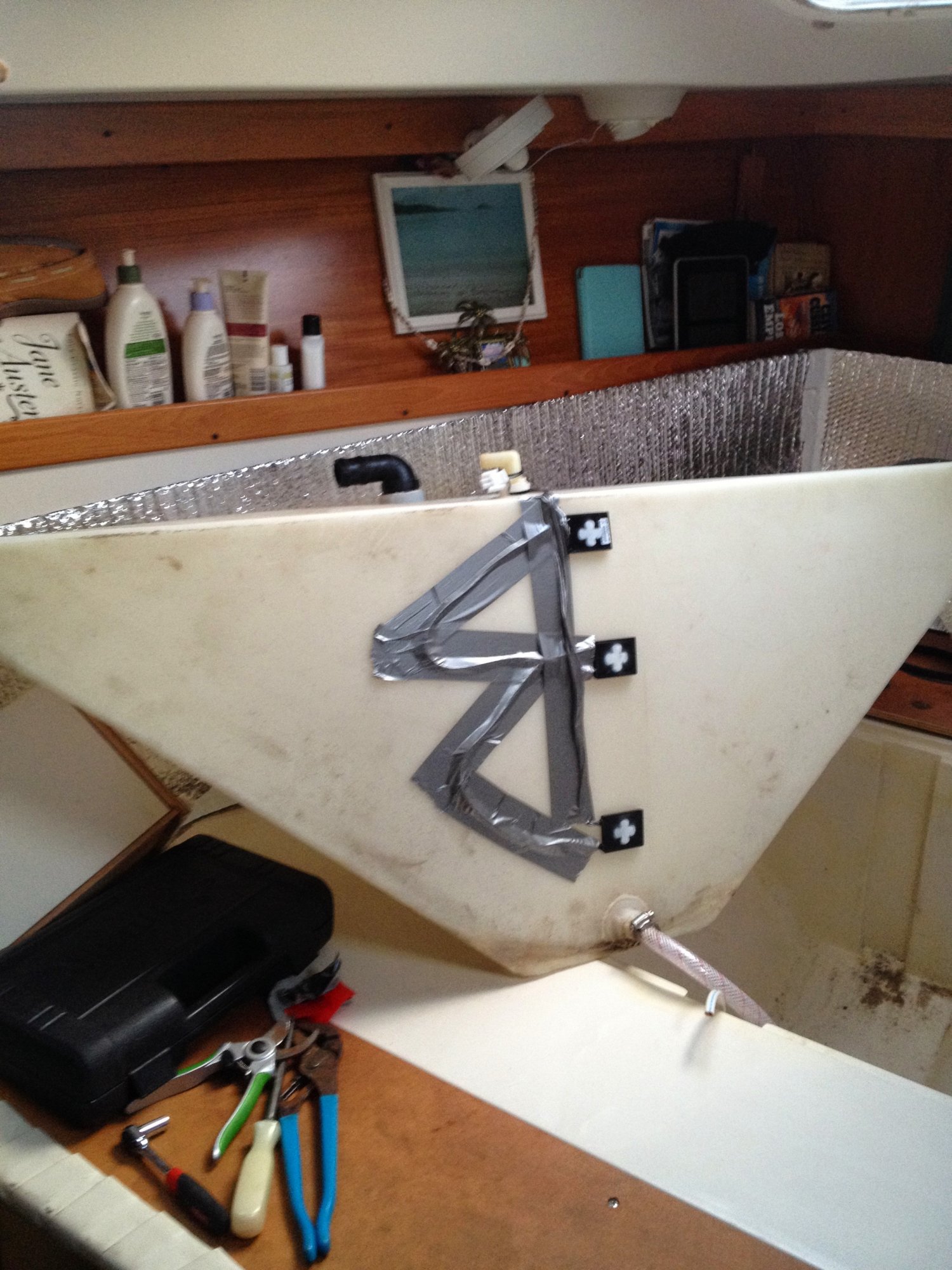

Here are my 3 sensor locations. I didn't take the time to fill the tank and mark it. So these were guesses. The top two are a little low. My system measures in thirds of the tank.
Rubbing alcohol is the correct solvent. You want a clean surface and the alcohol will evaporate and leave very little residual.

Looks like you pulled the cabinets out. Unfortunately that doesn’t give any access to the tank, except the bottom fitting.
