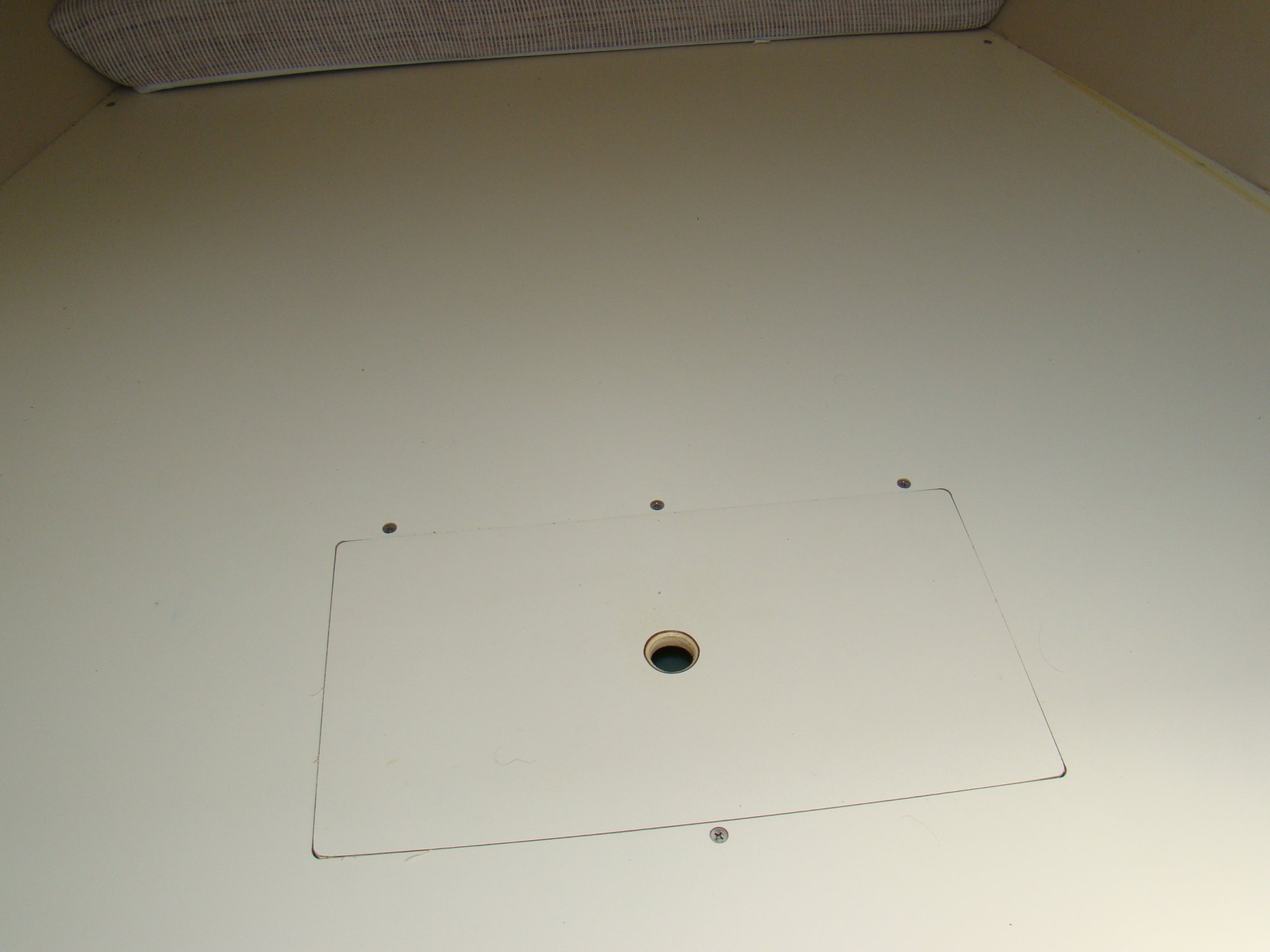

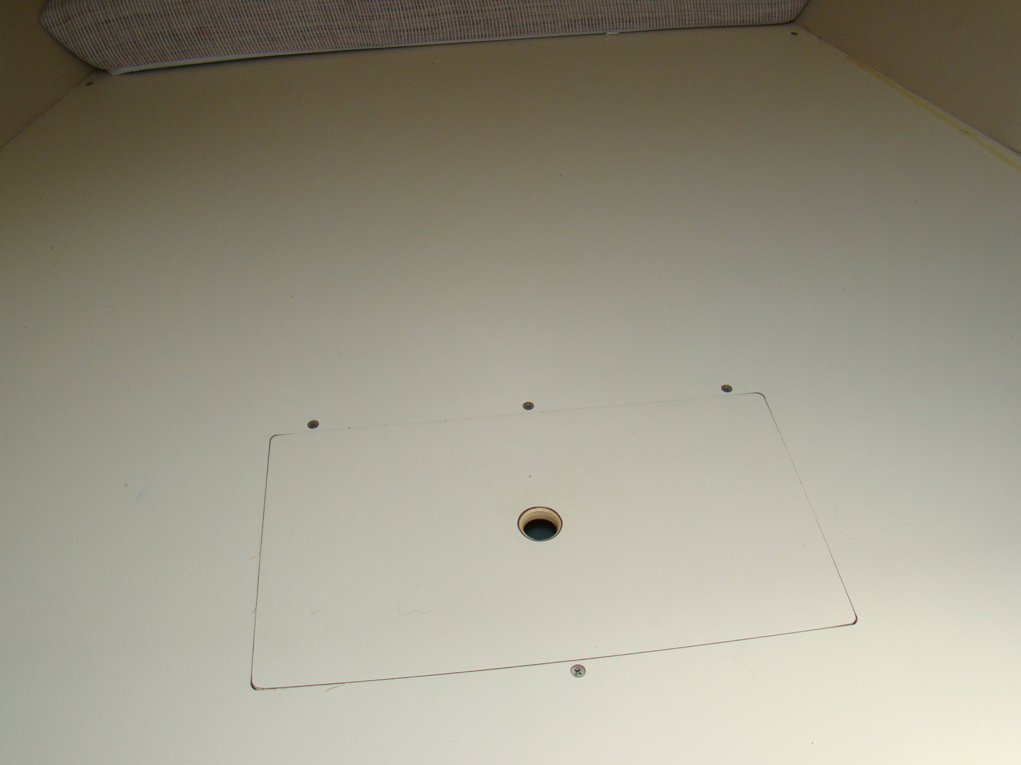

On my Hunter 1994 37.5 the water tank is under the V-berth, same as you I think. There is a small access hatch and you can unscrew the whole top panel.
I have made new access hatches using a palm router to cut the hole. I used the router to only cut as deep as the panel material.

The hatch in my picture is original. I've made new access hatches for the quarter berth in this boat and to access the hot water heater in my old 1990 Hunter 30G. I used a router to make the hole and made a new cover from plywood. I used the router so that I'd have a clean cut, rounded corners, and wouldn't cut anything underneath - that was important for the water heater. I think I used a 1/4" straight bit.
