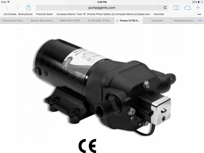

I have a Series 31750 - Sensor Max VSD Jabsco Pump. This morning it began to intermittently trip the DC 12 V circuit breaker off. I have rewired the pump, tracked the wires, and checked for leaks. It continues to do this. Is it common that it is a problem within the pump? In between circuit tripping it works fine. Sometimes it takes half an hour, sometimes it does it in a series of trips. The fuse at the pump is ok.

New information, the pump turns on for no explicable reason and then runs for several seconds until the circuit breaker trips. I think it is a problem with the pump. What do you guys say?

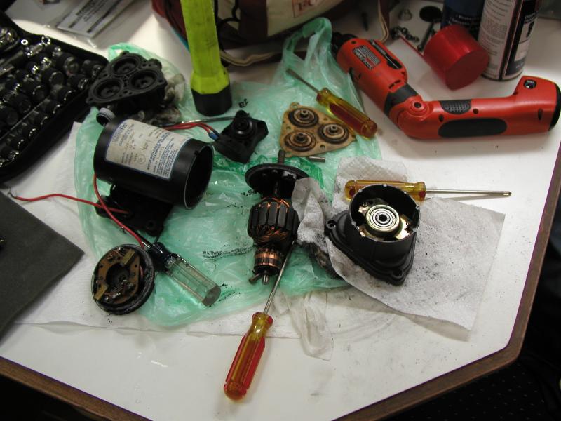

I installed one of the ShurFlow Smart Sensor variable speed pumps back in '08. nothing but good to say about it at this point. I like the quiet . I didn't know about reliability issues when I bought it but figured that a simple on/off pressure switch would be more reliable than an electronic control. I figured that if the electronics failed, I could simply bypass the electronics and hot wire to the panel switch. That would let me get water until I could get it fixed. I would guess that the VS control probably could be replaced with a plain old pressure switch if necessary. (pumping head and sensor housing attachments probably same as non-VSD version) I figured they must have been having reliability issues since I didn't see splashy (!) advertisements for the variables .. My old Shurflow had lasted 23 years. It failed because a drooling leak had wet the wobble plate bearing and failed it. If the owner (me) had been more vigilant, that old fella would still be running.
EDIT: picture of old failed ShurFlo. Motor was still fine.. brushes and commutator were a bit worn, but had plenty life left. You can see the rust from the failed bearing on the pumping diaphragm in the top right of the picture.. An excellent, well made old pump.
