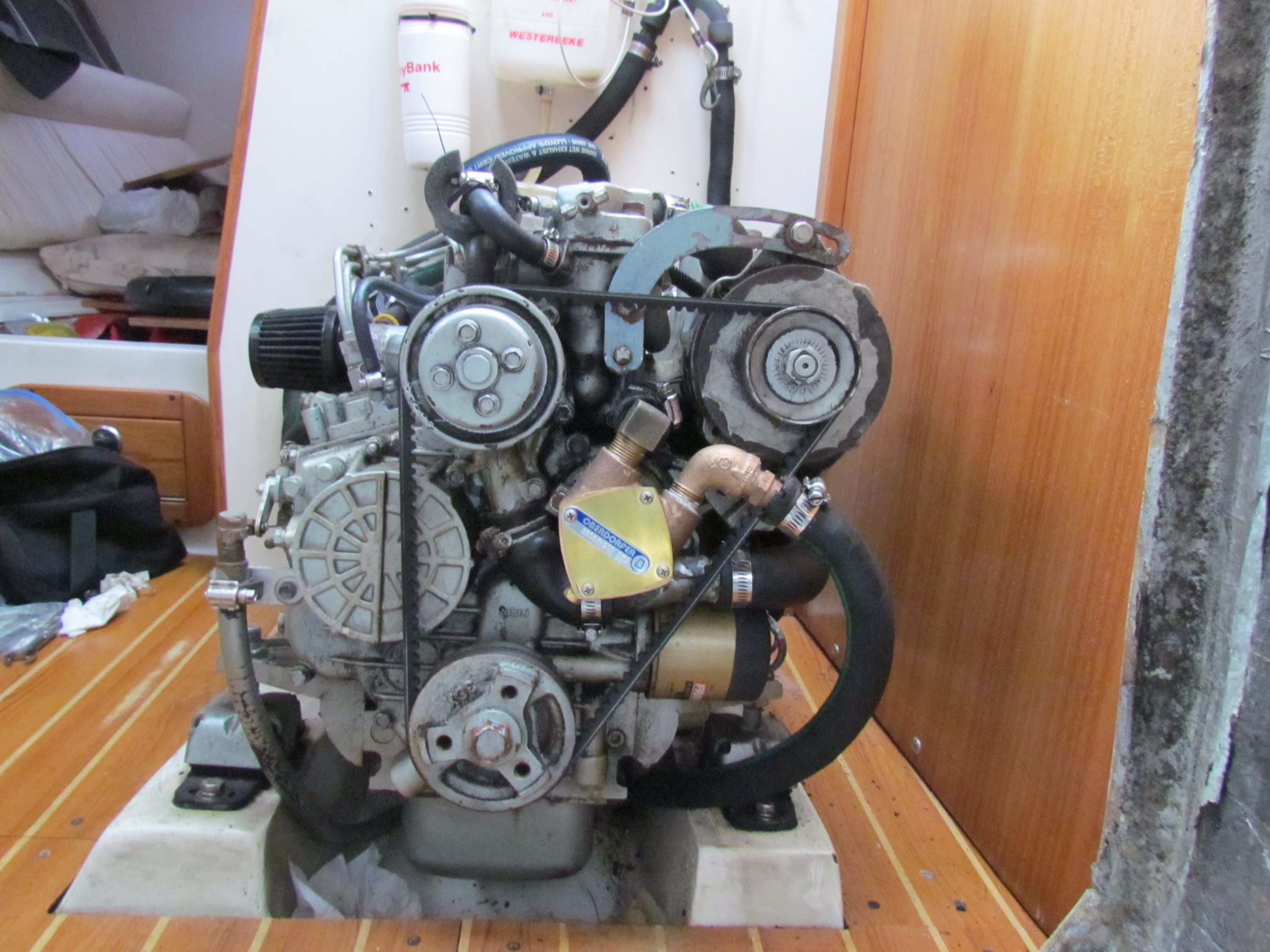

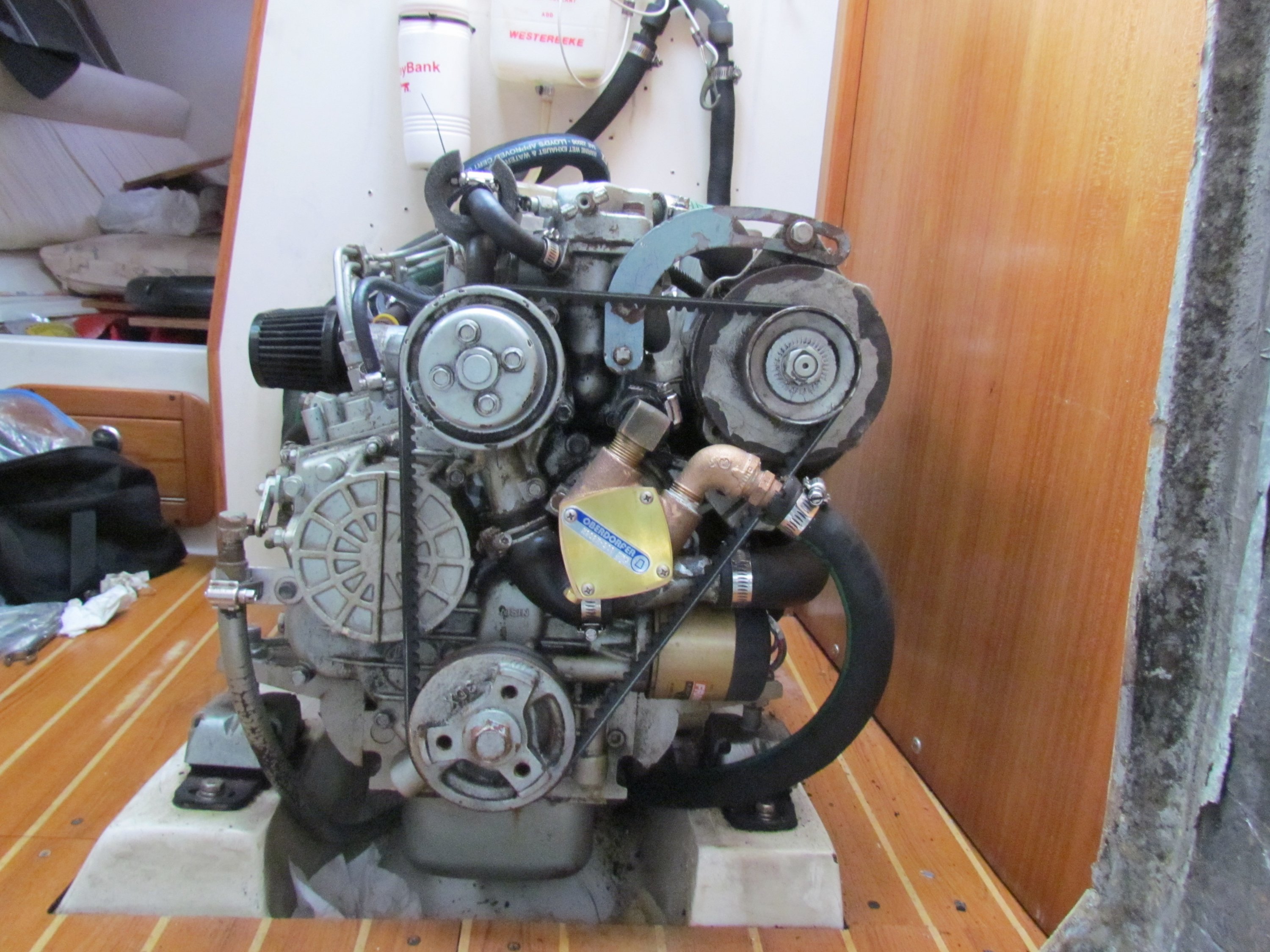

I just ordered the OBERDORFER, as my wifes XMAS present and it will arrive Monday , from Marine Parts source,Boy will she be surprised!

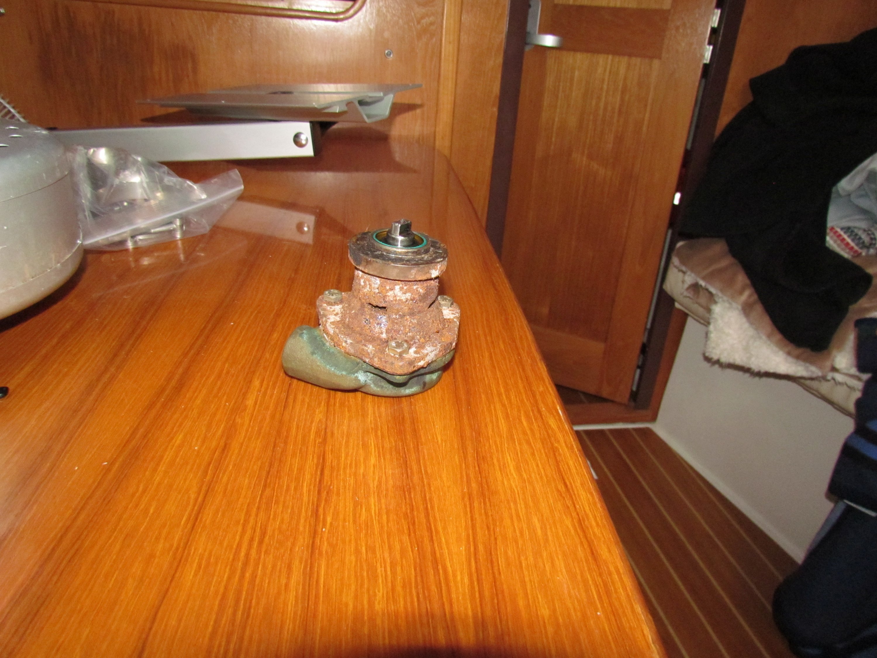

NOW, What did you do with your Sherwood?

I hope she gives me at least the Manson Supreme back I gave her for our anniversary one year.... :)
After 44 years that's the least I could hope for.
Paul, The Sherwood offsets the interior just nice. Great centerpiece accent! Better than boat Ivy!
The person I spoke with at Marine parts was very friendly and knowledgable, the pump arrived in two days with free shipping. I got the gasket also, but do I need anything else? It will be an unbolt than bolt?
Can I use an extra impeller I had for the Sherwood as an extra for the Oberdorfer?

We were glad we did the replacement....
