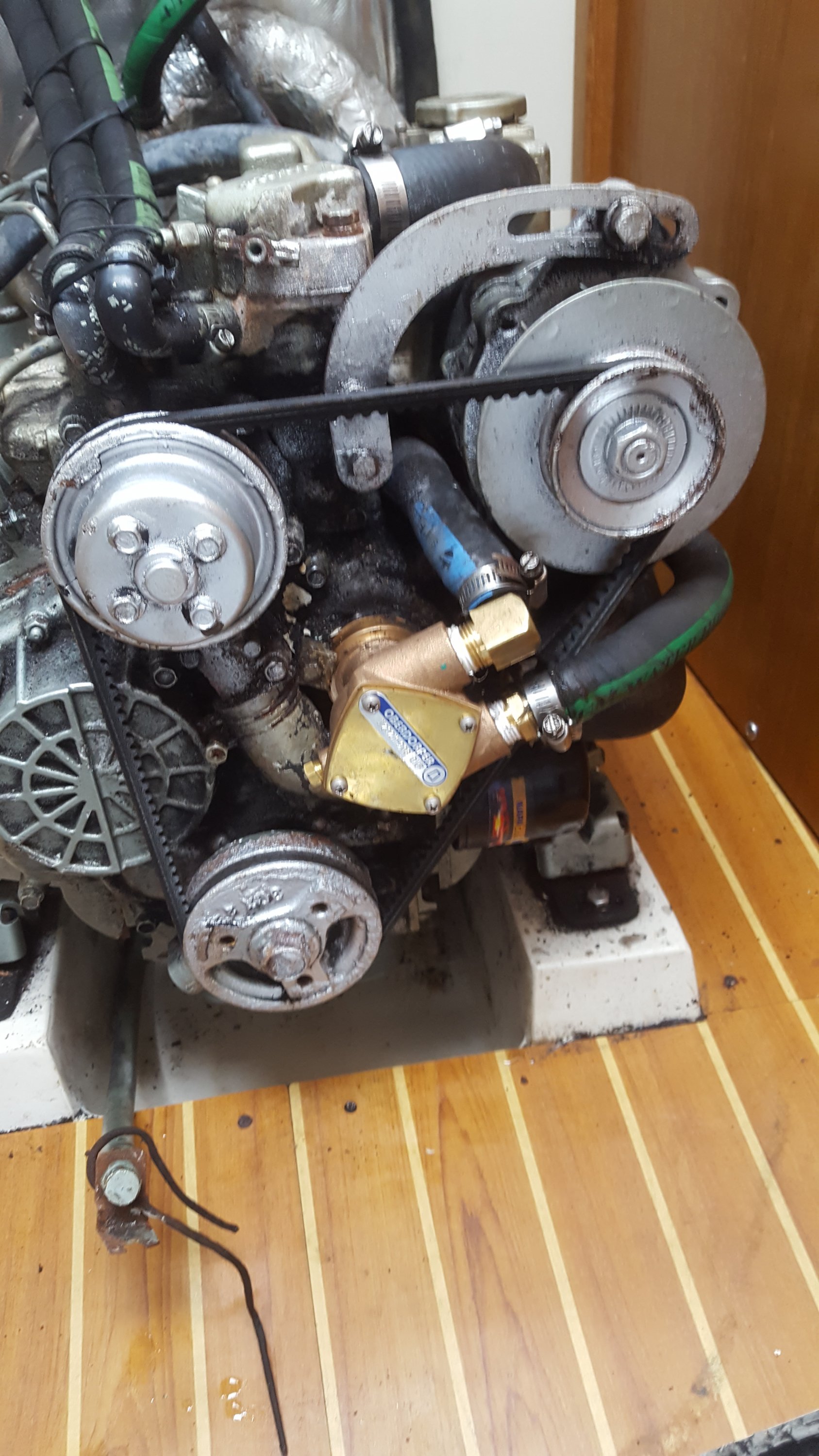

The person I spoke with at Marine parts was very friendly and knowledgable, the pump arrived in two days with free shipping. I got the gasket also, but do I need anything else? It will be an unbolt than bolt?
Can I use an extra impeller I had for the Sherwood as an extra for the Oberdorfer?

So it seems the Sherwood pump is not well liked? Is it because of the process to change the impeller or other issues? Seems like they are supposed to move more water?

The Oberdorfer I purchased from Catalina Direct had two bad cracks in it. It cost me additional freight and lengthy time to have it replaced by them. Meanwhile, however, Oberdorfer came good and sent me a new pump free of charge virtually overnight. That pump has now been running for almost 3 years (about 300 hrs) trouble free. That, plus Oberdorfer’s prompt service speaks for choosing their pumps.

Jesse or Stu may weigh in on this but if you search water pumps above you may get alot of information but from my understanding the sherwood has a history of being faulty and the impeller is hugely easier to change with the oberdorfer, which is supposed to be more reliable also.

Everything is ordered, she'll get a new pump before spring launch. I was gonna replace the impeller anyhow, now I'll just replace the pump instead ;-)

Alan is correct, there have been reliablity issues with the Sherwood. Mine needed to be rebuilt after under 400 hours. And they fail with less hours after the rebuild. My Oberdorfer has over 1,200 hours and only thing I have done was the lipseals which I did with minimal resistance in an anchorage.
But really, it's the impeller. I can't imagine changing that impeller in a busy area while under stress.

Why SHERWOOD Raw Water Pumps leave a LOT to be desired: See reply #7 here: http://c34.org/bbs/index.php/topic,8493.0.html
