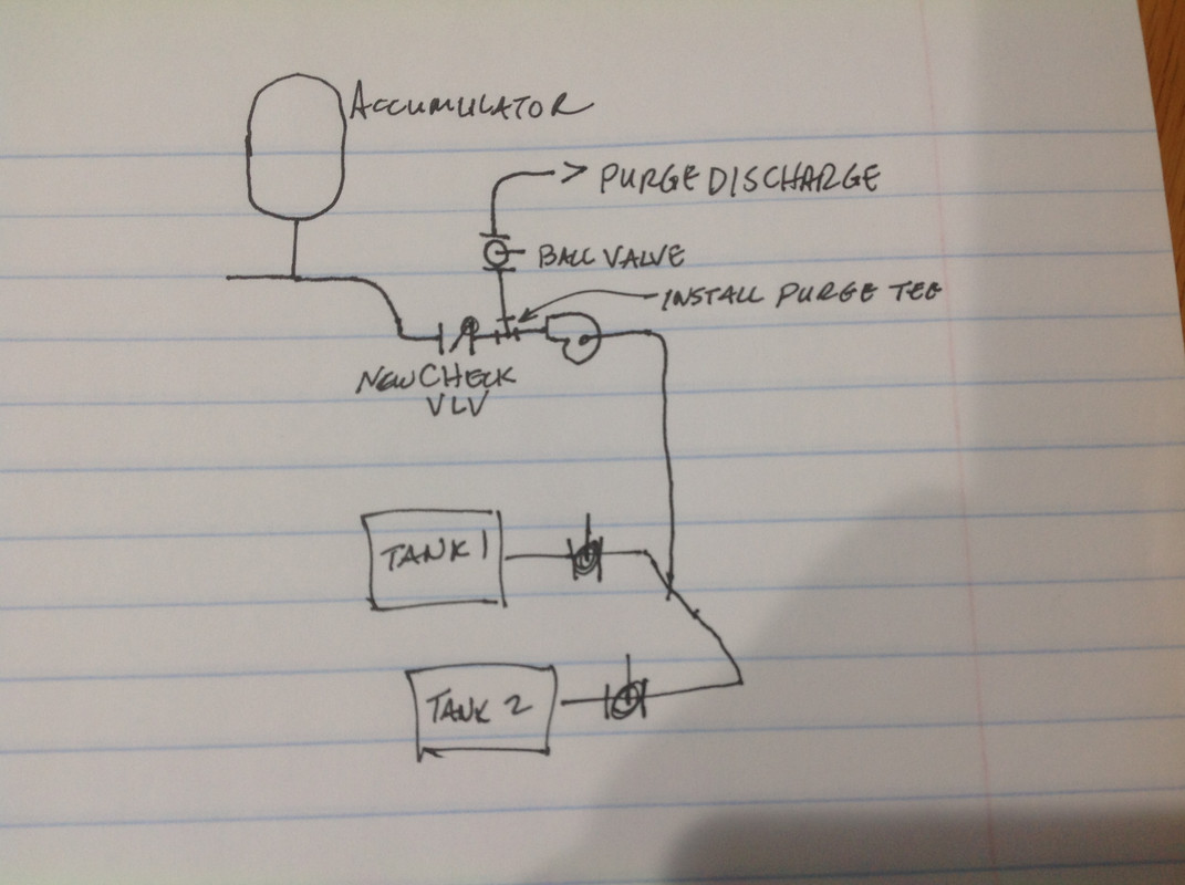

Certainly worth a try!
The way I was thinking you would waste virtually no water, but automatic is better.

You will likely put the tee in for the auto bleed anyway.
Good luck! Hope the auto bleed gets it.

Right, but the one I'm showing keeps you from bleeding the accumulator while purging the air.
Not necessary for the auto bleed.
Good point, but I've found when I bleed this by unscrewing fittings it fixes itself almost immediately. Then again, when I unscrew the fitting I first shut the accumulator valve (isolate the accumulator).

That would work almost as well as the check valve. The check would just prevent system drain back too.

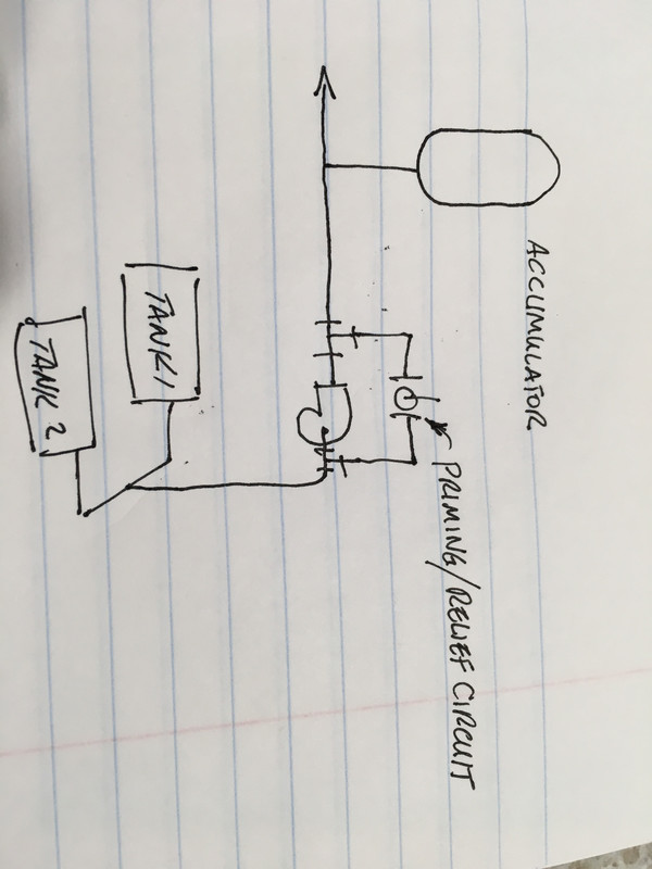

Had one more suggestion to throw in the soup. A valve bypass allowing you to dump the accumulator charge back to the suction line/tanks. Eliminates wasting water during purge, and should allow pump to prime.

Thank you. That's a good idea, too. I think I'm going to try the air vent first. Then, I was thinking, I'd like a garden hose bib in that locker, for times I want to rinse stuff with fresh water; it would serve the dual purpose of being a vent when this stuff happens.
