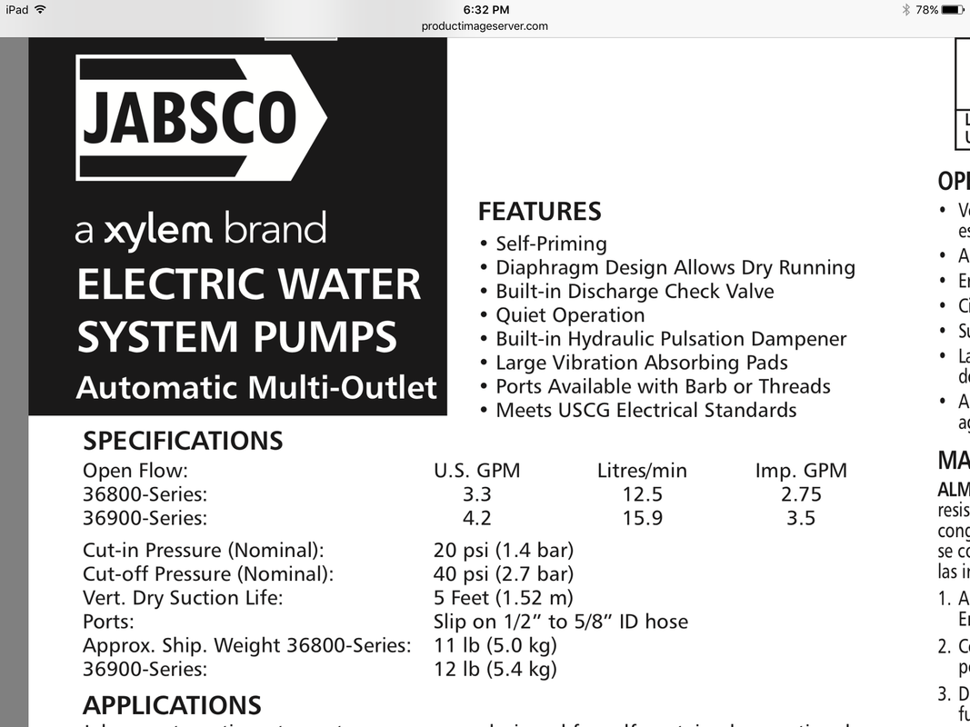

One last thought. Could you have a fitting/component in the suction line that's leaking air under vacuum?
The Jabsco pump with that model number has a dry suction lift limit of 5 ft. The pump simply may not do it in the current configuration.
Yes, but...it works fabulously well when it's working, and once I bleed the output side when it does this bad thing.

Vert. Dry Suction lift 5 ft.
In the lab, the pump could only suck water up 5 ft through a dry tube. You indicated around 4 ft. You're close to the limit of pump operation.
