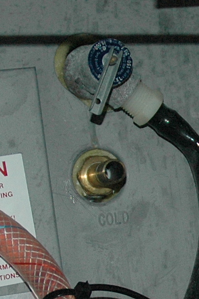

#1 This was a BRAND NEW vessel in 2005 in which I had already double checked each and every single hose clamp. I checked, and had tightened, many clamps from the factory on the engine, seacock system and domestic water INCLUDING the one that let go.
#2 Catalina, as do many builders, used nylon reinforced PVC hose. This hose has a MAX working temperature of 150 degrees F! This is a dirty little secret that many builders and boat owners have no clue can lead to a bad situation.
#3 The thermostat operating temperature on the Universal diesel engine is significantly higher than 150 degrees F! This, in and of itself, is a gross mismatch in application and is NOT a matter that should be "serious maintenance" by anyone purchasing a brand new vessel. The cold supply and the hot return for the domestic side of the water heater was 150F hose. The engine ran at about 170 degrees. On a long motor you can literally see the temperature in the tank exceed what this hose is rated for! I personally measured 165 degree tap water on this particular boat after a 4 hour run with my infrared thermometer. 150 degree rated hose and 165 degree water running through it...:doh:Catalina is NOT the only builder to use this 150 degree rated hose on an unregulated engine heated water heater..
#4 Catalina used smooth non-barbed hose fittings on the hot water heater. This fitting had NO barbs and nothing to grip the hose. Again, I tightened or checked all my hose clamps before sea trial and it was next impossible to tell by looking through this hose that non-barbed fittings were used. It should not be the job of a new boat owner to remove and check each and every fitting before launch. This leak was the fault of the builder not my lack of maintenance.

No barbs from the factory & 150F hose:

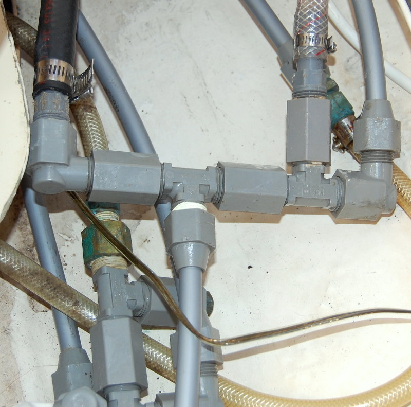

Peggy nailed it. I always look for heater hose leaks or water heater failure when I get these cycle things going on. And, in my boat, I have three times had the hot feed line to the exterior shower head come loose causing cycling, and a wet false bilge.
Really interesting you said that Rick. The same thing has happened to me same location, twice. Seems like a trend. As we were hooked up to shore water one of the times, it could have been a disaster but I was onboard fortunately at the time

This may not be a coincidence. If that is the highest point in the system hot water, REALLY hot water, may be gravity feeding from the water heater and softening the hose enough for it to lose its grip on the fitting. If there is room on that barb you might try to double clamp it? Just a thought..

Maine, you are correct that it is the highest hot water fitting. However, it's a Quest fitting. Unlike the other connections which are quest to brass, this is Quest to plastic which I think is part of the issue just as you explained it. BTW, where can you buy Quest fittings now???

Polybutylene
Some RV places still have them. Be aware that Quest Pex in gray, as found in Home Centers is not the same fitting or pipe as the older Quest Polybutylene.
I'm guessing these were the infamous nation wide class action law suit Quest Polybutylene pipe & fittings? Correct?? Nearly all of these original Quest fittings will eventually leak as they did in millions of house holds. You can replce them piece meal or convert the system to PEX..
This stuff is bad news!! If you have this definitely turn off your pump.;);)

I think you can still find Quest fittings at most RV shops and Ace Hardware. They may be marketed under another name now.
I was under the impression that Quest stuff is still commonly used in RV's and boats. The problem with the Quest pipe was that it did NOT do well under "high" pressure like some may experience in a home.
