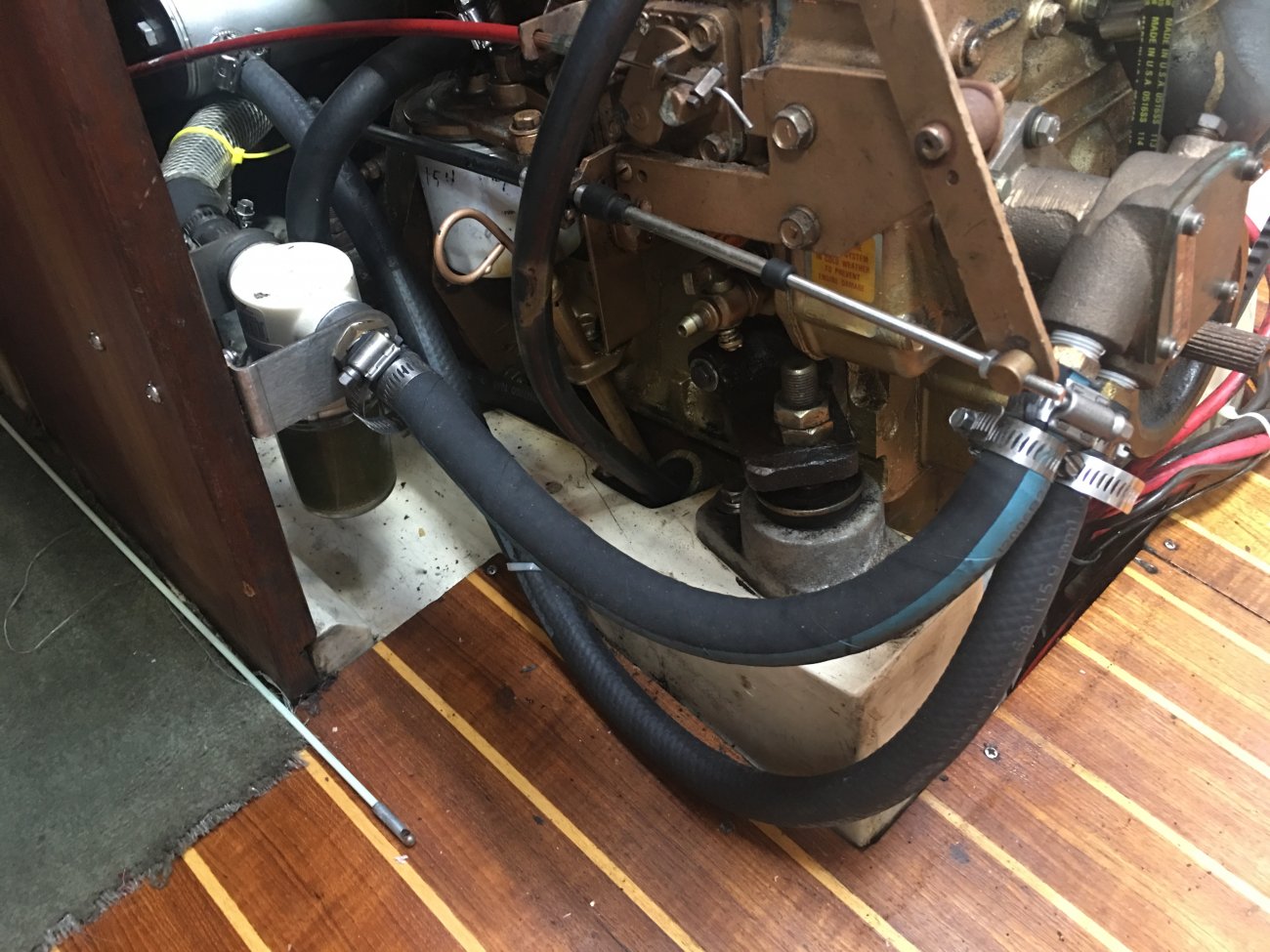

I'm running straight fittings on mine - actually better fit than the 90's. I also relocated the sea strainer so I could actually reach it, which is one reason the 90 works better.

Any pics? I would like to see that setup. I am considering a strainer and fuel filter change on my boat for better access and some other improvements.

Here you go. I wish I mounted the strainer another 1/2” higher so I could remove the basket when the filter is stuck to the top.
