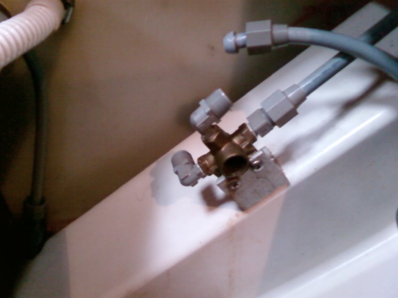

Had the same problem, Joe. I found the three-way selector valve had failed and was allowing air into the system from the empty aft tank. I pulled the valve and found that the coil spring inside had corroded and broken. Some bits of it had scored the plug that directs flow in the valve. I found a correct spring at Ace Hardware and a new o-ring for the shaft seal. I lapped out the plug so it correctly sealed again and it works as new again. The valve is common and can be purchased on this site or you can eliminate it and install two separate small PVC ball valves and a tee to better isolate the tanks.
EDIT: attached shot shows valve with top unscrewed and plug removed. Note the drool/corrosion on the mounting plate.. a sure sign that the o-ring is leaking a little.

Hey Everyone, thanks for all the advice. I think I got this and will be replacing the valve (same as the pictures from Kloudie and Claude) as well as checking all the fittings in the system. I do think the valve is at least part of faulty link causing my problem with the blasts of water. I still think it could also be the link to why the aft tank is filling up the forward tank. The only connection between the two tanks is that valve.
