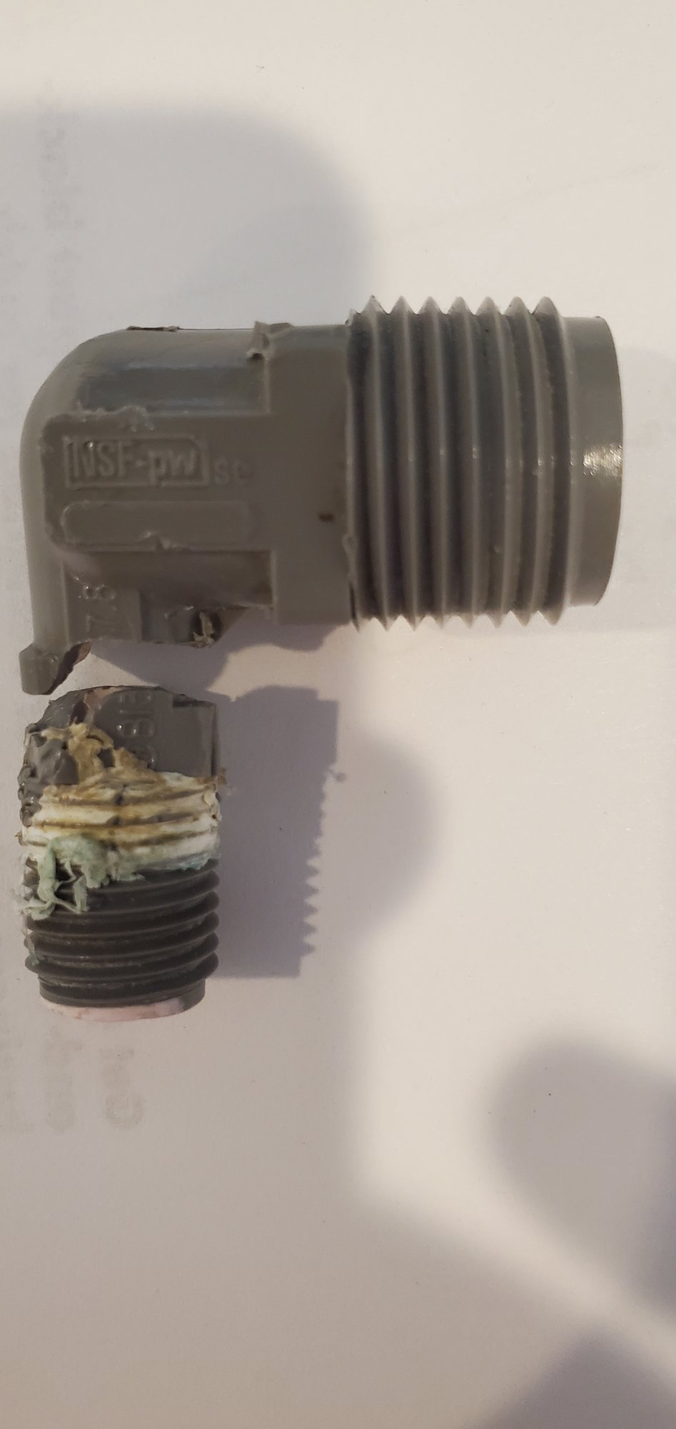

From my 1986 H34. Is there a common name for this 90 degree fitting? Are they still available. The only marking on the fitting is NSF-PW which is not identifying information. This was on the water line just prior to the fresh water tank. I'll assume it is an original connection.

Get that most local hardware stores or big box stores like Lowes and Menards, I would switch to brass so it don’t break again.

Yup , available at hardware stores. Male pipe thread on the bottom and a compression fitting for the tubing top right. Take it with you to match sizes.

Nope! Zurn Qest Pex fittings like shown by the OP have been out of production for several years. I have found no big box/hardware stores carrying the product and haven't for years. There are a few after-market sites and individuals that carry the product, but some try to gouge, so search around for the right source.
