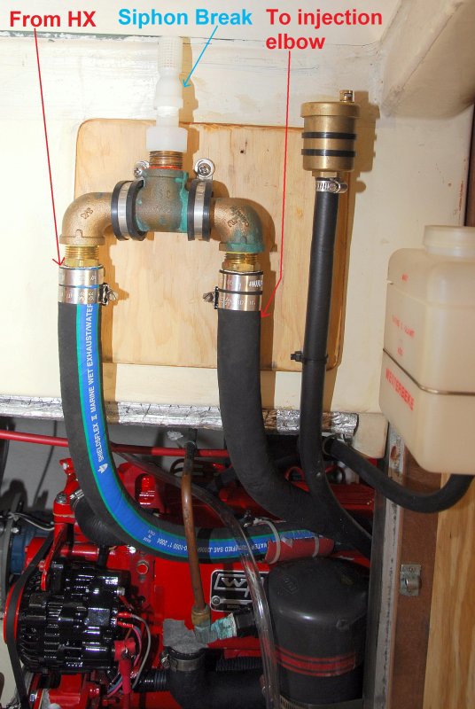

Yes it is possible. This is a siphon break, others may look slightly different. If you have one it may have become clogged and allowed a siphon and if you don't have one you might want to look into one.

thank you for the response and picture. I do not have an anti siphon. I will put one in. The engine cranks and runs. The power seems to have been compromised. Does this indicate a problem with the valves?
