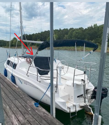

For years my H260 had water where you describe, it was rain water. It stopped when I installed a canvas cover over the hatch, both the sliding and the lifting parts. This is a known leak on the H260 and this cover was available in the store, On a side note. Filling the water tank presses down the bow and helps you point! I had an electric water pump to drain it completely for winter storage.
12,950
I got one of those covers from this site (SBO store). They are very nice and do what they are supposed to do. Here is a picture of one I snagged off the interweb. If you decide to get one (and I would) place a tennis ball about where I put the red arrow. That will let the water shed off during a rain.

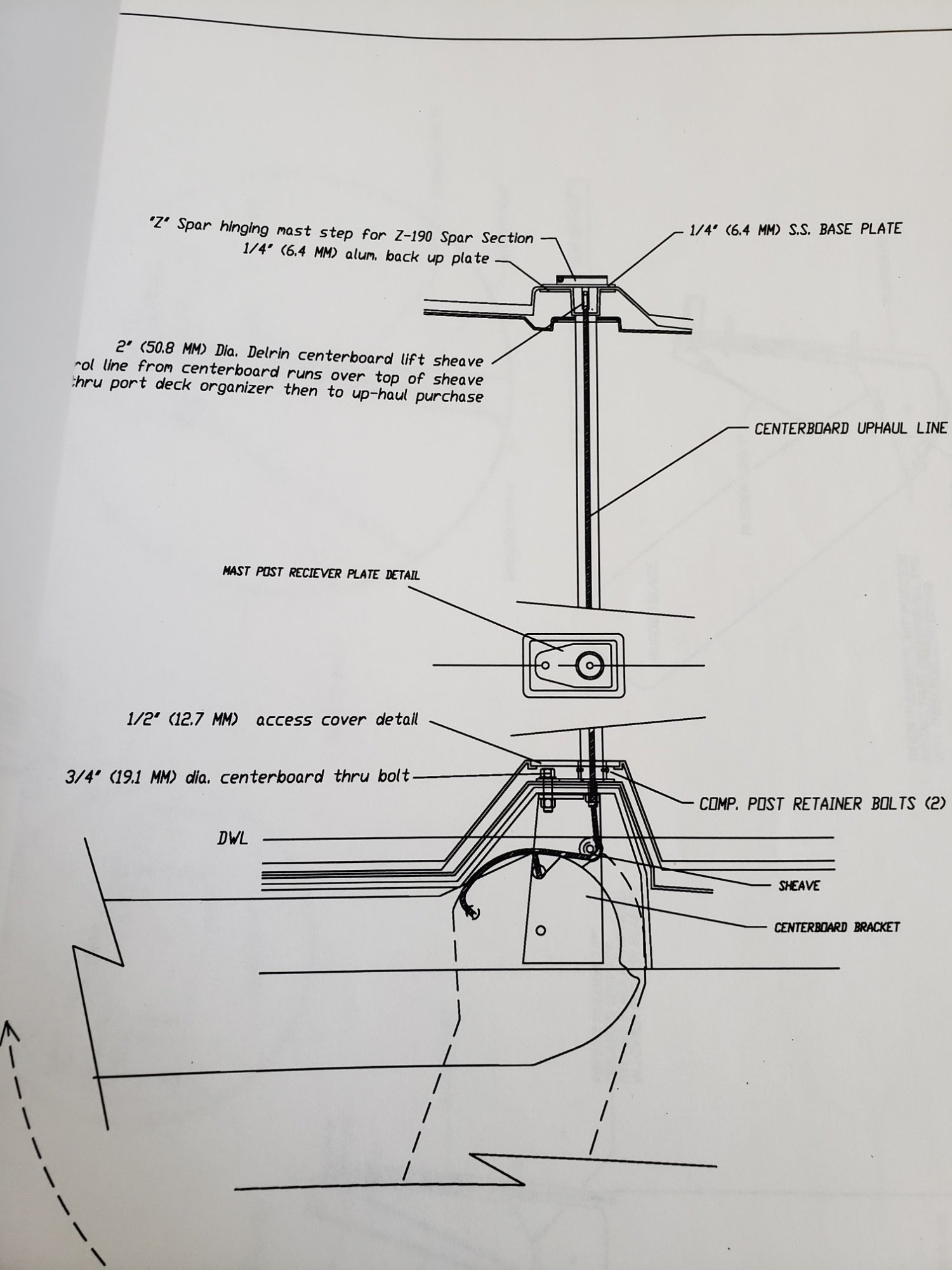

As I said earlier, after 19 years of having a dry boat I was surprised to find water under the sink and it appeared to migrating through the fibreglass floor. I was convinced that the floor was also the top of the ballast tank so the water must have been coming from there. Maybe I'm being paranoid since I've never had water in the boat before. You sea going sailors have it differently.
I've seen pictures of the mould for the tank and it appears that the top of the tank is the same as the galley cupboard floor. Based on BobSail's comments. Maybe not.
I took a look at the compression post. The attached picture shows the Bolt securely encased in sealant and no visible sign of water. Bob, when you tightened up the bolt did you find it in this condition? Do you recall if the nut below the bracket is captive welded to prevent it from turning?
I'm still trying to figure how water was dripping out around the centreboard pivot under the hull when I filled the ballast tank up to the level of vent hole below the companion way step. Does anyone know if there is a vent hole near to the forward end of the ballast tank?

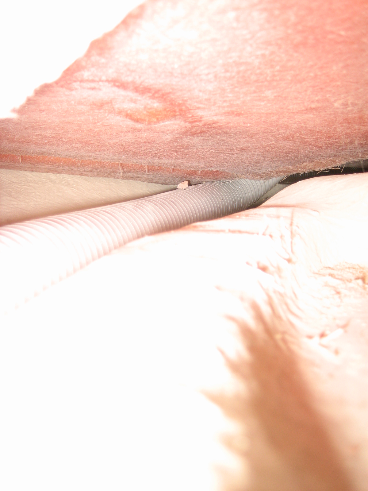

I believe at least parts of the ballast tank are separate from the cabin floor. I've attached an image that I took looking forward from one of the aft berth inspection ports under the mattress. You can see the rib along the edge of the tank in the foreground, and the head discharge hose heading back to the holding tank. The bottom of the cabin floor is the unfinished fiberglass at the top of the image. You can also see multiple layers in the construction detail of the drawing you provided.
The centerboard bracket attachment nut is welded to the underside of the bracket, so it can't spin. Did you happen to buy your boat new? Mine did not have any caulk over the bolt head from the factory, but I've seen others that have it applied in that spot presumably in an attempt to stop water ingress. Unfortunately, it's applied on the wrong side of the leak. I just tightened mine up and the leak stopped and remained so for the last 16 years of use. I did not apply caulk in case I needed to retighten. You might take it out motoring with the inspection cover open and see if there is any water appearing.

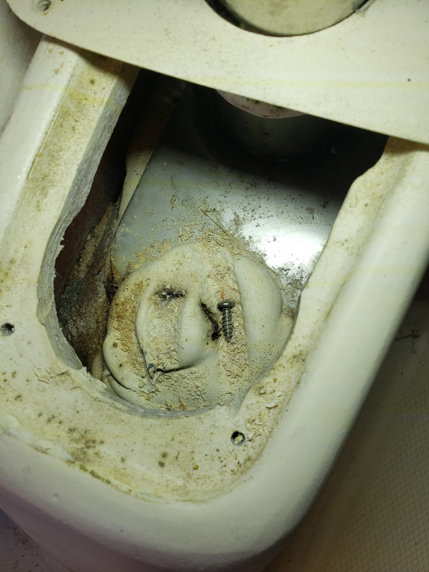

Thanks Bob. The beauty of cell phone cameras. You can get in everywhere. I've read a posting on this site from way back suggesting the same as you. We'll put the boat in next week go for a motor and watch for water coming in through the centreboard. Honestly I still believe I saw water migrating under the gel coat layer in galley cupboard floor.
The boat was 2 years old when I bought it. It had been sailed on a lake in Missouri. The small screw in the picture would lead me to believe that this was dropped at the factory and this was the first time the cover had been raised.
