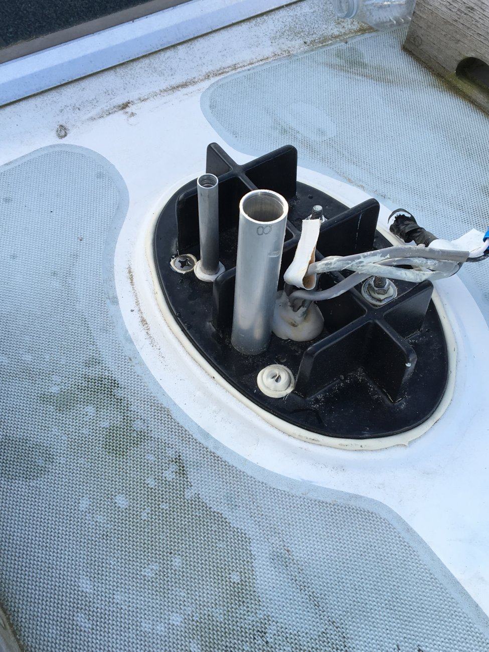

Here are two photos with out the mast in the way.
Looking at the mast base without th meats. You can see that the mast sits flush against the black cast flat metal. The weep holes are in the aluminum mast. Note the pipes. There were inserted to keep water from going down the hole for the electrical wires - VHF Radio antenna and Electric wires for lights.

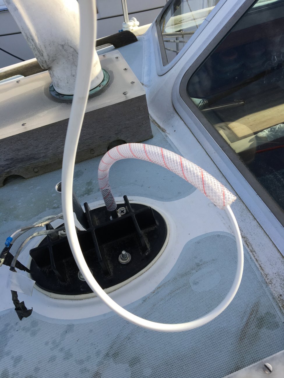

In a second image you see we added a bit of hose that curls. All this to meet the water in the mas from intruding into the cabin.

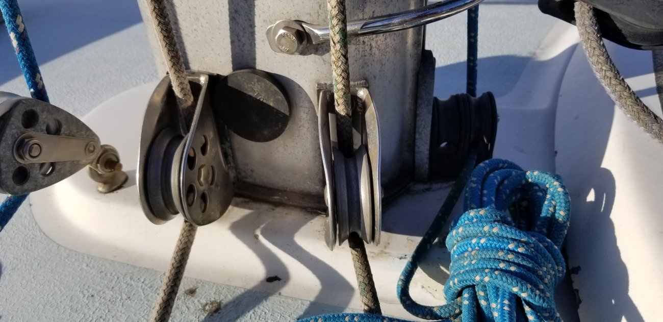

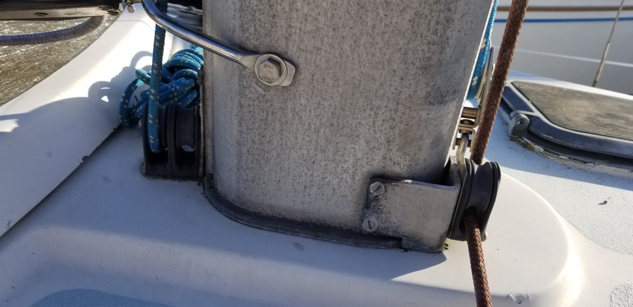

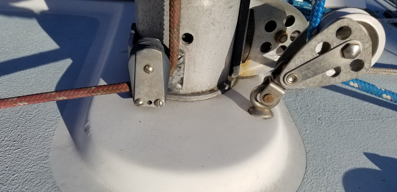

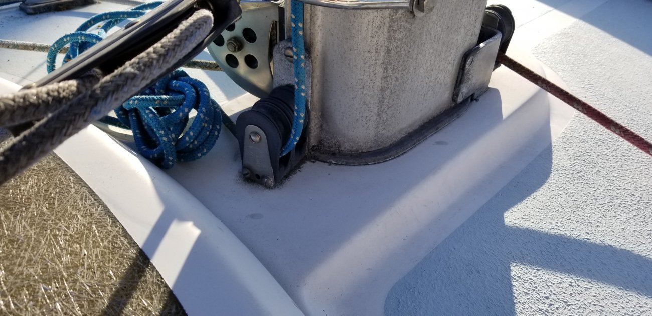

So here are some mast pics... you will see a 1/4" ish hole about 2 inches up from the base of the mast. Not sure if this is a weep hole or not, but its clear. Also you will see a larger 2" hole that originally had a very very tired rubber plug in it, looked original, but I wouldn't swear to it. I replaced it with the black one. Looks like a wire access.

JS Thanks for the cool pics... I think one of those "tubes" is loose in the mast as something bangs around in there. Sounds like a halyard slapping the mast, so thats not good, but low on the list!

Jazz. I think your big hole was for something like, electrical or antenna cable. A rubber plug is a good tool to seal it.

  4. The small tubes with hose attached are our design to keep mast water from intruding into the cabin. We bore the holes in the base too the outside diameter of the aluminum pipe. The pipe is used to pass the electrical, VHF Coax & Radar wires into the cabin. The combination of the pipes and hoses work as a drop loop to keep water from following the wires or halyards down the inside of the mast and then trying to leak into the cabin.
  5. Weep holes in the mast serve to let any water in the mast to escape and drain out on the deck.
