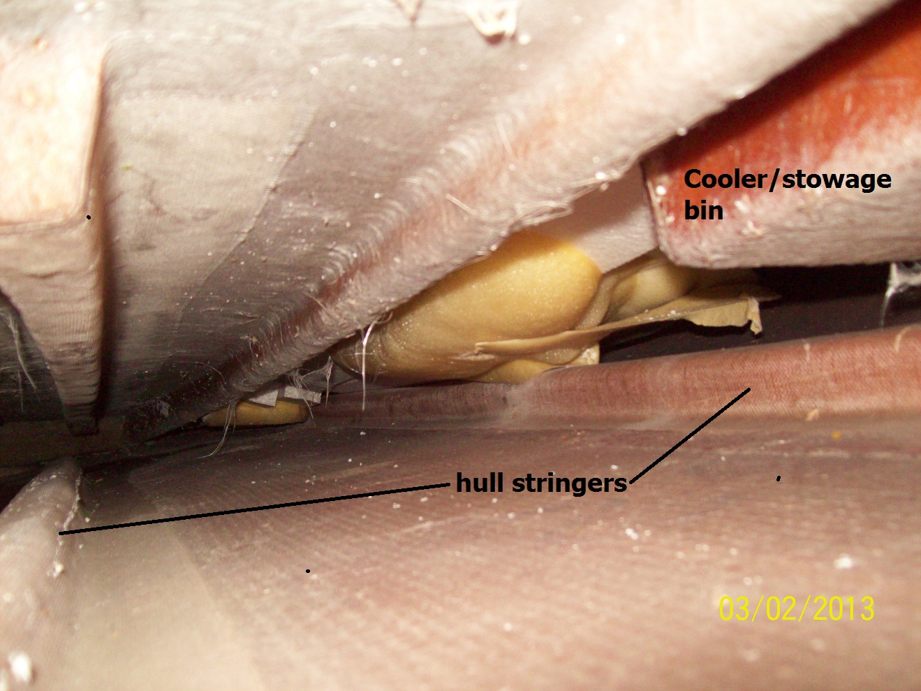

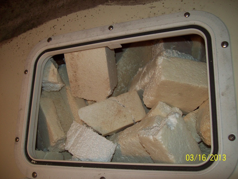

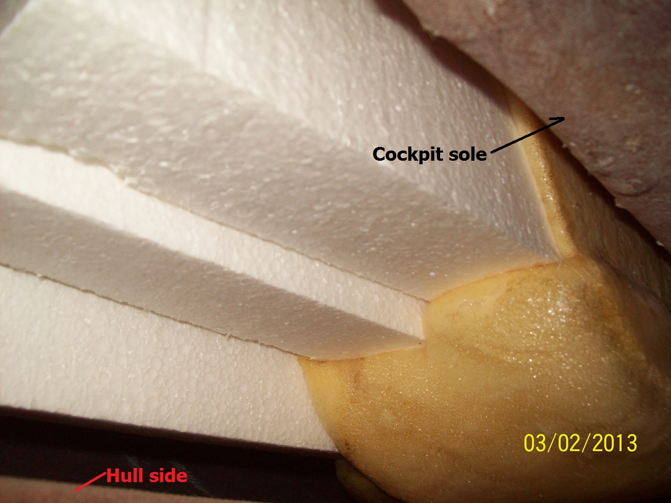

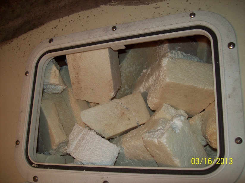

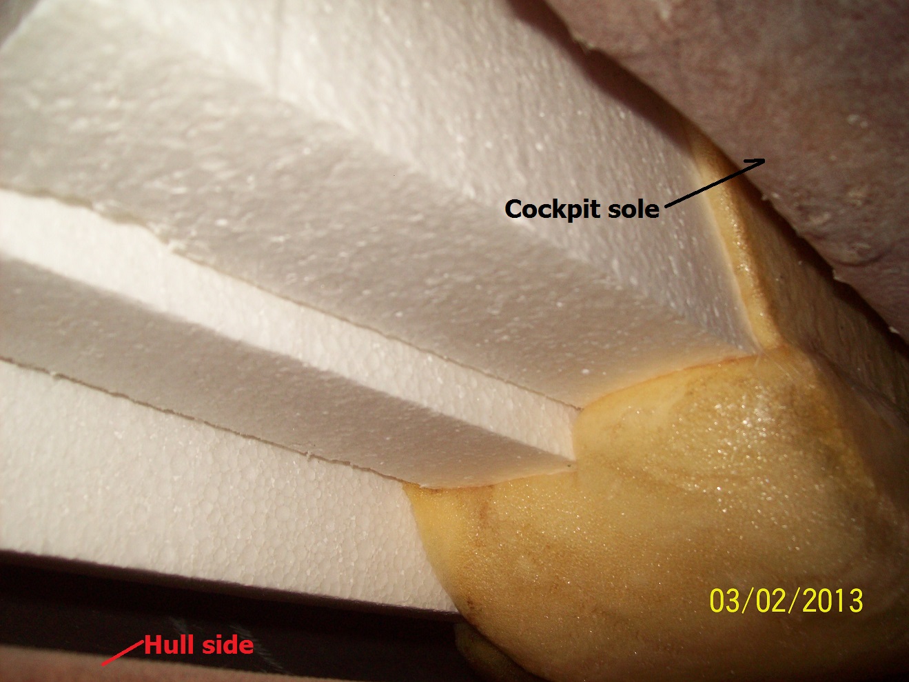

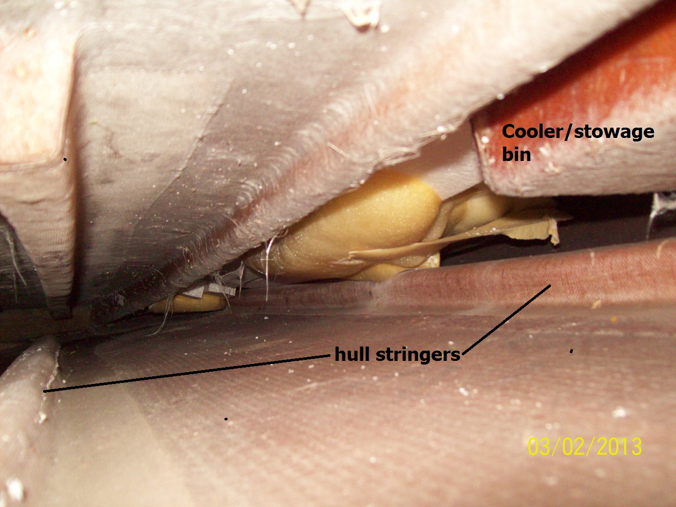

Based on my 1979 model, reaching the foam to check for wetness is near impossible unless your arms are at least triple-jointed. Most of the foam is bonded up under the seats. The area ahead of the bulkhead at the forward end of the cuddy also hides a lot of loose foam chunks and since water vapor rises, it may be damp in there. What I've found is that there are various hidden spots throughout the closed volume of the DSII that can collect water depending on how boat is positioned, then when the boat is tilted or moved, that water drains out to the visible parts of the bilge. I have found that if I have a small amount of water in the bilge, just leaving the 2 inspection ports open for a couple of hours on a sunny day will dry out that water. My boat had a pretty persistant leak the first summer (previous owner improperly repaired small crack/hole in bottom) and one time I came out after the boat had sat on the mooring all week, to find the bilge completely full (saltwater). Granted that was 20 years ago ,but I have a dry bilge now after fixing that leak. My season is in the water from Memorial Day to Columbus Day every year, stored in an unheated garage the rest of the year. I leave all inspection ports open while indoors, and also open the hatch that I added to the forward bulkhead to allow air to circulate around the foam up there. To properly fix the leak left by previous owner and to rebuild the structure under the mast step, I have a couple of access panels in the cuddy floor/deck. These I leave open while stored for Winter. Those access panels are great for access to the bilge for bailing, but not being sealed, do at times allow rain water that comes in around the mast and sometimes through the 2 drains in the aft bulkhead of the cuddy. to get into the bilge. Still, once bailed out and allowed to dry as mentioned above (a couple of hours on a sunny day, while I eat lunch ashore), my bilge is dry again. Anyway, thanks to my digital camera, here are a couple of pictures of the foam under the seats. I think I have more pics if needed. Also added a picture of foam chunks in the bow.

Thank you all for your advise. I feel more confident now that I will soon have a drier boat! I have yet to launch and sail it, so I REALLY hope it floats! :)
Great pictures, Sunbird22358. I now better understand how the flotation is on the DSII. I read on an old manual about installing an inspection port on the bow bulkhead which I have been considering. I see you installed a much bigger hatch. Are you happy with it? Thanks again!
Jun 2, 2004
1,957
Oday Day Sailer Wareham, MA
I installed that hatch for better access, previous owner had broken off the bow-eye and had installed a standard 4 inspection port for access. When I tried to get my hand in there to reach the bow-eye so I could remove it to rebed, found access a bit tight. Now, I can open that hatch and remove some foam temporarily and not only reach the nut on the bow-eye, but actually see what I'm doing! YEAH!
On another note, I think I know what O'DAY did with all the various pieces of Styrofoam packing that various parts and accessories were shipped in! They used it for flotation!
