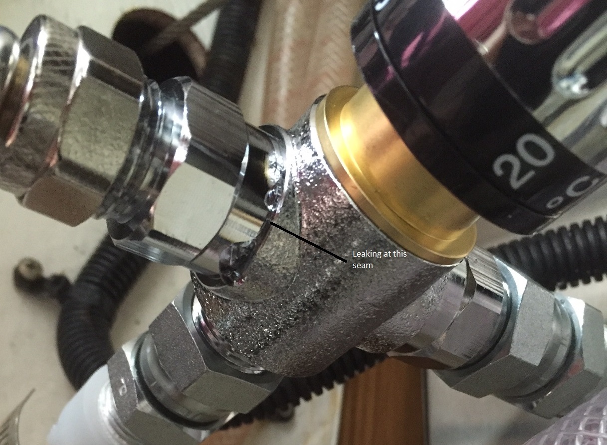

Installed it today. My local hose shop had the 1/2" straight female to 1/2" male tapered pipe fittings. They weren't sure that the seal would work with the filter in the valve, but it held fine. Unfortunately the valve body itself is leaking!! Luckily it will be easy to replace. Will take some more pictures when I do that.

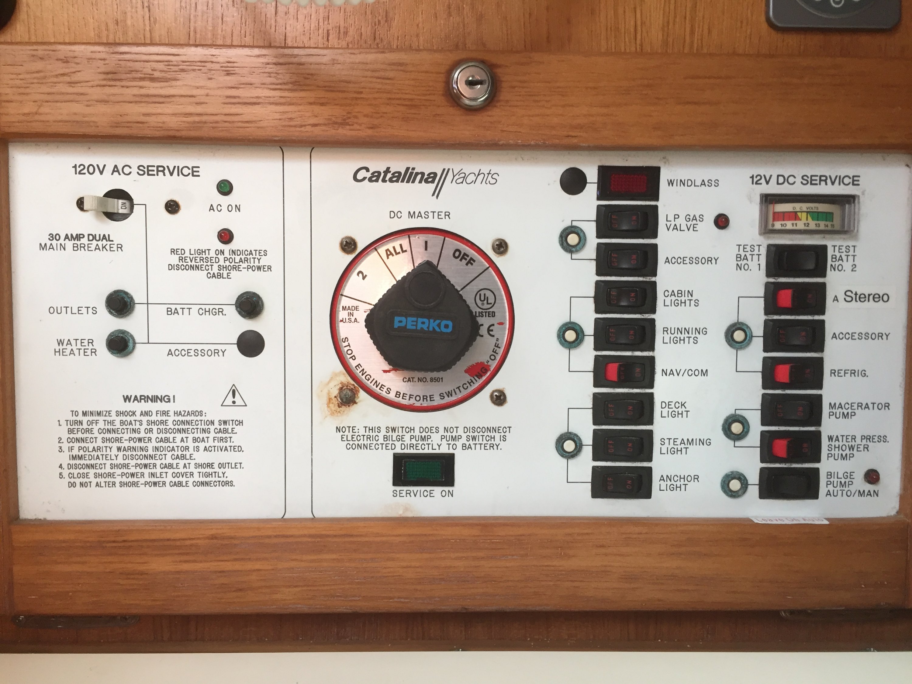

No picture. I've got a similar 30A master breaker, but the individual breakers can only be reset when they trip; no on/off function. On the DC side it uses the same breakers, but with switches on the side.
Rob, sorry to hear about the leak. Are you sure it's the body and not the connector?
A picture of your panel would help me understand, 'cuz I'm just an old curmudgeon who thinks the push-button IS a shut off, since that's what I have. Darn these old geezers. :deadhorse::(:poke:

If you look real close at the picture I included you can see it seeping where the fitting fits into the valve body. I was quite surprised it would leak there. I figured one of my connections would be bad. I promise I'll take a picture of the panel.

Finally remembered to take a picture of the panel. You can see the main 30A AC breaker switch and the individual AC breakers, with no switch. On the DC side the breakers are similar (white instead of black), but there are rocker switches. Pushing the breaker buttons does nothing. Maybe they are all broken, but I think they were designed that way.
Also, none of the indicator lights work any more, nor does the battery test meter.

This must be a Catalina thing. My 1994 C270 has very similar arrangement. You can push the breaker in (if it trips), but you cannot use it to disconnect.

Too bad about that leak. I think that part unscrews (or maybe screws in a little tighter). You might try and see if there is an o-ring in there. It might be how the filter screen is serviced.

The vendor sent me a new one, so I'm just going to swap it out. Luckily the connections are such that it will be easy to do that. The filter screen on my unit has a little circlip holding it in, accessible from the outside.
Most push button breakers can be pulled to disable the circuit. Is this not the case with yours?
