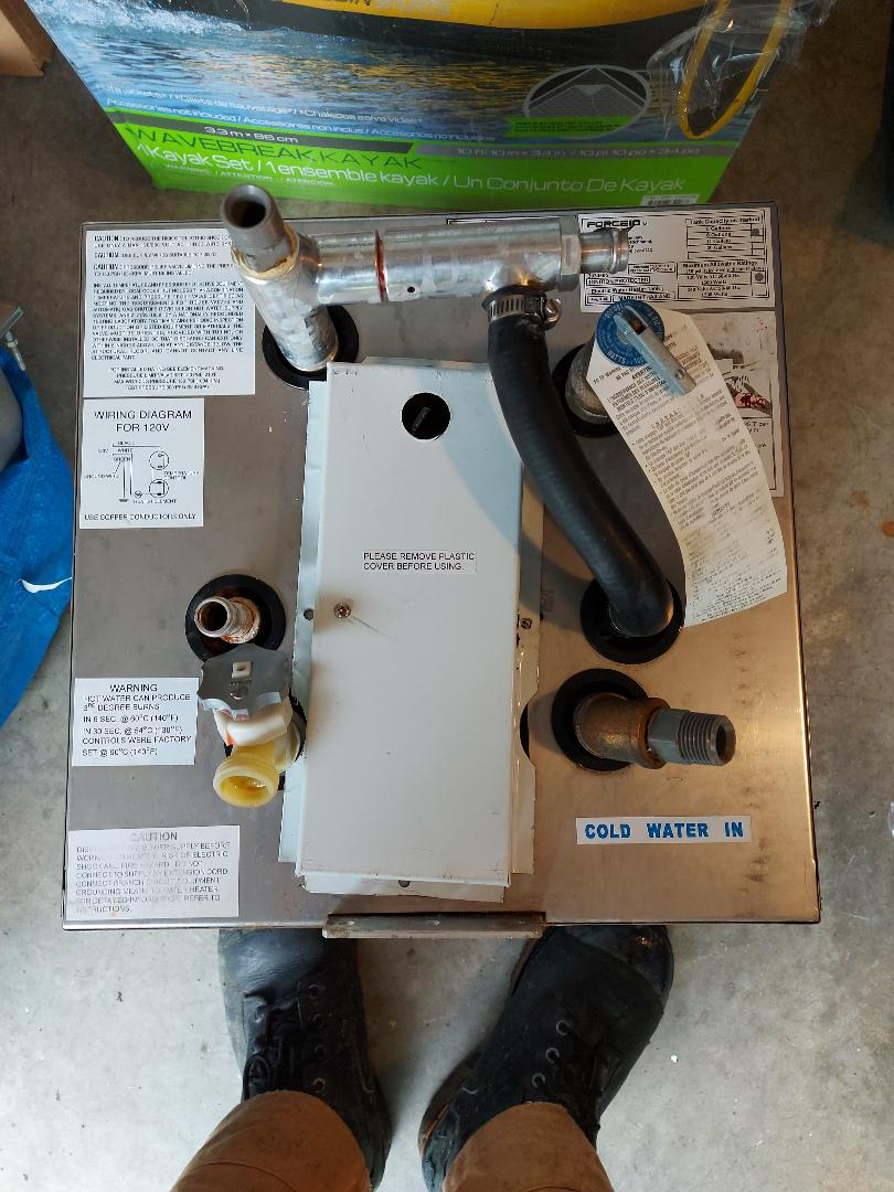

While you're at it, if you can get a few pictures of the inlet and outlet connections on the tank, that will tell if there is any type of thermostatic device on there.

Hi all - found this image in an older forum - this is what is on mine - should I also start by replacing this mixing valve ? I understand they are no longer available. Anyone have a recommendation for a replacement model (that woudl be relatively easy to install ?
Jan 4, 2006
7,870
In my opinion, they are a complete waste of money. If you have one, remove it and install your hot and cold connections without one.
Your tank has the ability to produce water at temperatures up to 180° from the engine but rarely is that temperature available once a little cold water enters the tank. If one is so helpless as to not be able to control the temperature of the hot water outlet, being out on the water is the LAST place they should be.
